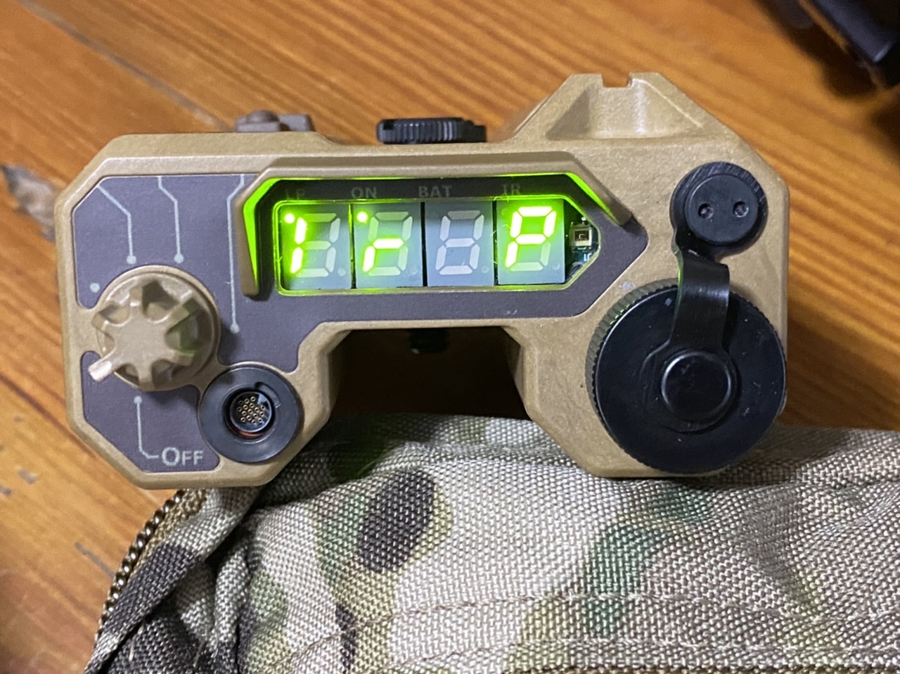

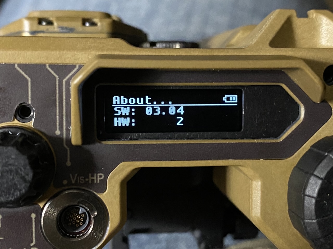

    My 09/2020 unit:

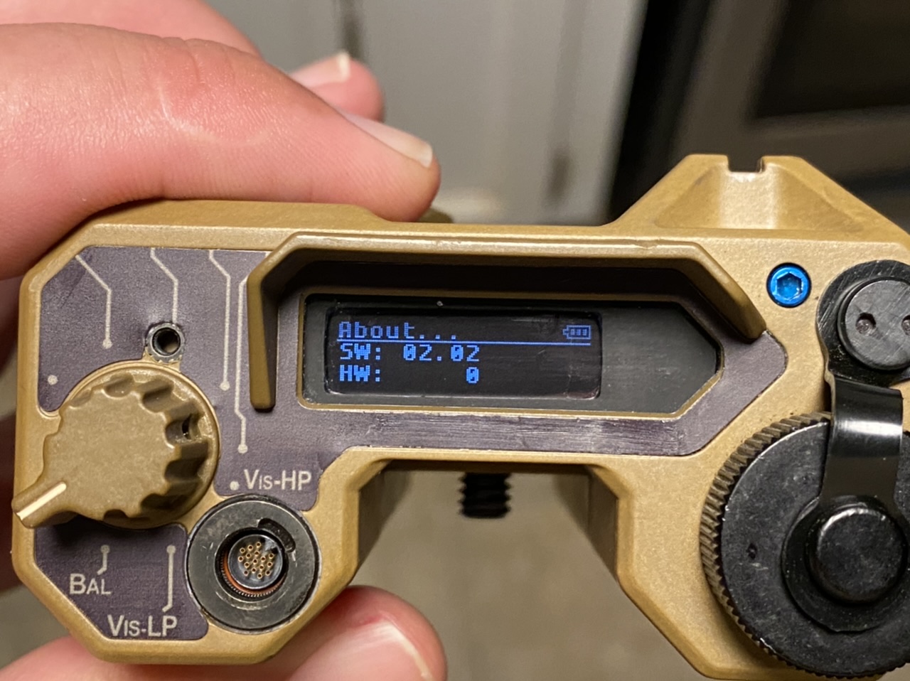

    My 11/2016 unit:
    One of my unlocked GB ES units:
