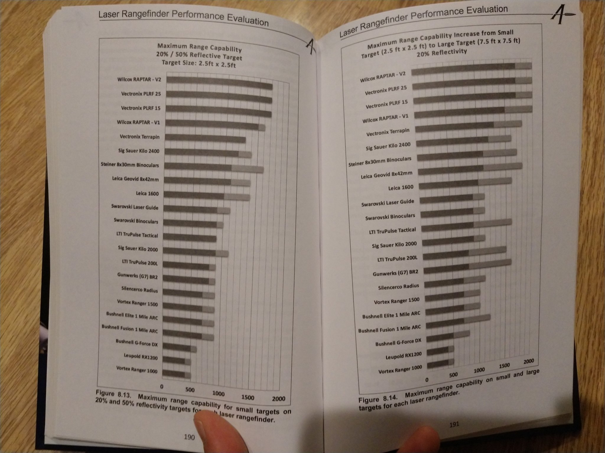

    Pic from Litz's book on where the V1 and V2 Wilcox stack up against others. Good LRF
