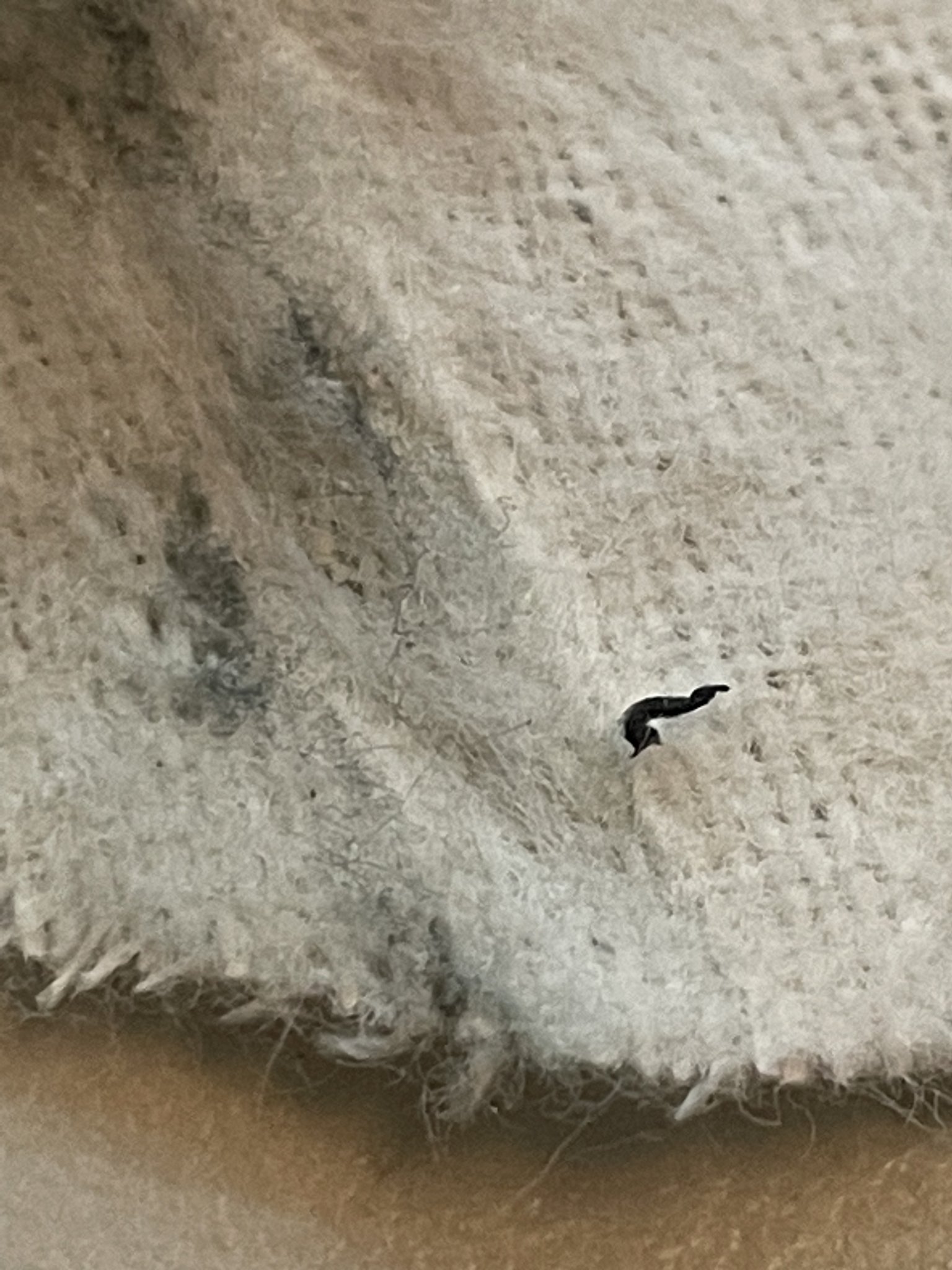

So I purchased a used gun from an old retired Border patrol agents estate. REM 700, 6mm Remington. I was able to purchase quite a bit of his reloaded ammunition and have ran across a few issues, but the main thing is the gun was filthy when I got it. I’ve run wipe out with the Excelerator through it four or five times and I’m finally getting non-purple patches out of it. Onto the next thing I am including a picture of a patch that has a little piece of black on it and I get a lot of these out of it. I’m wondering if that might be Molly because some of his reloads were Molly coded bullets. When the gun is “clean” and I use that term loosely, it shoots groups like this. After about 7 to 8 rounds, it starts doing shotgun patterns, like 3 inch groups!

The black thing could be something as simple as a piece from a coated cleaning rod . Regardless of what it is, sounds like you need to see what that bore looks like .

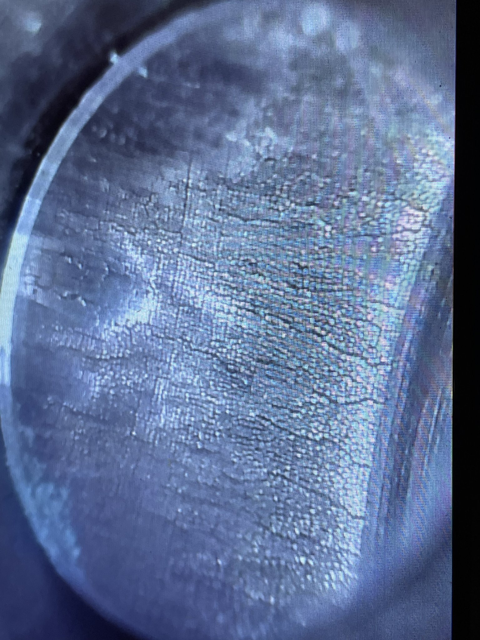

OK so now I have cleaned it very good and it will shoot the first 3-4 shots VERY well. Were talking 1/4" groups at 100 yds. ( I did this 3 times over 4 days) Then it starts slinging 3"+ groups. Dosent matter what bullet weight or powder. So then I borrowed a Teslong Borscope and it looks horrible for 18" of the 20" bbl. after I cleaned it again. It Looks like its fire cracked and the Throat is AWFUL! Is all the Cracked looking area possibly Molly coating? I have never see fire cracking the entire length of a barrel. First pic is the throat. 2nd is basically the rest of the bbl. Looks the same all the way until the last inch or so.

Hell I’m done shooting it. I agree with that. Question is is that barrel shot out with heat cracks or is the some moly from bullets. I got a lot of loaded ammo from the guys estate that had moly coated bullets. I heard that stuff is impossible to get out of a barrel.
you have a hunting rifle and your results for first few shots seem ok for that purpose. The fact that it opens up after that is more about poor bedding and internal barrel stress. the fire cracking is normal for an aged barrel, especially a barrel burner like the 6mm rem.

I never heard that the 6mm rem was a barrel burner. We’re not talking about a 220 swift or a 20 22-250 something notoriously hard on barrels I’ve got a model 600, 6mm that I’ve had since I was a kid (50 years ago) probably got 1000 rounds down the barrel and the barrel looks fine. Shoots penny size groups at 100yds with handloads.
I guess it depends on your perspective. The 6mm rem is a beefed up 243 win. It can push a 55gr bullet over 4000 fps at the muzzle.
