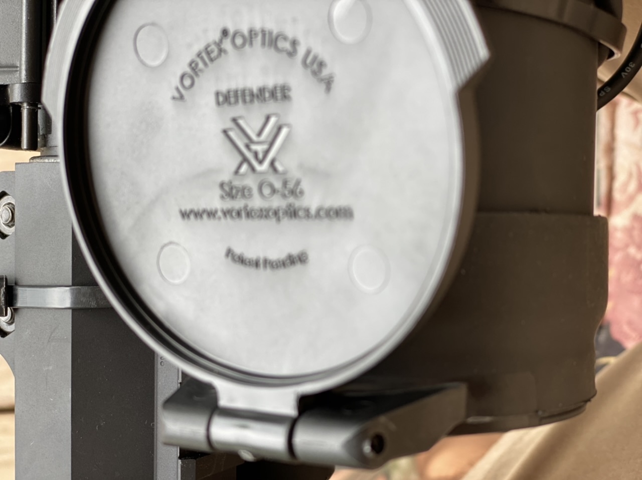

As Plinkit mentioned, the Vortex Defender O-56 works GREAT on the front maw of the Halo-LR. It takes a little effort to stretch it over the rubberized cover, but once it’s on, it’s on!
O-32 on the back, O-56 on the front. Problem solved!
I love it!
Reactions: PowPowHawg

@horta glad it worked for ya
I'll tell ya a trick I realized help a little... Roll the rubber completely back onto the cap as if you are trying to roll it over the cover. Then hold it up to the Halo and once you start unrolling it'll pretty much attach itself with a slight pull to fully seat it
Reactions: TheHorta
