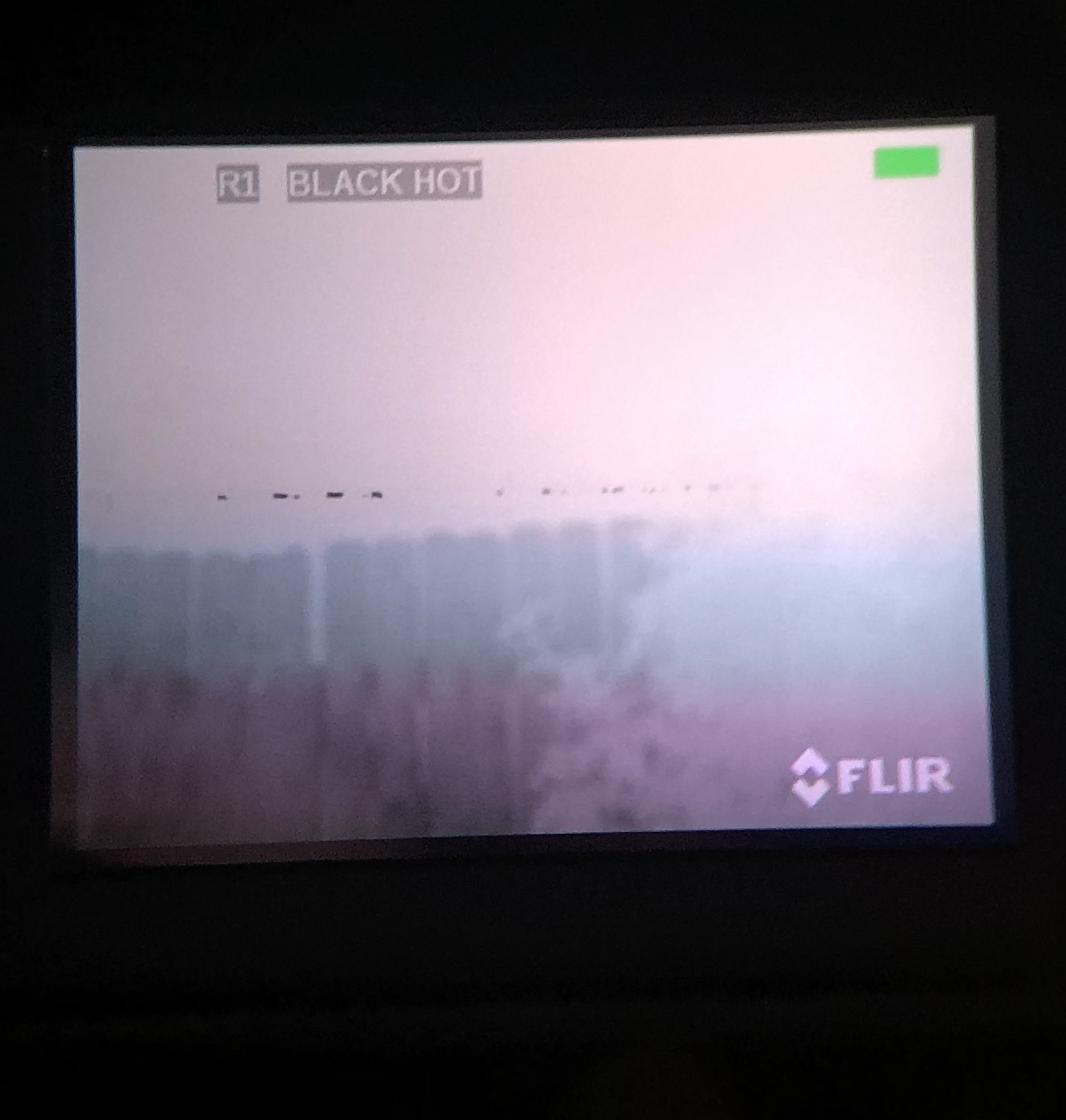

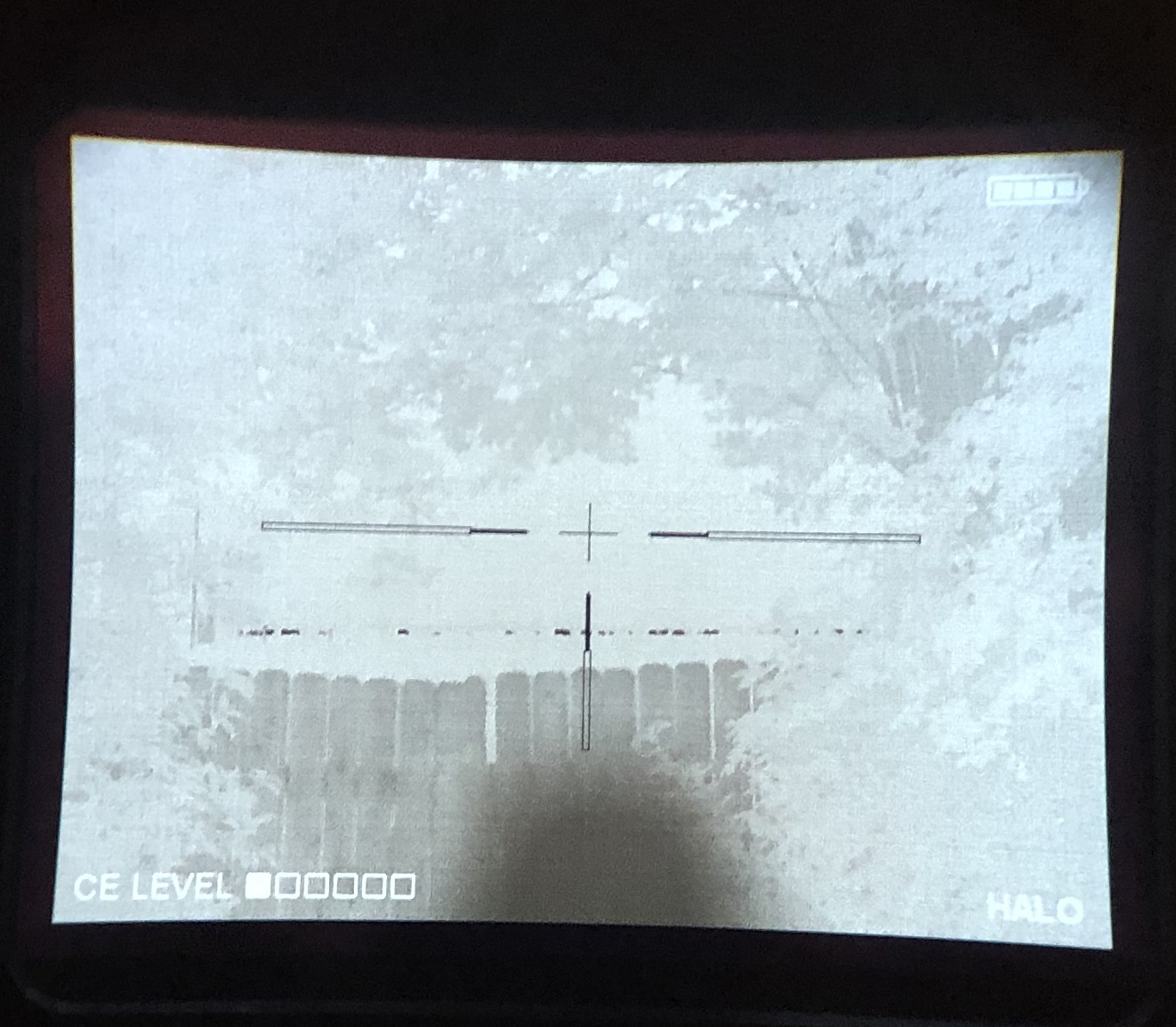

Cows are at around 950. 71° 93% humidity and light rain.
Zeus 640 2-16x50 30hz
Halo 25
Juice is worth the squeeze. Seeing the cows to the right that are partially blocked by bushes is a good example of the difference in the two.
Reactions: ccasanova

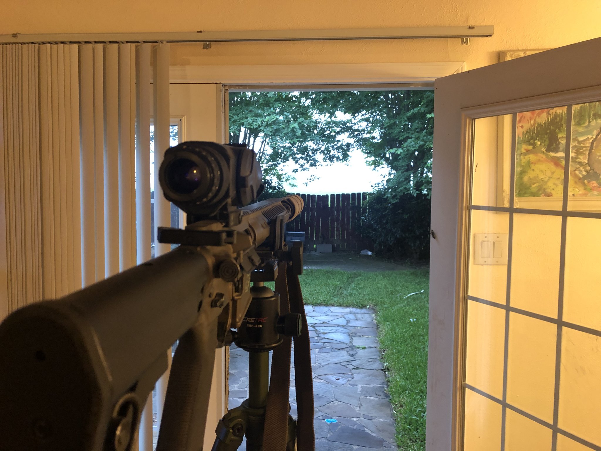

I’m skimming through the Halo owners manual and reading threads now.
Does it come with the quick detach mount?
Do y’all remove it and run it like a scanner, then reattach to shoot?
Mine is new and I am still learning it but I did use it as a scanner last night with plans to reattach and shoot....but no critters showed up. Works excellent as a scanner. I have a paracord neckband with a short picatinney rail attached so I can lock the ADM QD mount to it and let it hang from my neck. I also put a set of Magpul rail covers right in front of the the attachment spot on the rifle to help me get it attached in the same spot on my rifle in the dark. Same location attachment to the rail is required to get the best return to zero results. Since initial site in I have not checked the zero yet to see if I have any creep.
