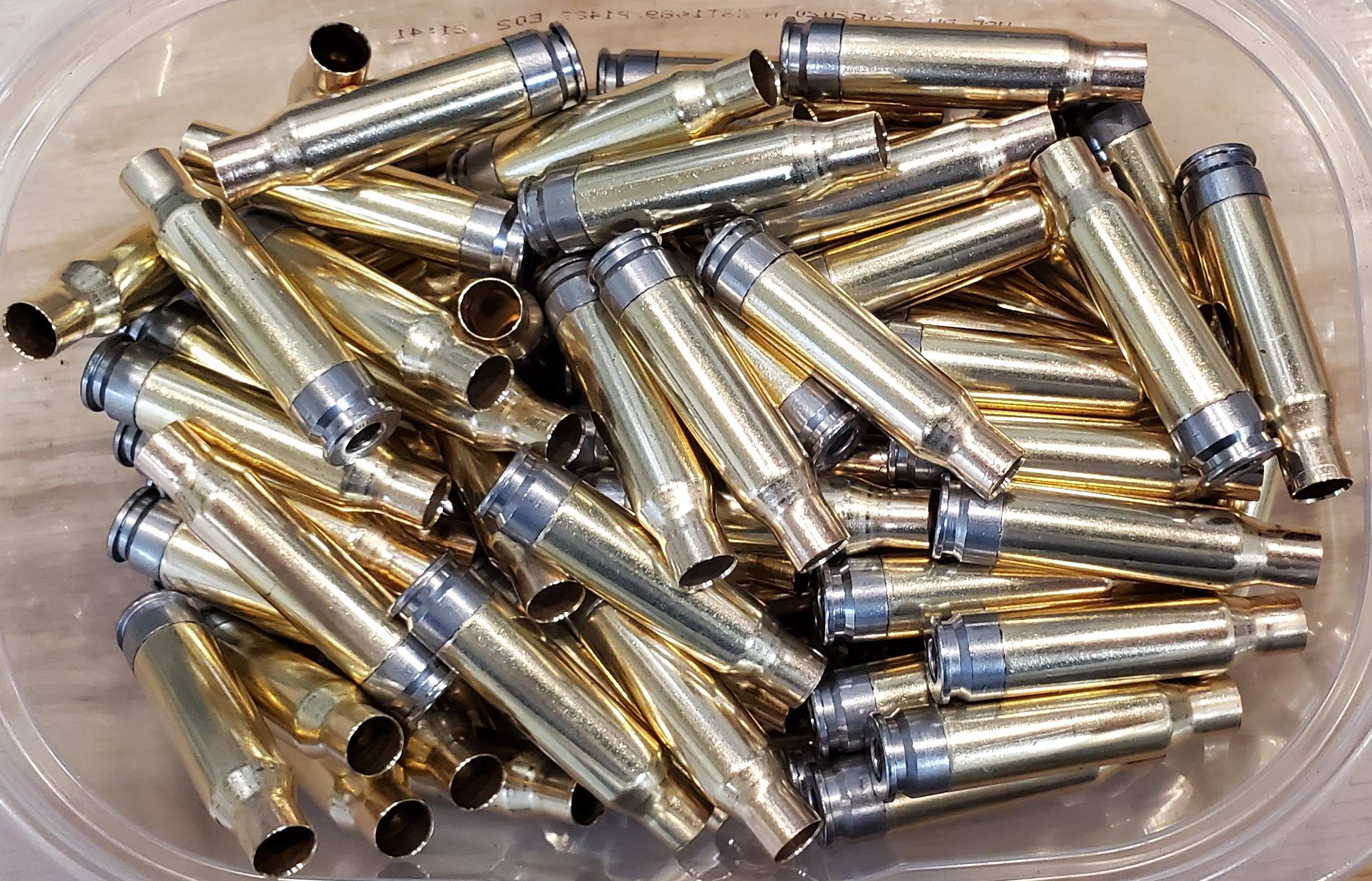

I received a batch of the Shellshock 308 Win casings. The company has zero communication skills. I left several messages via email/phone and received no responses. I also received zero shipping info but the brass did arrive after 6 days so not bad but the lack of communication annoyed me.
The brass itself looks terrible. Its filthy unlike the photos they provide on their website where it all looks new. What I received looks like 5 week old nickel range brass. Pretty ugly.
I threw some of it in the stainless media to clean it up. We will see how it turns out. The annealing marks are almost 3/4 of the way down the case length....kinda weird. The 300blk casing I bought previously looked MUCH better.
My only guess is that they coat them in some kinda of oil during packaging. The bag is covered in it.

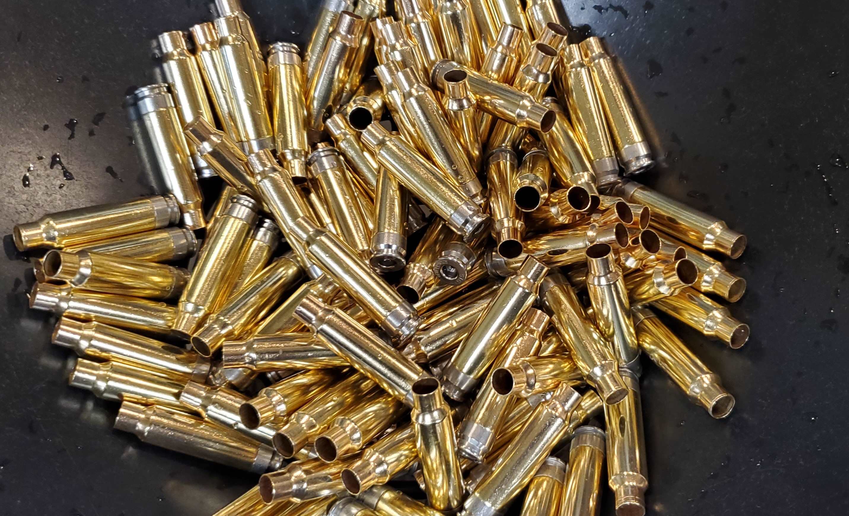

Similarly, my Sig 277 Hybrid case's volumes measured at 57 grs H2O. I'd received 4 different case headstamps of them and each was a little different. After necking them up from .277 to .308 and firing them, two of the headstamps measured at 57.7, which interestingly is exactly what my Winchester .308 brass measured.
You're idea of trying your normal load first is a good one, if nothing more than to get some fire formed and then get a measurement of their case volumes. Then you can test some different loads, which is what I did, starting with normal loads and working up with different powders for more velocity . . . assuming that's what you got these cases for.
I worked up a load max pressure (that being at 80k psi, much higher than I intend to use normally) using 46.5 grs H-4895 pushing 177 SMK's with a COAL of 2.977" to 2,900 fps. . .something I would not recommend anyone doing unless they really know what they're doing. Modern day actions and barrels can handle that pressure, but it still hard on them. I intend to keep pressure somewhere between 70k and 75k psi with these cases. I've not had any extraction or ejection issues with these cases so far.
I've very curious as to how these case's of your compare. :rolleyes: :unsure:

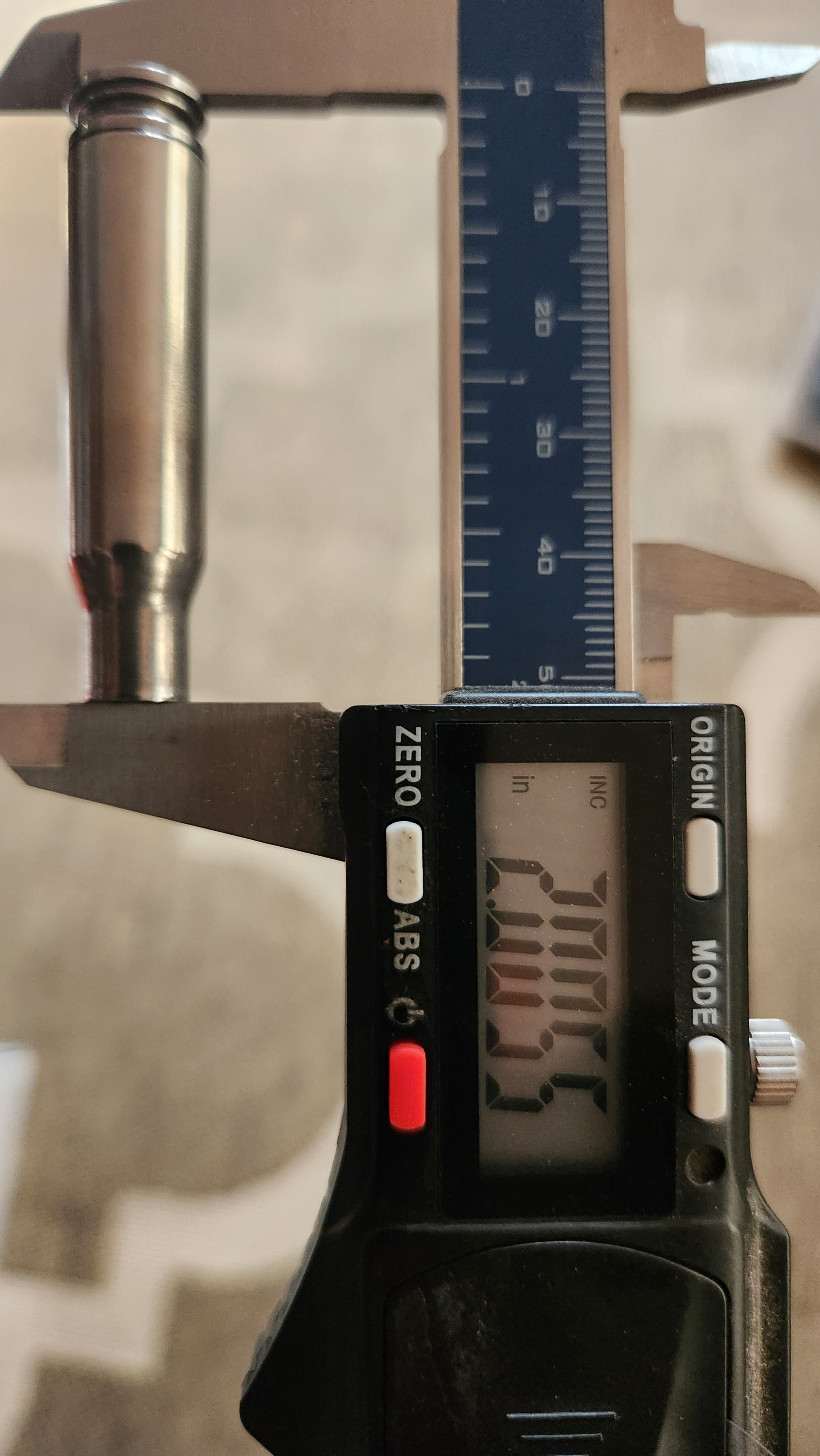

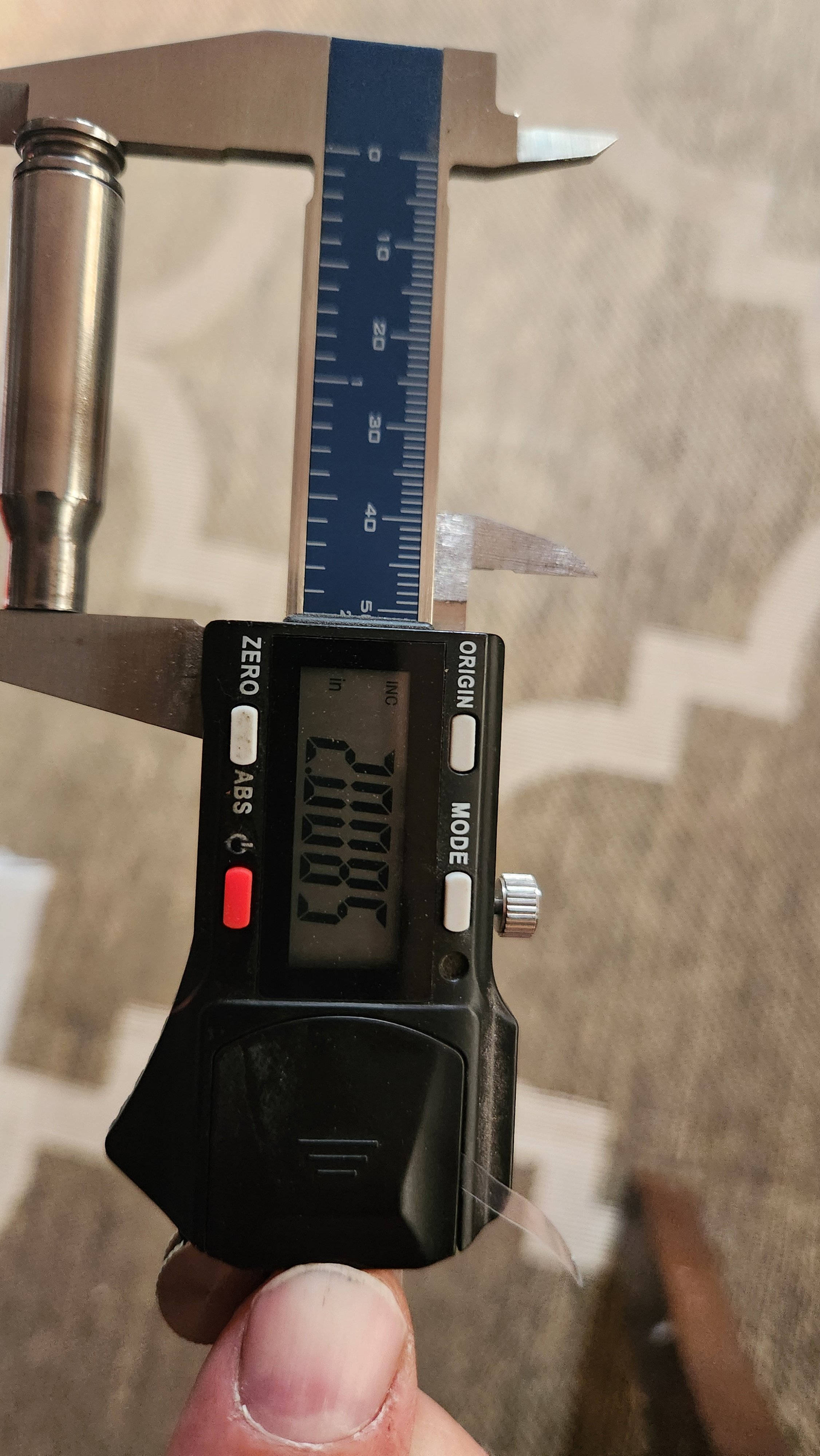

#1- 46.2 grains (cold bore)
2688/2713/2722
size after 2.0155/2.0190/2.0190
#2- 46.4 grains
2738/2729/2743
size after 2.0180/2.0195/2.0185
#3-46.6 grains
2763/2758/2747
after 2.0178/2.0130/2.0195
#4-46.8 grains
2738/2737/2740
2.0180/2.0135/2.0185
#5-47 grains
2756/2745/2764
after 2.0130/2.0135/2.0185

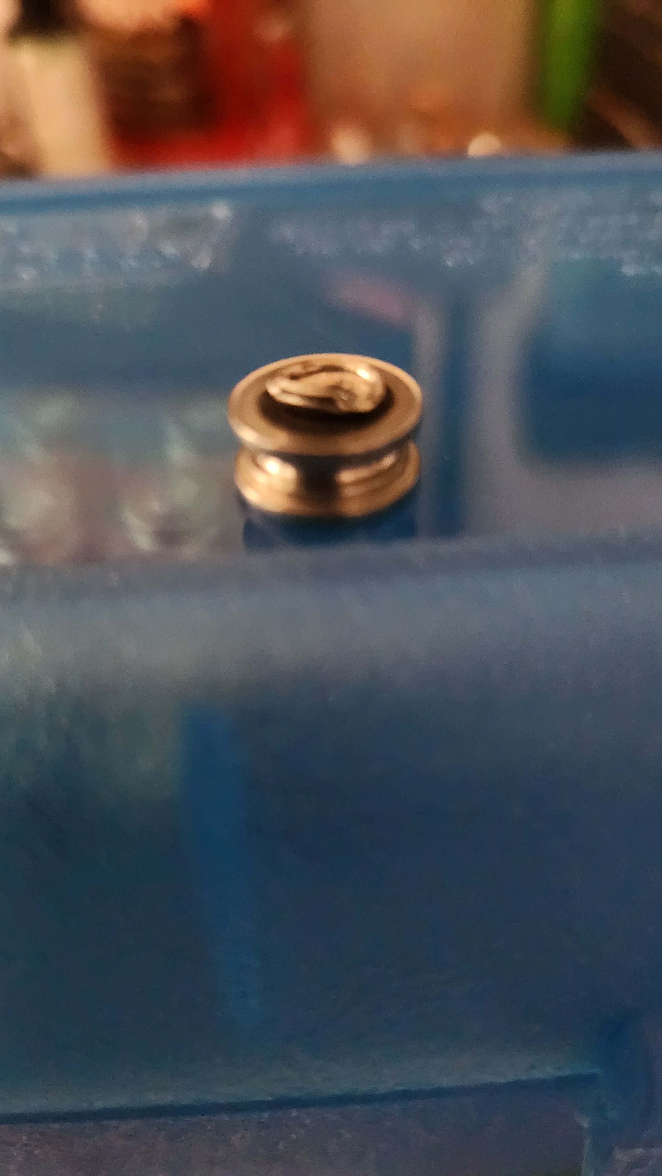

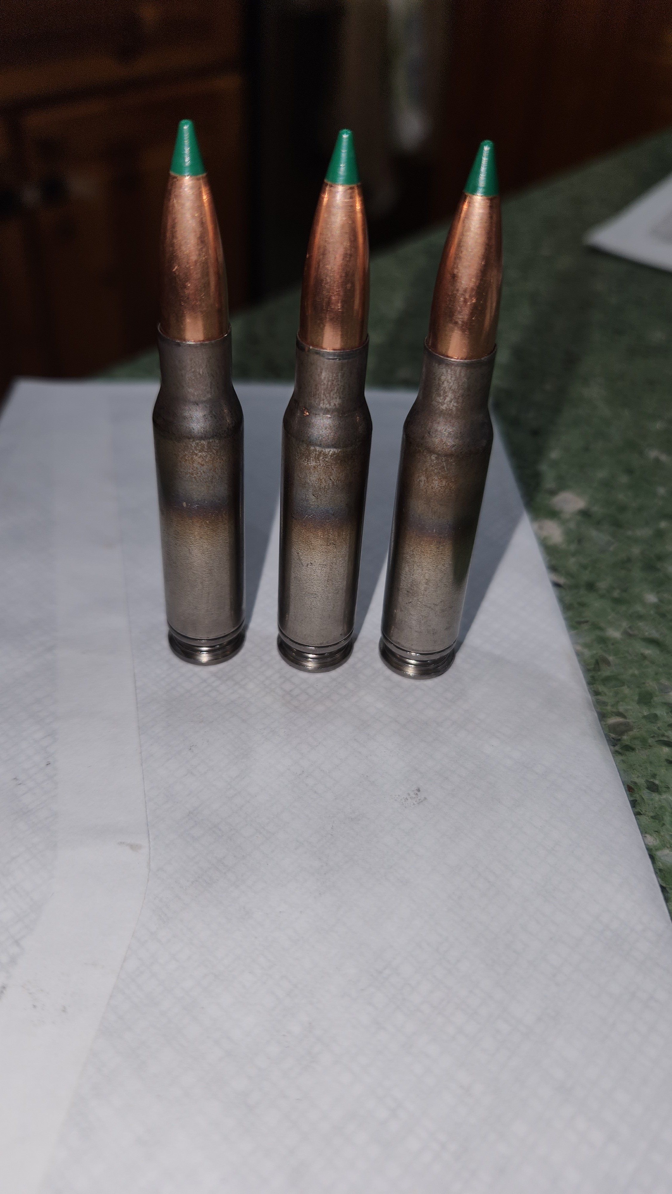

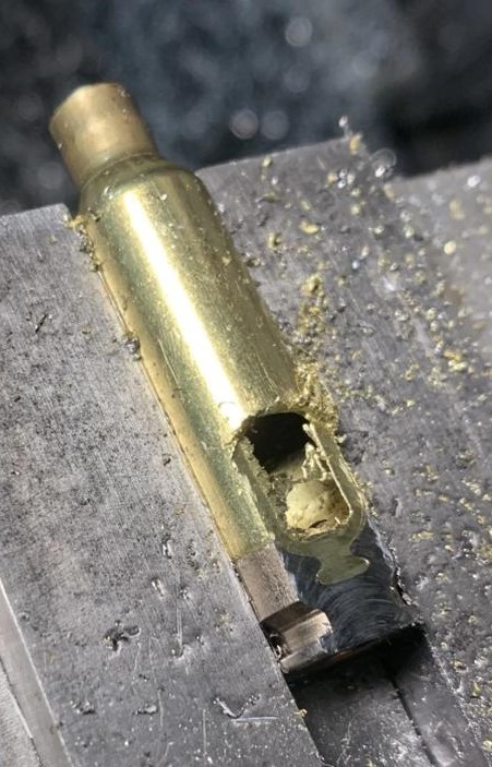

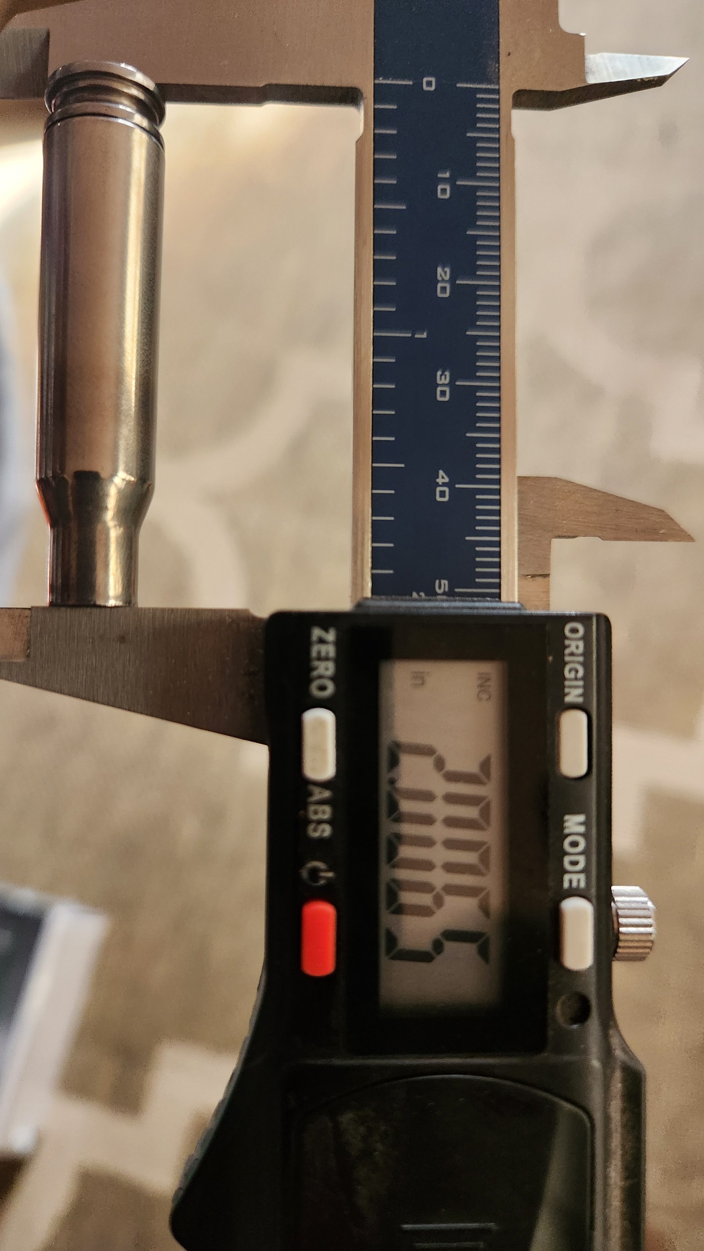

The casings are absolutely NOT re-sizeable. I tried to neck size 1 and the base tore off leaving the broken case stuck inside my die. It was well lubed.
For non-reloaders these are pretty nice but for me its a NO. My Alpha brass works just as well and some have 15 firings on them.

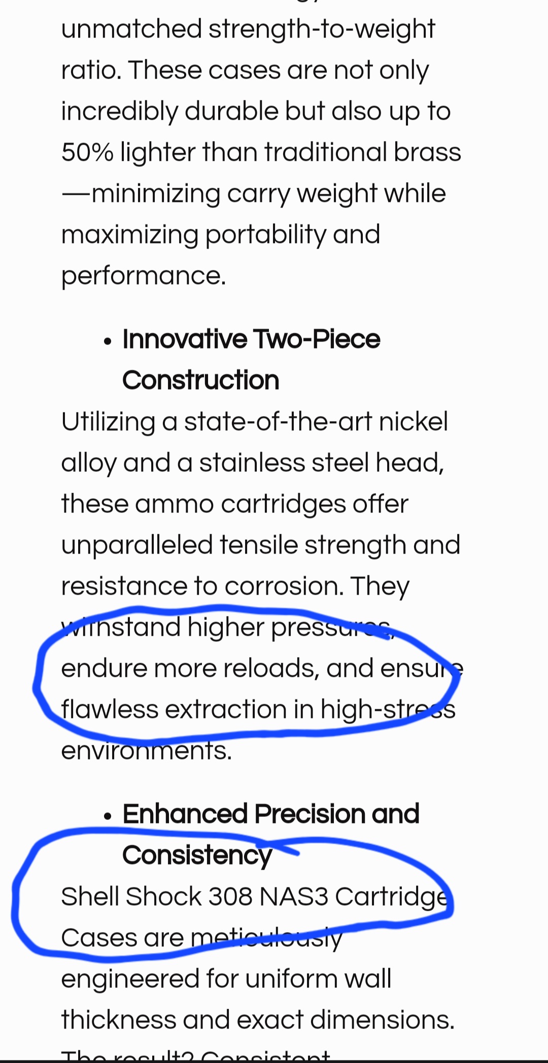

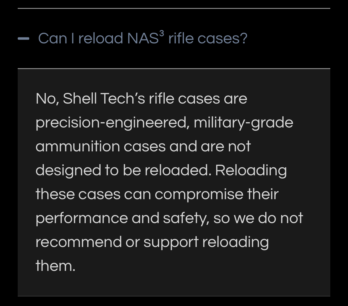

What I don't understand is one of the answers in generally asked questions.
Can I reload NAS³ rifle cases?
No, Shell Tech’s rifle cases are precision-engineered, military-grade ammunition cases and are not designed to be reloaded. Reloading these cases can compromise their performance and safety, so we do not recommend or support reloading them.
What makes the pistol cases reloadable (with their die), but NOT their rifle cases?
The about of case taper with body-shoulder-neck transitions and overall amount of material/friction.
The pistol case is just a smooth single angle with no transition.
Similar to how you have to lube rifle cases but pistol cases can be done dry.

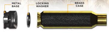

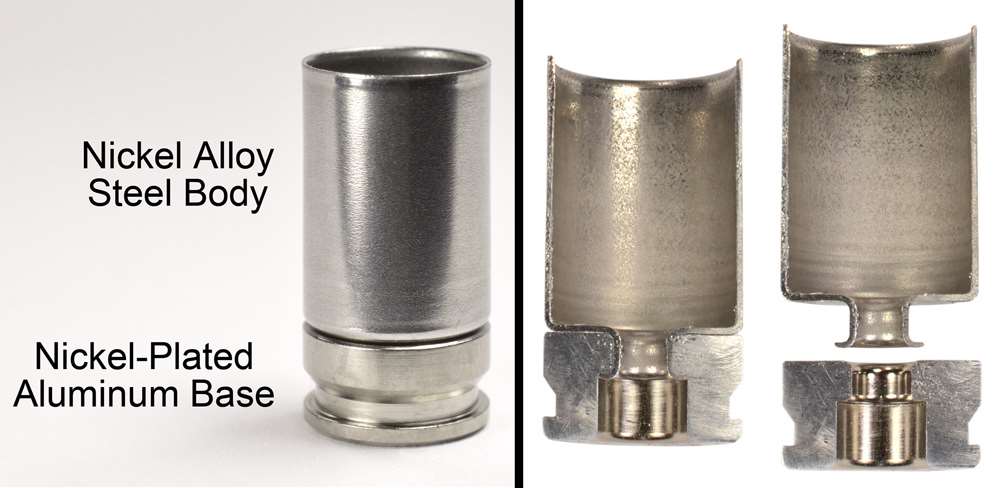

Not reloadable might have something to do with their "wave" design for the bottle neck cases that's reported designed this way to reduce bolt thrust. That wave design is not on pistol cases. Once its fired that "wave" design on top of the web is flattened. Reload them, and you don't have the reduced bolt thrust. And I think another issue is, one needs a rather tight chamber so the case isn't expanded so much making is too hard to size the case back to spec. The case walls are thinner and more uniform, providing more case volume, but tougher.
I'm not sure I like the design for reloading rifle cartridges. . . unless you have their specific reloading dies. 🤷‍♂️
Thinking of how these cases work just by observing the way they are built - all the headspace will come from stretching at the connection to the case head, not stretch in the body and shoulder as we are accustomed to with brass cases. Even a die similar to their pistol die would most likely tear the case head from the body it looks like, making reloading very counterproductive.
If you wanted to do something similar to what Federal is doing with their Backcountry line of cartridges, this stuff could fill that niche.
Hopefully someone comes up with a solution for reloading that doesn’t destroy the cases.

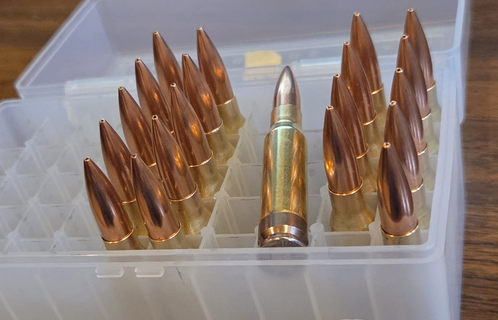

These seem to do pretty well:
Reactions: aam and wvfarrier

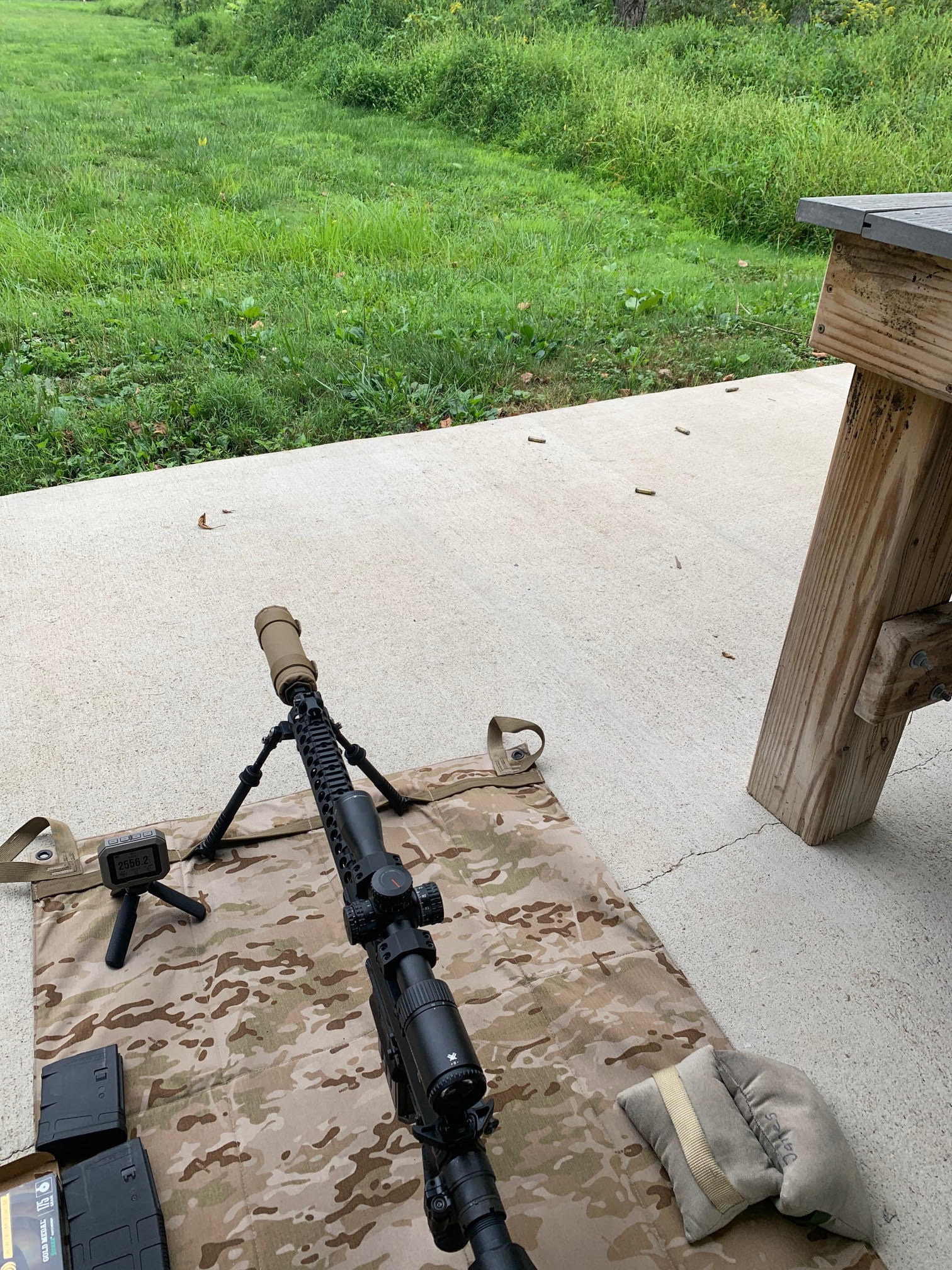

Gun is 16" 308Win 8 twist mid gas, with Law folder, Suppressed KRG R30T, & Larue mags. Vortex viper pst2 2-10
Baseline for clean bore shots FGMM 175's x 3 = 2389fps
Powder for all loads is PP2000, primers cci#34, & all loads seated to 2.860"
169smk
Sig Hyb...............................Nas3
48.9 x 5 = 2567 SD 6.7/ x 5 = 2536 SD 7.5
49.3 x 5 = 2592 SD 4.1/ x 5 = 2563 SD 5.0
49.7 x 5 = 2623 SD 3.2/ x 5 = 2577 SD 5.1
50.1 x 1 = 2639 / x 1 = 2589
177smk @ 2.860"
48.1 x 5 = 2528 SD 3.2/ x 5 = 2482 SD 3.5
48.5 x 5 = 2544 SD 3.8/ x 5 = 2506 SD 5.8
48.9 x 5 = 2574 SD 2.8/ x 5 = 2527 SD 5.9
49.3 x 1 = 2592 / x 1 = 2545
Case dimensions after firing.
Sig Hyb @.200 line = .4735", case length = 2.020", & H2o = 58.58gr
Nas3 @.200 line = .4753", case length = 2.0215", & H2o = 60.68gr
All shot @100y bi-pod/bag prone.
Guns favorite load was in Sig Hyb with 177smk
Interesting though that when the Nas3 hit that same speed it also shot a .800" group.
For 308 bolt gun I only loaded Nas3 cases.
ARC CDG with 26" 10 twist PVA barrel & first shots with Diligent Defense Enticer Sti. Jury still out on the can, always shot this braked.
174 ELDM - VT @2.950
PP2000, Rem 9-1/2 mag
48.2 x 5 = 2780 SD 7.6
48.6 x 5 = 2813 SD 9.9
49.0 x 5 = 2845 SD 5.1
Berger 200.2x @2.960
Vit N550, Rem 9-1/2 mag
46.8 x 5 = 2636 SD 2.9
47.2 x 5 = 2667 SD 15.3
47.6 x 5 = 2689 SD 10
Nothing great in the accuracy dept. First time with Can, powder, case, & primer in the bolt gun. 174's were all about 1" & 200.2's were 1.2-1.8" No primer craters or heavy bolt with any of these.
