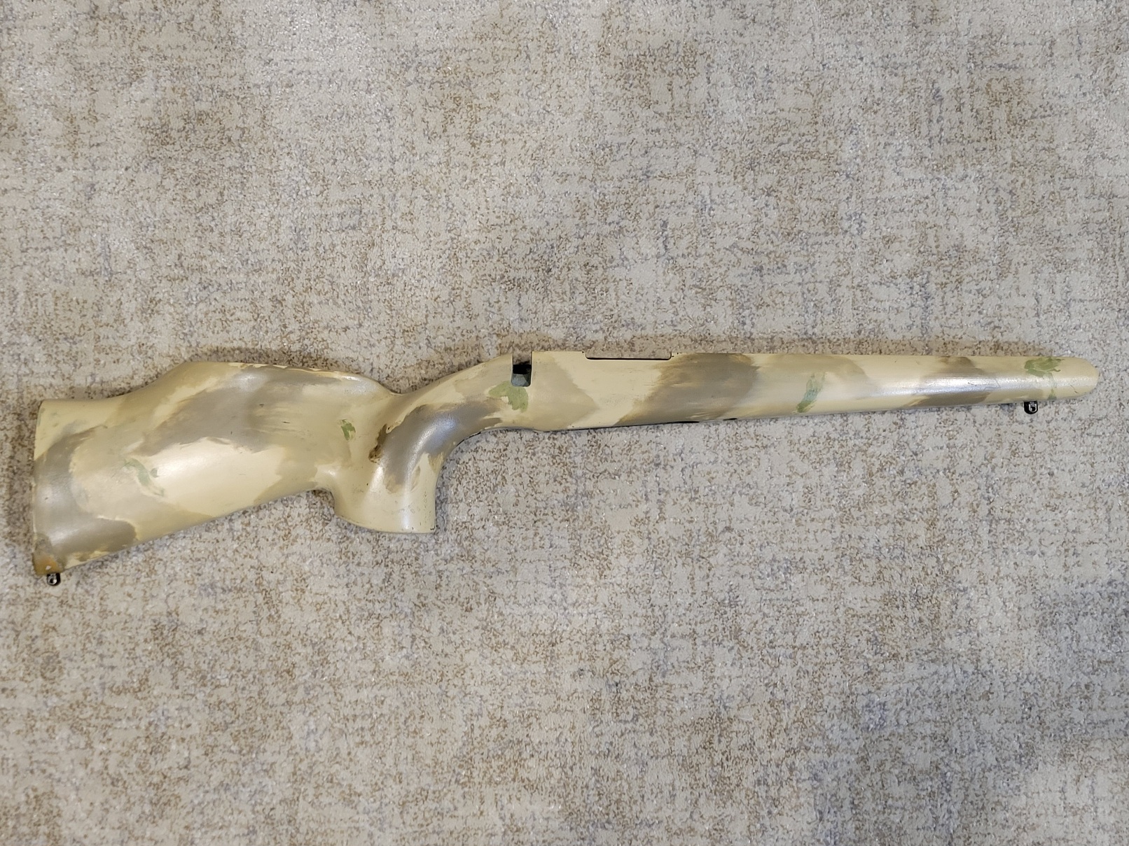

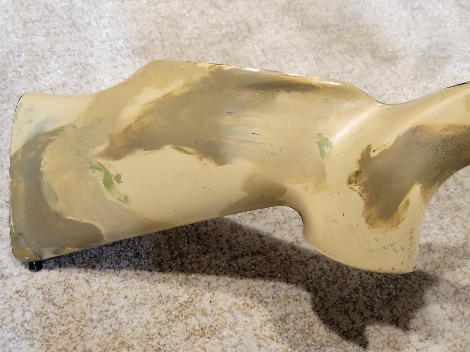

And of course this all centers around what is usually my favorite part of a build, the McMillan stock. Below is a mostly exact same stock as used on the M83, with the exception of a different butt pad (but that can be easily fixed).
The M83 is sort of a unicorn rifle and this thread has the only clone I have seen of this rifle. 0812 guns, thanks for the pics. Do we know what barrel Crane used 40 years ago re the M83? I might guess Hart Barrels, but that is pure speculation.
Reactions: kft101

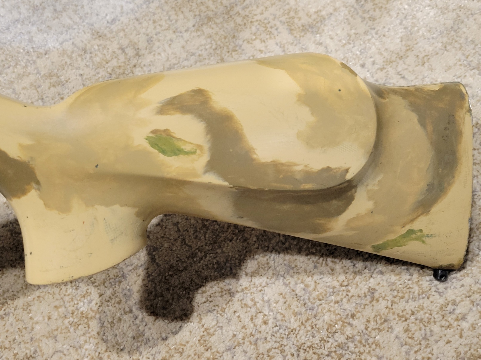

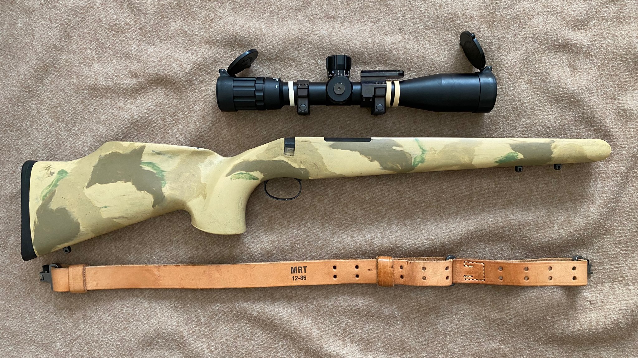

I have an original Navy SEAL used M83 stock. This one is the desert smear pattern, but they also used green smear stocks. With this original M83 stock, I also have an M83 scope base, and an M83 logbook. The M83 scope base is with @LRI right now, Chad might do a small limited edition run of these bases whenever he has time. The M83 logbook is in the photos below, it also has sections of the book for other rifles in other calibers. This was given to me by a Navy SEAL who used this logbook when he was still enlisted. Too bad it no longer has the pages with rifle data filled in.

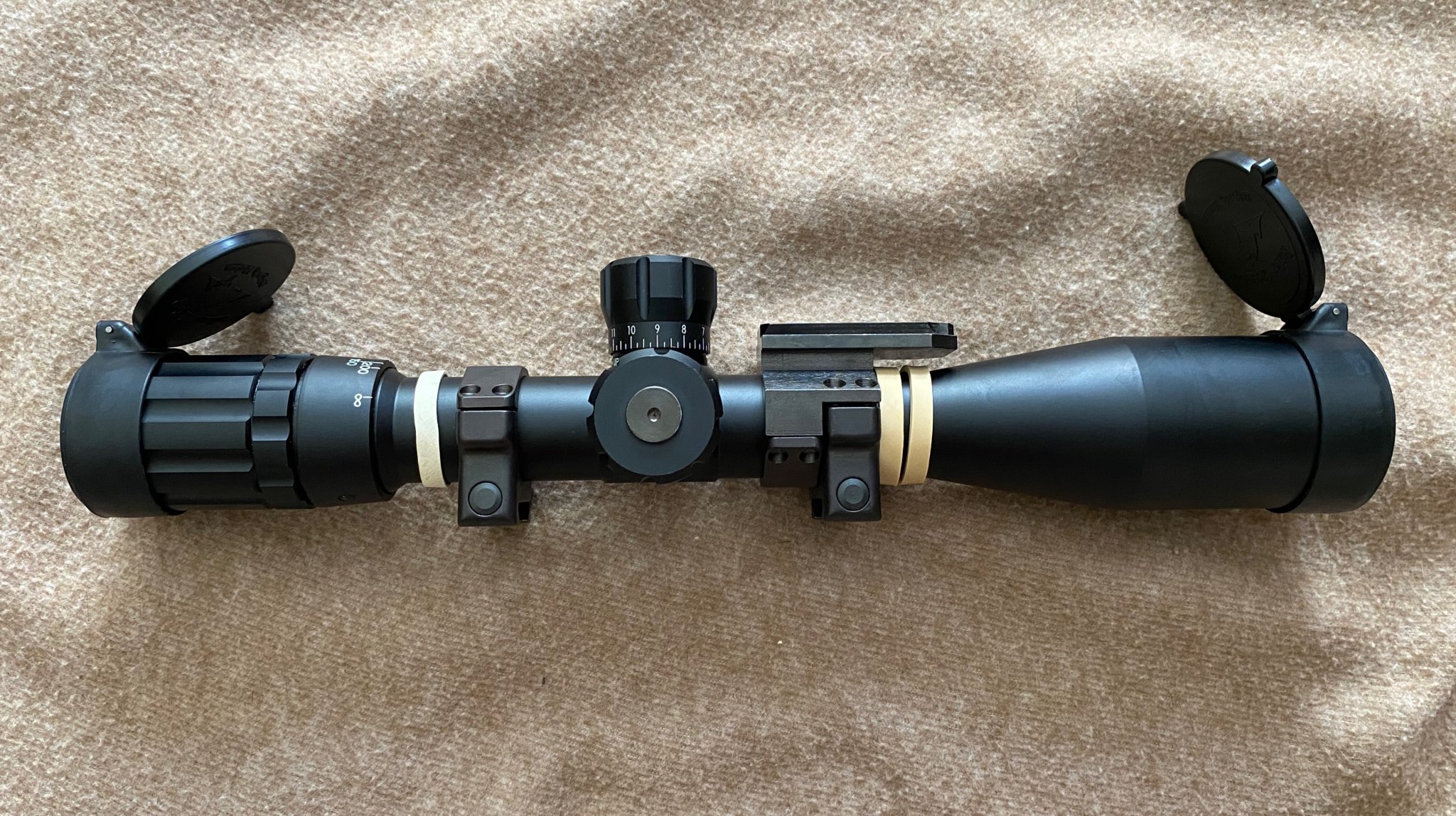

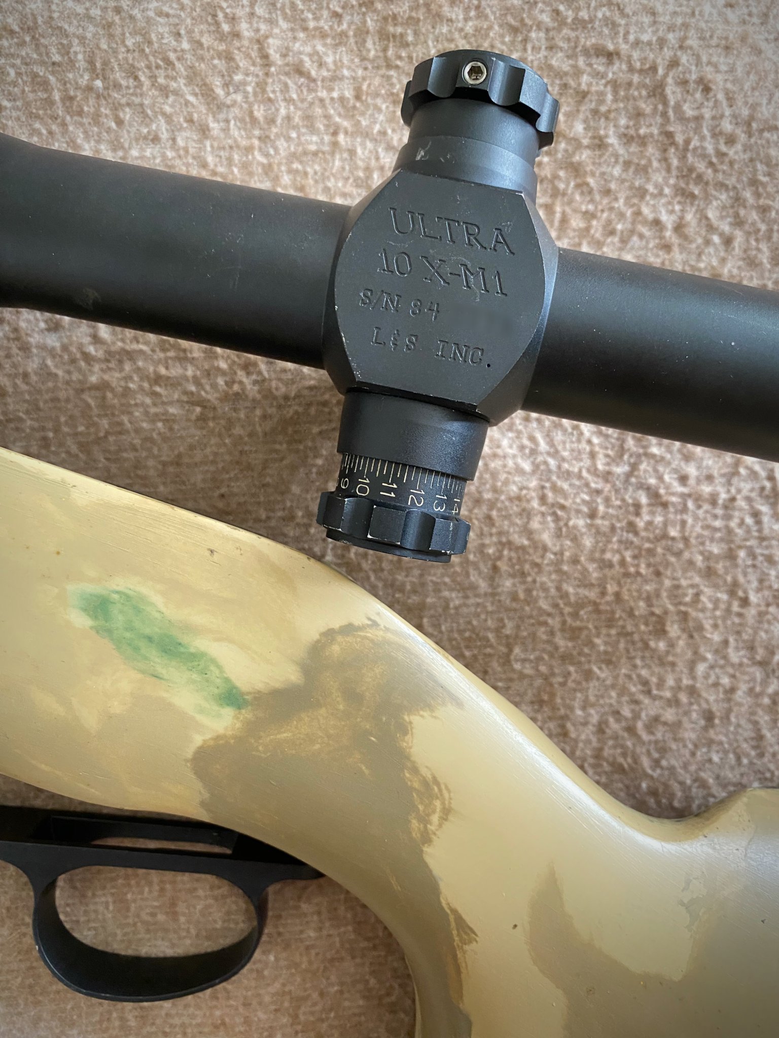

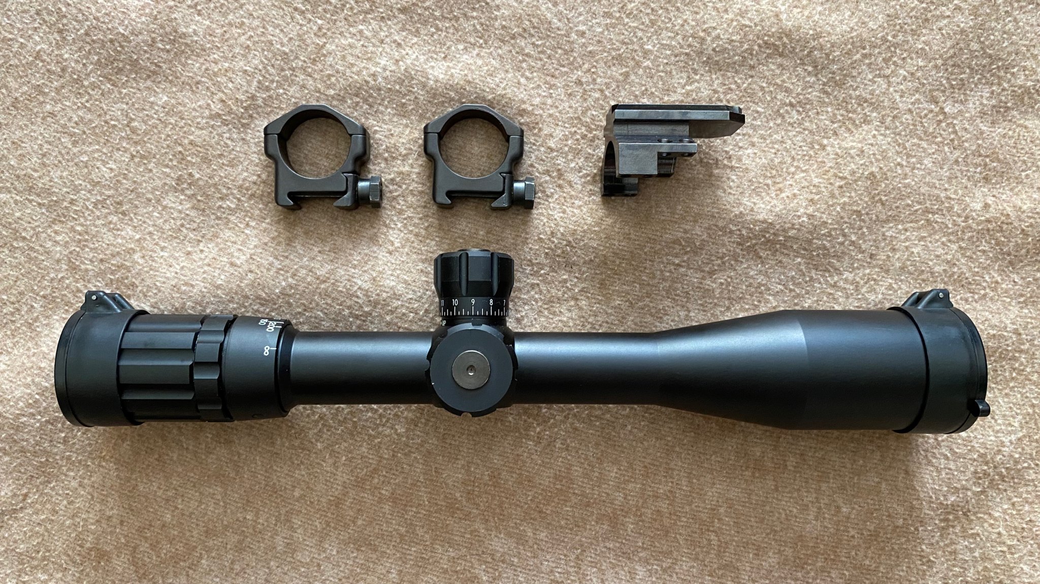

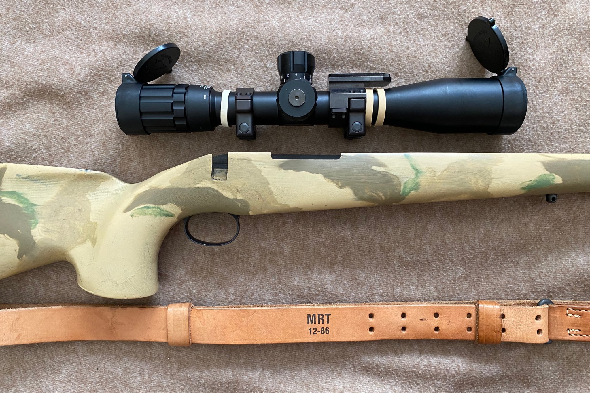

More parts acquired for this M83 build, including a rare Bausch & Lomb 10X Tactical scope, Leupold & Stevens Ultra 30mm rings, and an original simrad cap.
Thanks to those that have helped in obtaining the correct parts for this build, including @Coejro for the OG aluminum ADL trigger guard, which looks so much better on the silhouette stock than the plastic one I had on there before.
Now question is, do I have the proper NSN rubber band, tan, scope tube attached, on there? 🤔

Anything notable about the B&L 10X?
It's features....or why it was used instead of other common for the time optics?
I'm unaware of anything notable about the B+L 10X Tactical except that it was one of the tougher made "tactical" scopes accepted into use by the military at the time (1980s to 1990s?), specifically on the XM25 rifles and apparently at least some of these short lived M83 rifles.

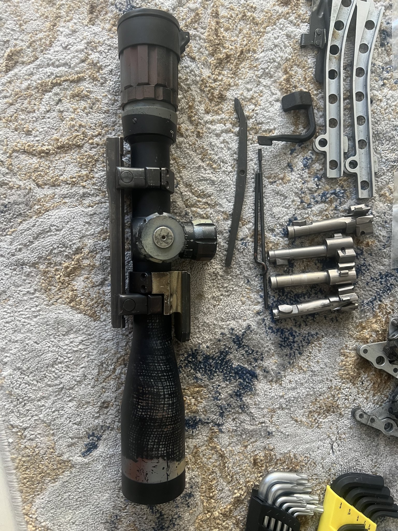

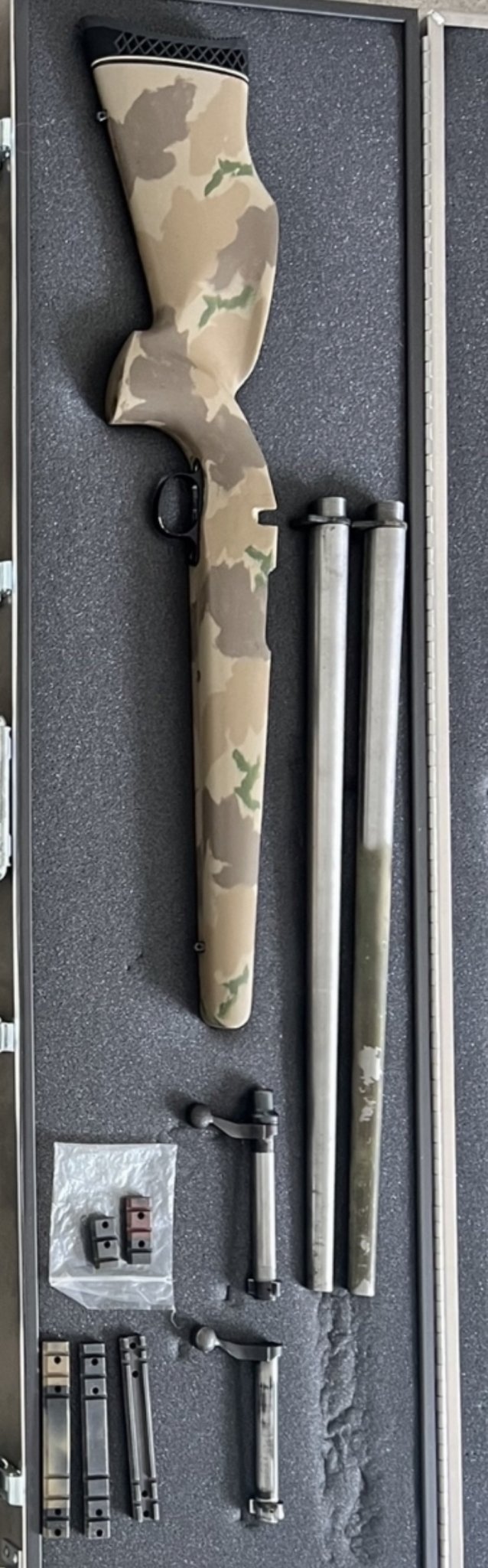

I was lucky enough to get the rails, barrels, recoil lugs, and bolts from decommissioned M83s. Tracking the serial numbers on the bolts, we discovered that these parts originally came from Navy M40s before being used to build the M83s.

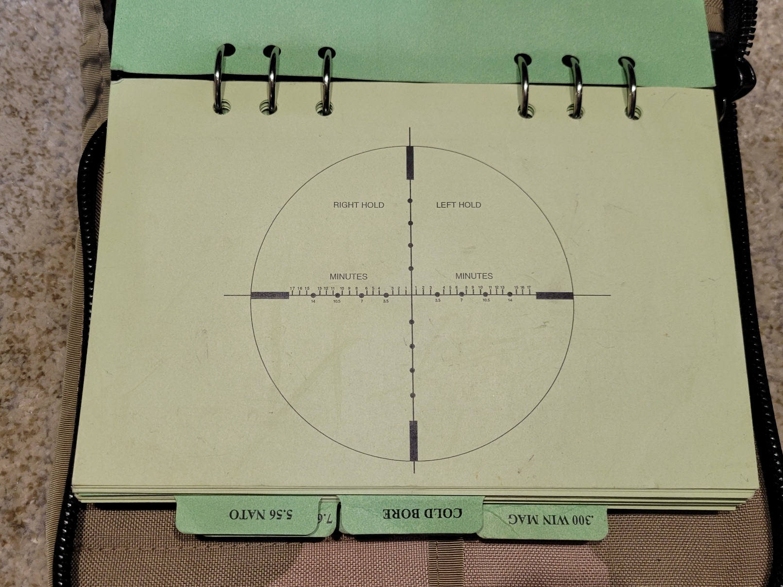

The Bausch & Lomb 10X Tactical scope is an outstanding for its time (1980's). One of the unique features of the scope is that is has 144 minutes of elevation with a 30mm tube. It is also very robust and the glass is excellent , even by today's standards.
I have owned mine since the 1990's and have breathed new life into it. I put it on my precision 22lr and can dial out to 600+ yards. If you obtain one, it's a keeper: You will not be disappointed.

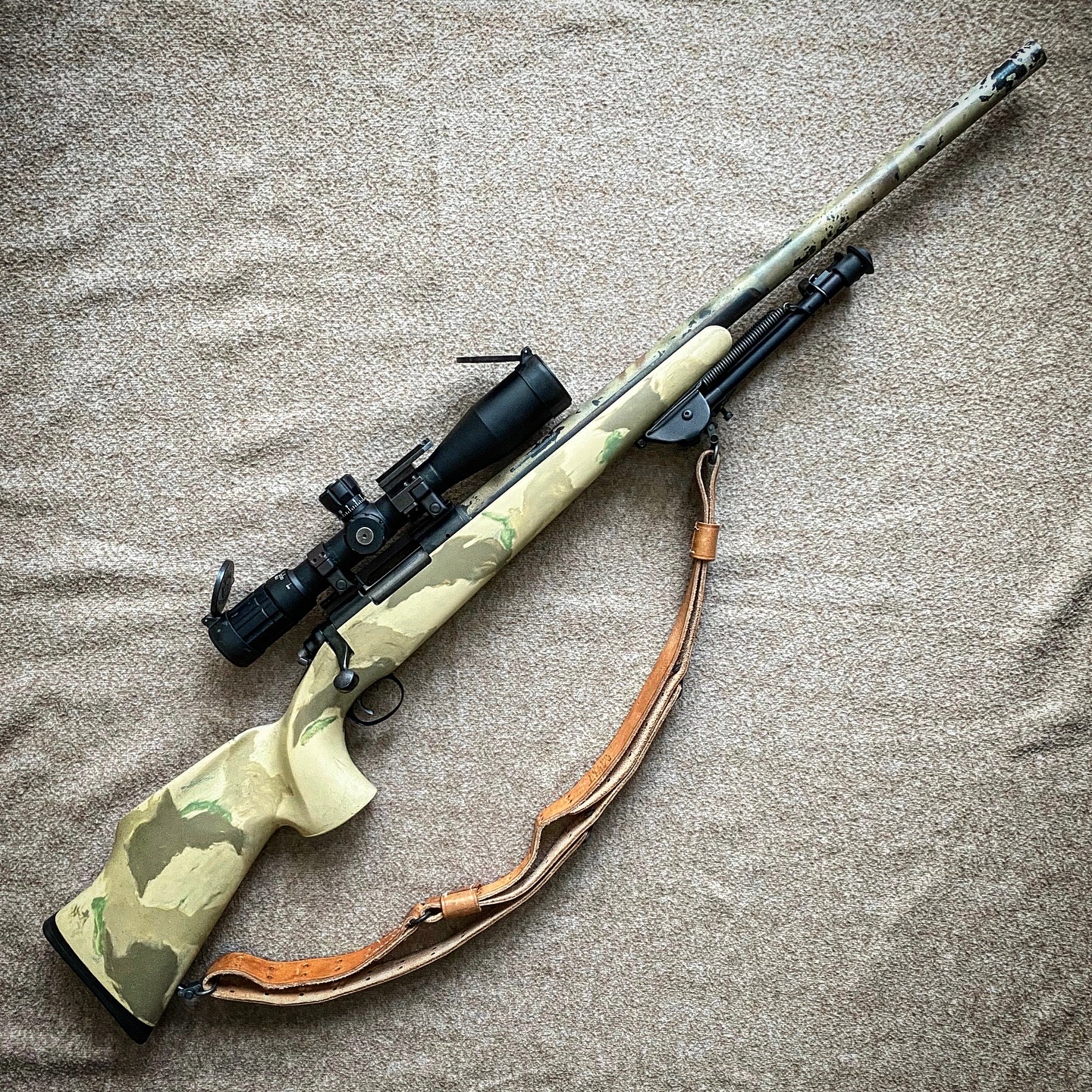

Finally got my M83 put together! Not all of it is “clone correct” (wrong Pachmayr recoil pad, not a real Crane made scope base) but what counts is there: OG McMillan silhouette stock in early desert smear camo, Bausch and Lomb 10X Tactical scope in Ultra rings and simrad cap, and even a real and salty Crane take-off barrel.
