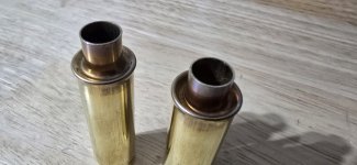

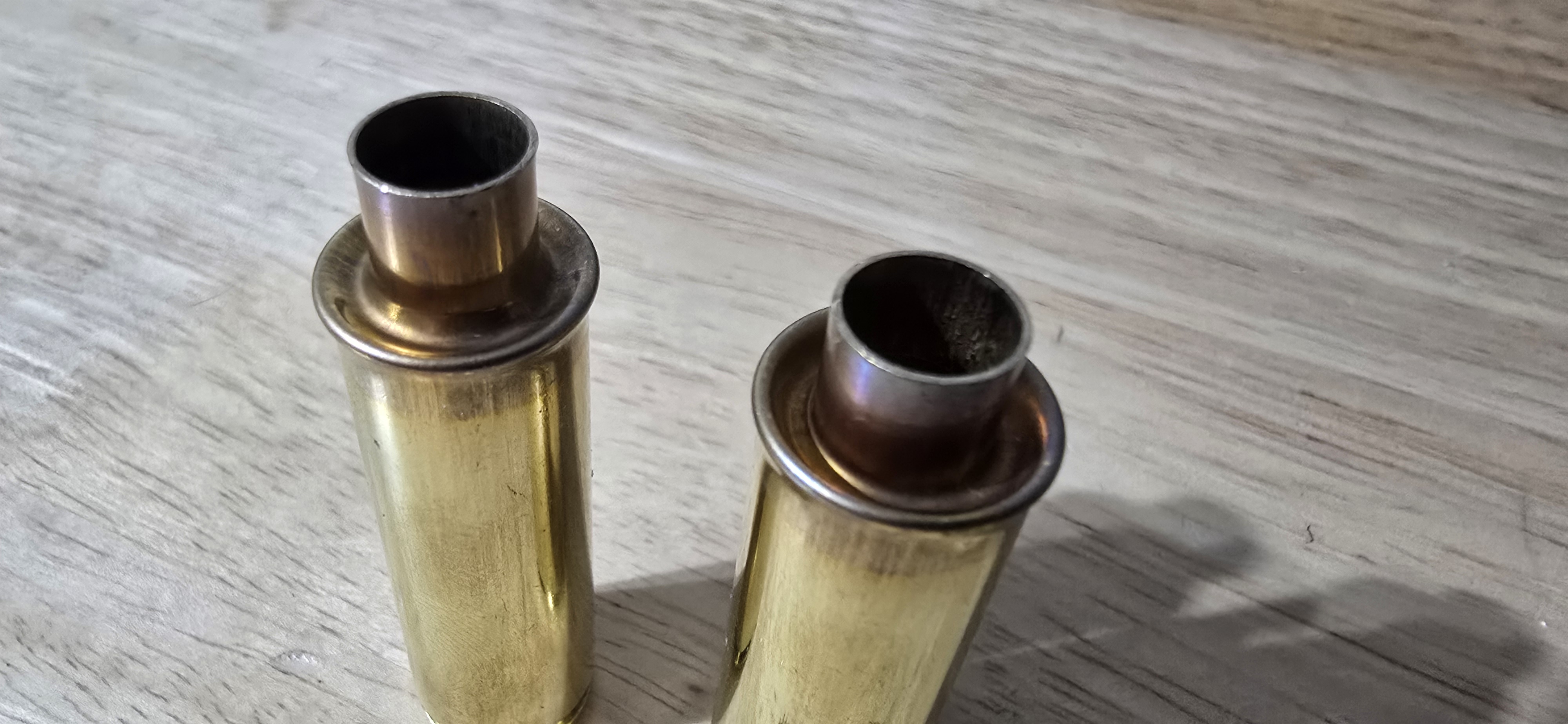

I collapsed 3/50 necks on ADG 300 wsm brass a few months ago just using 21st century nitride mandrel on virgin brass, same mandrel I've used on thousands of 308/300wm/nm cases without issue. The shoulders folded inside the case body and I could barely even feel it happen. Never had this happen on any other brass ever. Setup was not an issue, I can only attribute it to abnormally soft brass.

Heres 2 of the 3. I have to expand them before chamfering so they will fit over the pilot on my henderson trimmer. There were no signifi ant burs on the necks and my mandrel is in great shape. When these necks folded in, the feeling was nearly indiscernable from the rest of the cases, didn't realize what happened until the case came out of the die.
:eek: Yeah, that's pretty bad!
In looking at your picture, another thing just now occurred to me that'd be in addition to the issue of burrs. Looking at the inside of the necks (including those of my own virgin ADG's) I noticed the coating from ADG's annealing process. Annealing always leaves an oxidation layer that actually quite abrasive. It makes me think it added additional resistance when drawing the mandrel through the neck, which may have contributed to that??? ¯\_(ツ)_/¯
I know you said you didn't feel much resistance thinking it's due to them being too soft. But it still take quite a bit of pressure to fold the shoulders like that. When I tested the necks on ADG's for hardness with my Webster Harness Tester, they tested just a little harder than my Lapua brass and about the same as my Peterson brass. I know that doesn't mean your brass couldn't be different. This is just to let you know what I found when doing measurements with my brass. :)
