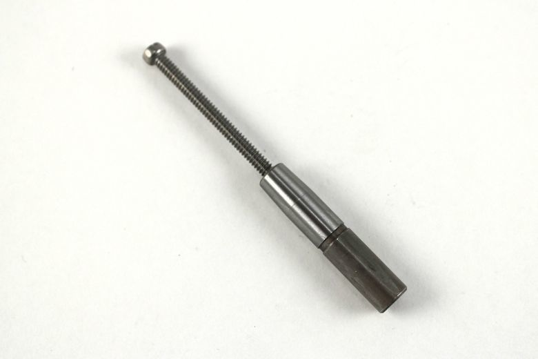

Started using a K&M neck mandrel and noticed on seating it’s smooth and then a bit of crunch/tension
Measured my neck about 1mm below the mouth and had .290”, perfect .002” for my 6.5 creed. However the neck just before the shoulder junction is .287” so I’m .003” more neck tension at the base of the neck.
The mandrel tapers to a max diameter of .264” when it goes flat and there’s not enough bearing surface on the mandrel at .290” to size the entirety of the neck.🤷🏼‍♂️
My question is where are you guys measuring your necks for those using a k&m mandrel and is it ok to set the tension at .002” just before the shoulder? Leaving the neck slightly opened up at the mouth?
I don’t feel that’s correct. I believe that I should have the neck be consistent all the way down at my desired .002” under seated bullet size. Please correct me if I’m wrong. Thanks in advance gents.

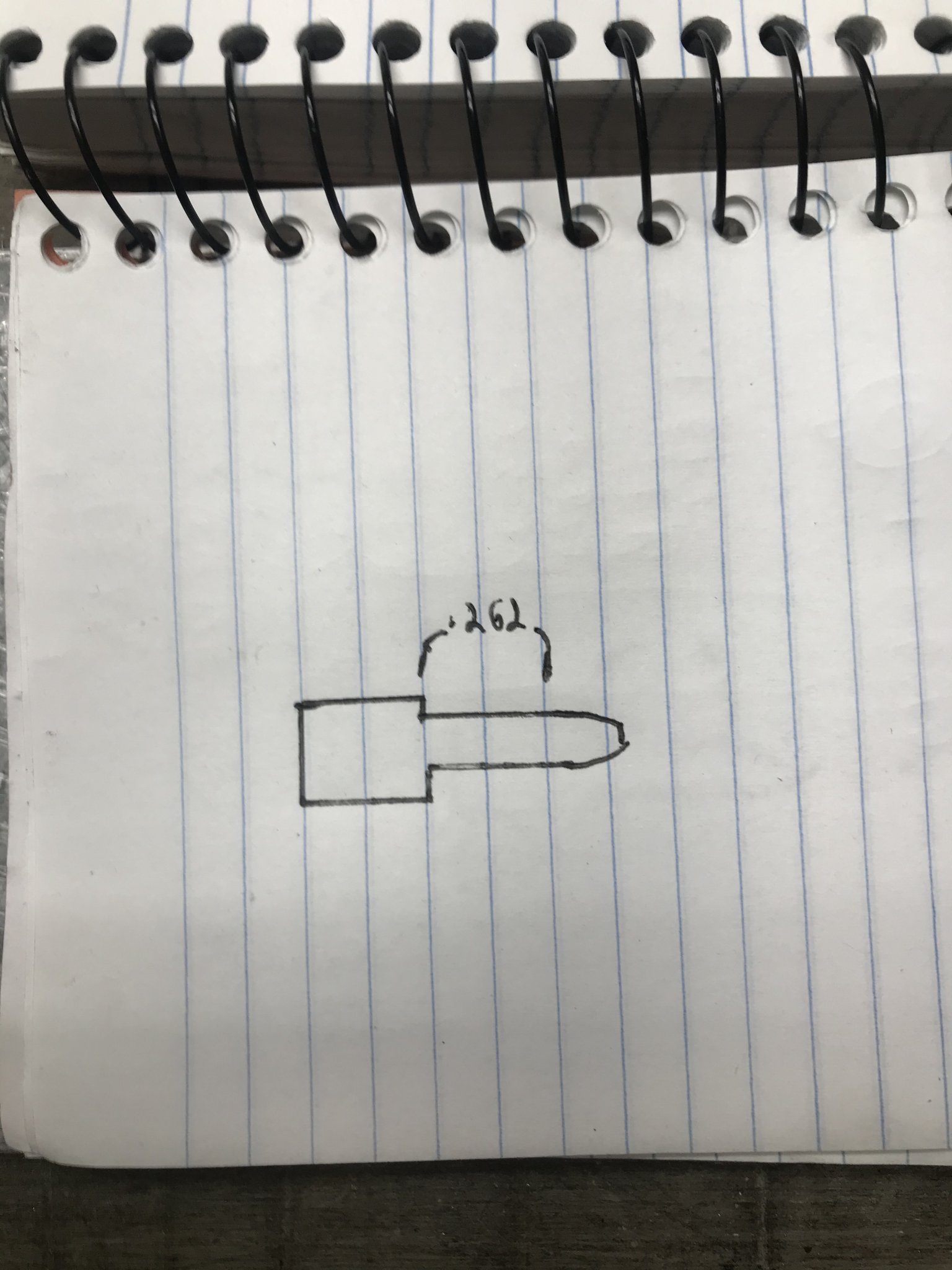

I drew this with my advanced dick drawing skills.
This is what most of my purchased and self made mandrels look like.
Generally there’s 1.5 neck lengths of full diameter shank to work with.
Yea I just make the shank longer and let the press be the stop.

Unfortunately the only option they have on their site was for a "6.5" with no specificity to what desired tension you want. I suppose they aren't wrong. It is a .264" mandrel. But I want the max shank at .262" so I can run the full length of the neck up on it and done.

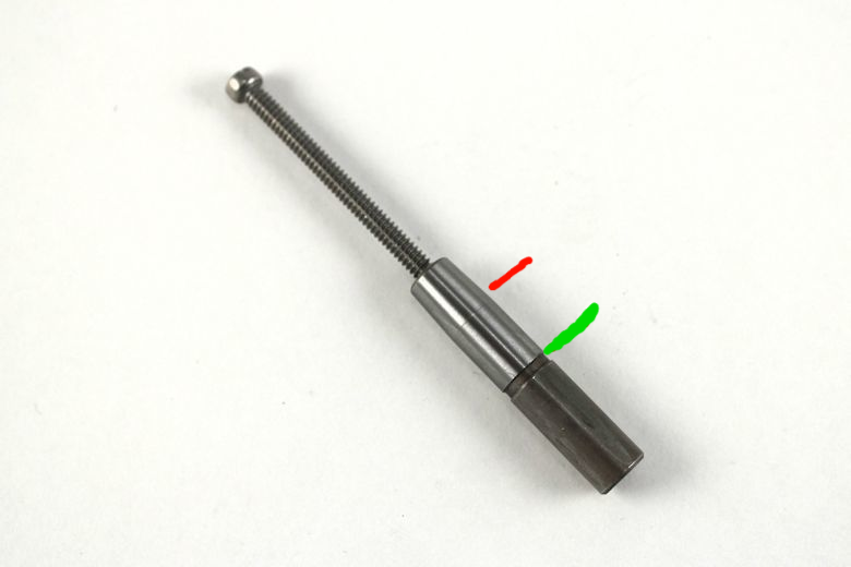

Are you saying that at the part where the taper starts (red)measures .262" but by the time it gets to the end (green) its .264"?
No offense OP but my first inclination when something doesnt work is user error.
Just so were all clear.
No, the from the beginning of the tapering up to the red line is .262" then the flat from red to green is .264"
That's why I can't get the necks to be consistent all the way through. It's only .262" for a very very small section. Maybe .100" worth
I agree with you though. Most often it is user error. I just didn't see any possible way I was wrong here. I even checked the measurements with three different Mic's to verify that wasn't the issue.
Ok got it. In that case yeah sounds defective.
Reactions: Zack_va248
Sounds like the wrong size mandrel for what you want. The 'flat' section should be doing the final sizing, not the tapered bit.

OP you need to adjust your mandrel so that the edge of the case mouth ends up at the green line in the picture above.
The stop screw is hitting the bottom of the case and preventing the mandrel from completely expanding the case.
The problem is that the expander body between the red and green lines is a full .264 instead of the .262
