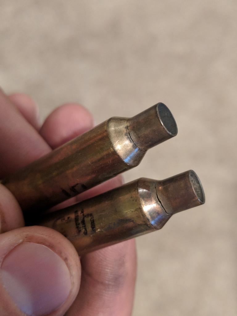

After 3 firings of Nosler brass (6.5 creedmoor), I had 2 cases out of about 80 that has a crack right at the junction of the neck and shoulder going around the case about 1/4 of the way. Any ideas of what would cause that?
Post any issues in the thread below or reach out directly to support!
View thread Contact supportI bought the brass new, brother loaded 3 times and I fired 3 times in a Tikka CTR. I then was preparing to anneal it and noticed the cracks. I haven't fired it for a forth time (got busy with work and bow hunting) so I don't know if there will be more failures at this point.Weird. Could it just be a defective batch of brass or perhaps brass that may have been over-annealed at some point?

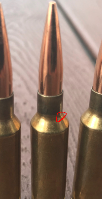

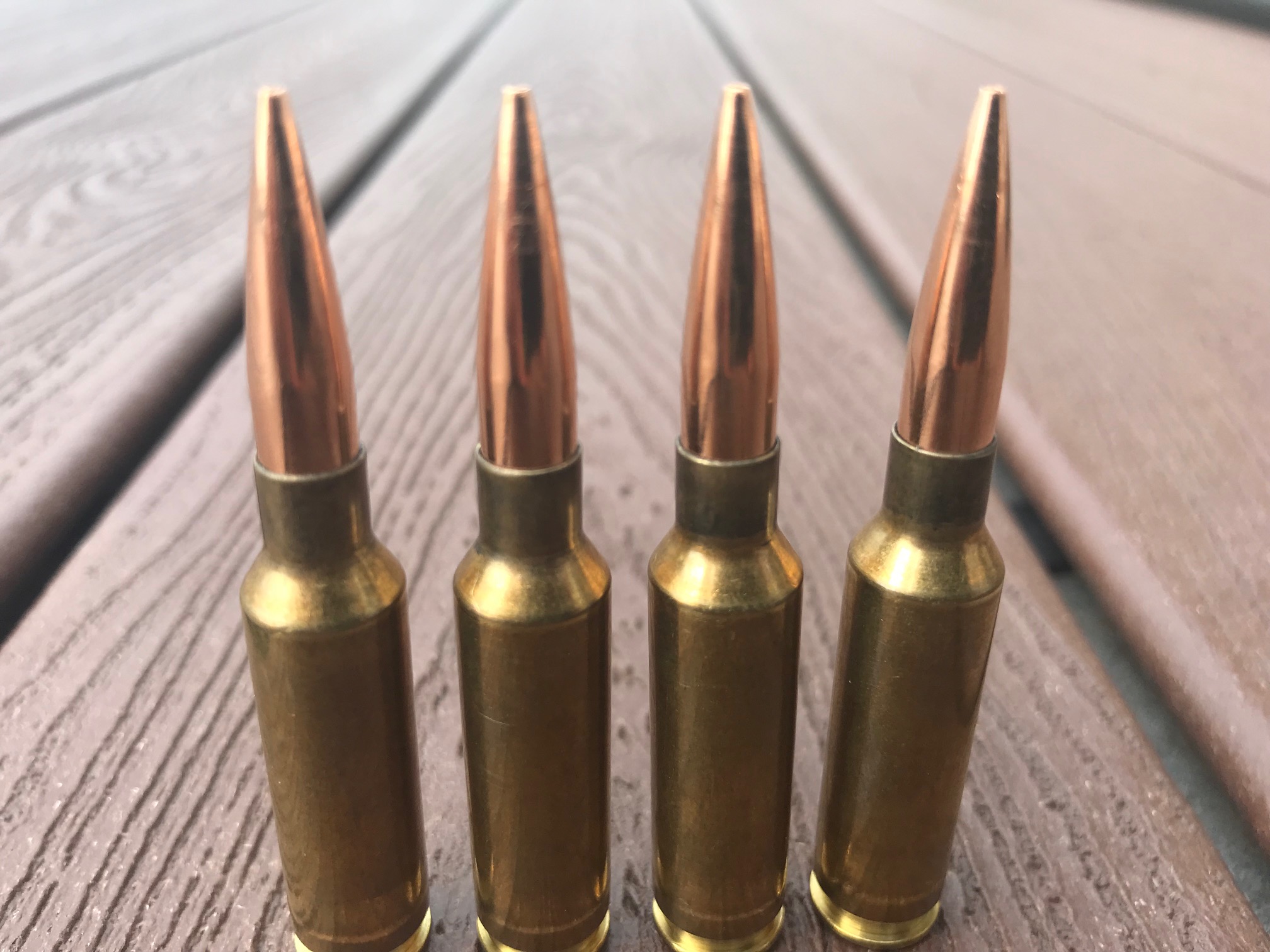

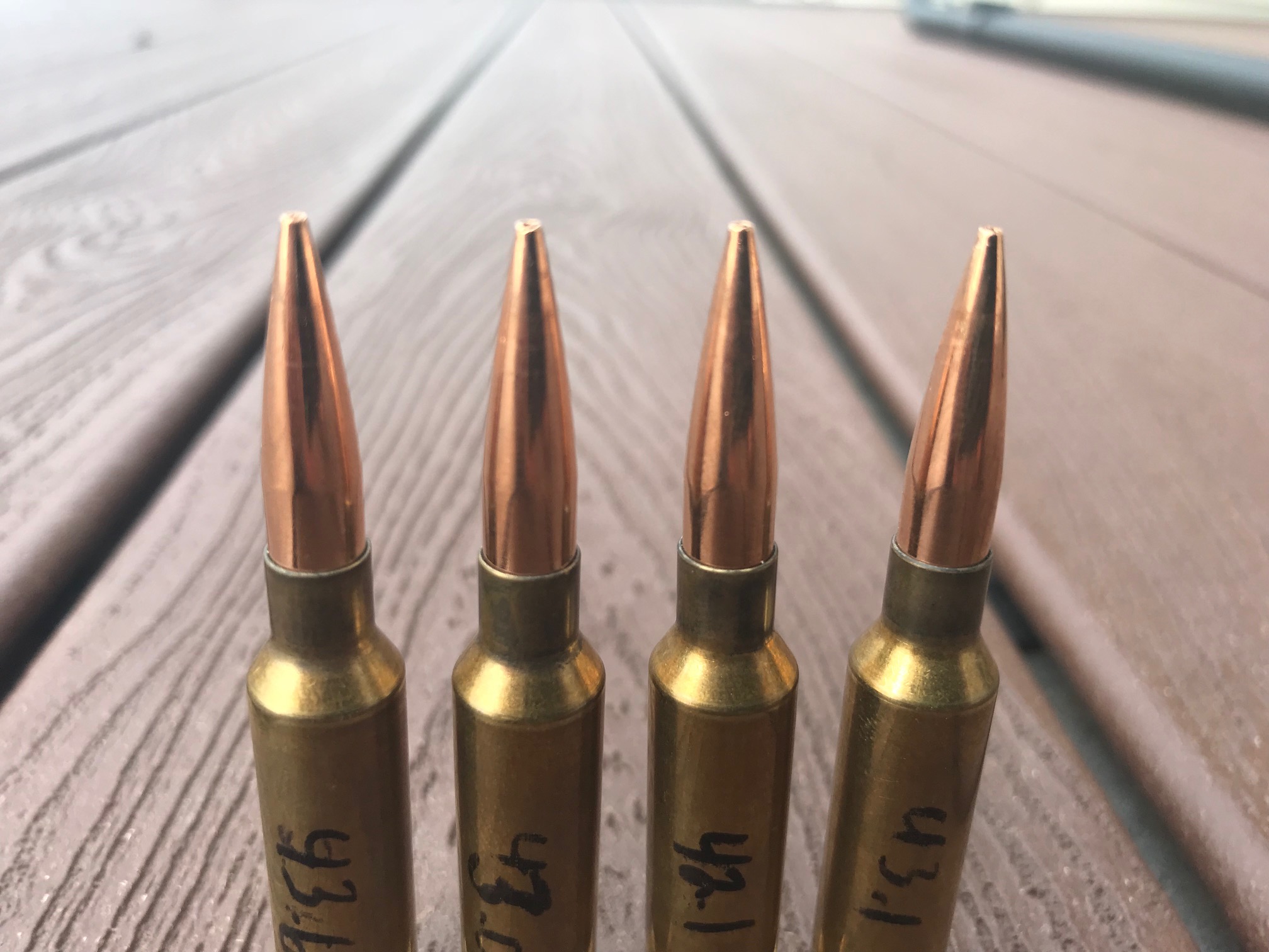

Take some pics of a couple loaded rds in the same area. I may be on a fishing expedition.
Thanks for taking the pics, I was thinking your die may have a ridge right at the shoulder-neck area where a chunk of the reamer that was used had broken off, not it. But by the pics, it looks like there is a line just below the shoulder-body junction? The left case, could be pic, looks rounded too. Are the shoulder angles the same from sized to fired?Please see the requested pictures of both sides of a few rounds. These have been loaded 3 times (not fired the 3rd time). View attachment 6951418View attachment 6951419

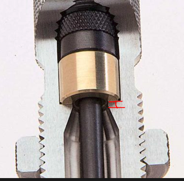

I don't know a lot about it (my brother loads for me) but I know I bought a Redding die set for him to use on them since he didn't have any 6.5 dies.Is this a bushing die?

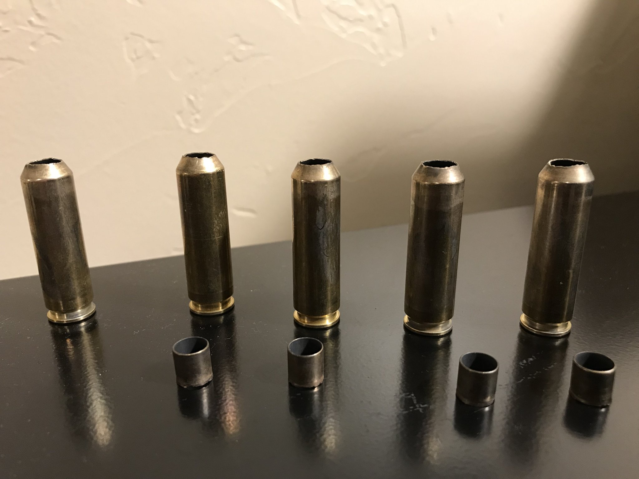

Thanks for your thoughts- The brass was bought new from a reputable company so I'm certain that it only has 3 firings on it. I have sent an email to Nosler so it will be interesting to see what they say about it on Monday or Tuesday or Friday......Just another dumb-ass opinion but ... there is something weird here. I have been doing some sort of precision handloading for about 25 years and in all that time, I have shot off exactly one neck. It was 300 win mag with many-times-fired brass. You sent a picture of five pieces where you shot the neck off. I confess that I shoot brass until the primer pockets are too big or until I get incipient or partial head separations. Yes, I am a bad person for wearing out my brass but I do not get what you are getting. Either the brass itself is different or you are using a different process to convert fired brass into ammunition.
Button dies: when inserting the brass into the die, there is a force pushing the neck straight down into the case, simultaneously a force squeezing the neck to a smaller diameter and later a force pushing the shoulder toward the base of the case. The force squeezing the neck stops above the junction where your separations occur. The only force that might overstress that specific place is the first one. Maybe you could use more lube ? There is also a force reducing the case body diameter but that is lower than your fracture and it doesn't seem to relate.
I was contemplating, is the button too small? Maybe but it seems unlikely. When I do that, the neck is visually smaller-diameter at the top and larger near the neck/shoulder junction. When seating bullets, the upper part still looks a little smaller than the lower part. The extra fat shoulder helps to center the round in the chamber when I close the bolt.
