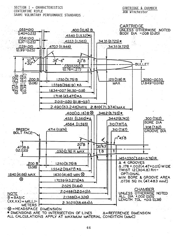

The SAAMI specs on chambers and cartridges are wide sloppy tolerances with no over lap.
This makes for lousy chambers and lousy dies. Together they torture brass and reduce accuracy.
Using the 308 as example:
The SAAMI spec on the chamber neck is from .3462" + 0.0020"
The SAAMI spec on the cartridge neck is from .3435" - 0.0080"
That would make one think that the clearance between cartridge and chamber would then be randomly somewhere between 0.0027" and 0.0127".
But what really happens is the chambers are made as close to the minimum and the ammo is made close to the minimum, so the clearance is a narrow Gaussian distribution centered near 0.0107".
A typical .308 full length sizing die with have in a neck inside diameter of 0.328".
So the die squeezes the case neck down to .328" and it springs back to .329".
The case is then fired in a .347" chamber and springs back to .346".
The die squeezes the case neck down to .328" and it springs back to .329".
This happens a few times at .346 - .329" = .017" of plastic deformation and then something happens, the necks get work hardened.
C26000 brass is tempered to H06 hardness at the case head [65,300 psi yield] but the necks are annealed.
With work hardening the necks start to spring back further and stand some chance of splitting.
What can you do?
Pay extra for a no turn neck chamber reamer at 0.335".... not sloppy SAAMI.
Pay extra for a FL die honed out to 0.330".
Now instead of .017" of plastic deformation per shooting and resizing cycle, you have .003".
Or if you want to turn necks like benchrest shooters, you can get it down to nearly NO plastic deformation.
As soon as the crazy amount of resizing go away, the expander ball may pass through the neck without causing any more plastic deformation. But who needs the extra friction?
Expander balls belong in the junk box.
