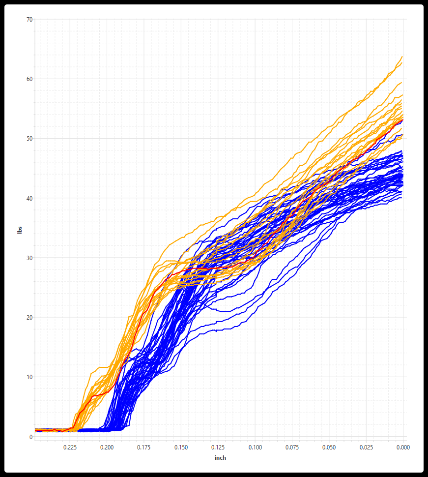

    Below is an overlay of a couple groups of rounds that I did a few weeks ago. The blue is 45 rounds - 43 of which fall within 8 lbs. I tend to mark the "fliers" to use as foulers. It's taken a lot of playing around with different things to get the forces this tight.
    Anyone care to guess what the orange plot is? Hint: it ain't what you will think and may surprise you. It took some emails with AMP to figure it out.

    I would have guessed it's "what you think" (either annealing or Neolube vs dry lube) so I won't guess, but I want to know! What did you figure out?
    The first 45 bullets were out of one box of lot #1468 of Berger 220s. Then I ran out of bullets and had to open a new box of lot #1468 of Berger 220s. Nothing else changed. Same brass prep, same press setup, same time, same everything. Literally, all I did was get up, walk over to where all my bullets are, retrieve a new box of the same lot, and continued seating.
    I contacted AMP to get their perspective and the first thing they said was, "measure the bullets."
    Unfortunately, I had taken those last 45 bullets out to the hills the weekend before. Fortunately, if you want to call it that, one of those rounds had a bad primer. So, I pulled that one bullet and compared it to a few bullets out of the new box.
    What I found:
    - The OAL was essentially the same.
    - The body of the bullet was ~.025" longer on the new-box bullets - measured by putting a comparator on both ends of the bullets.
    Looking at the graph, you can see that the new-box bullets engaged around .025" earlier. That makes sense if the body is longer. You can also see that the slopes of the graphs are essentially the same. The reason the terminal forces on those bullets is higher is that there is more bearing area. In fact, if you just slid the orange plots to the right, they would match up.
    EDIT: Morale of the story, measure your bullets every time you open a new box.
    What I found:

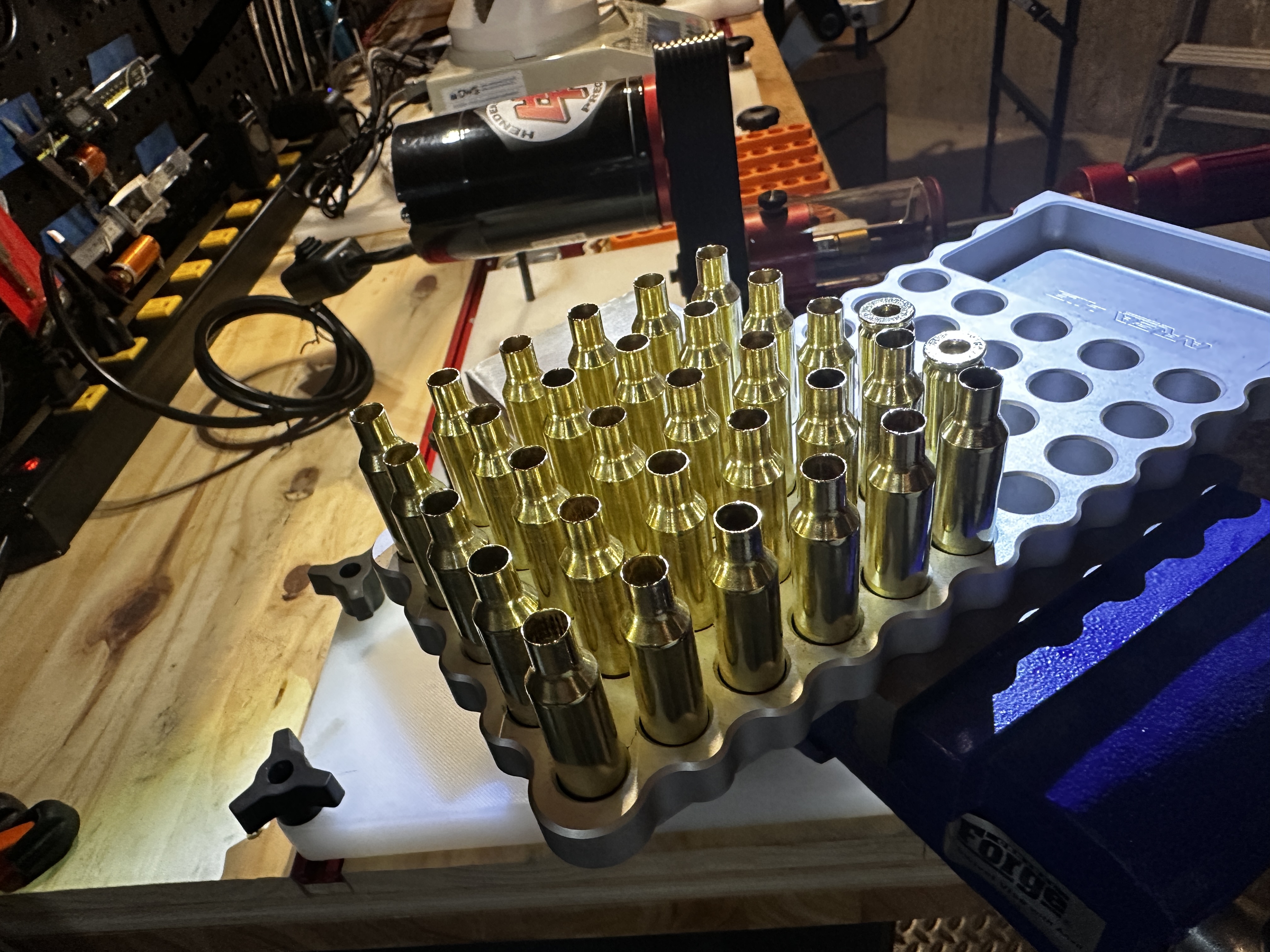

    I've been wet tumbling fired brass pretty much my whole life. Never been a problem. I use stainless steel ball bearings instead of pins because they don't get stuck in the case mouths like the pins have a habit of doing and I can always tell if there are any inside a case. I've yet to have a ball bearing left inside a case if I run them through the media separator, but if its a small batch, I sometimes just rinse them and dump them by hand.
    This is what my fully prep'd wet tumbled brass looks like.
