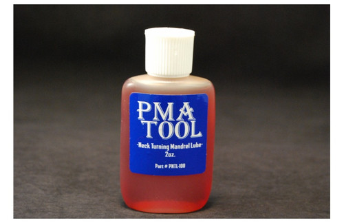

When I first started turning necks I used RCBS case lube. I would apply it with a q-tip type of cotton swab. At some point i got some of the PMA neck turning lube as part of a package i bought. I like how it works.
