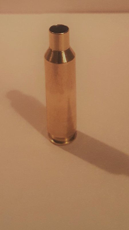

Here is a piece of brass that I just prepped. It seems like this one came out better. I tried to run the case through the expander die without performing an outside chamfer (debur), but the case didn't want to go into the die. I did tweak my full length resizing die. Maybe that was the trick? Maybe I need to adjust my cutting length to go slightly further into the shoulder?

For expanding the neck prior to turning best to use an expander mandrel matched to the turning mandrel. The expander mandrel is tapered at the end allowing it to enter the case neck, Turning looks fine and you may want to cut a little further into the shoulder. Main reason for cutting into the shoulder neck junction is to minimize the formation of doughnuts.
