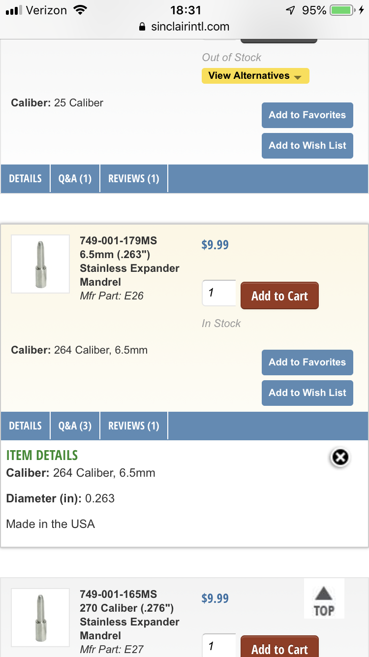

Buy a mandrel die and the appropriate mandrel. Brownells/Sinclair sells them reasonably. There are others as well. Lube up your necks and mandrel, and go to town.
This and the expander die should be all I need?
