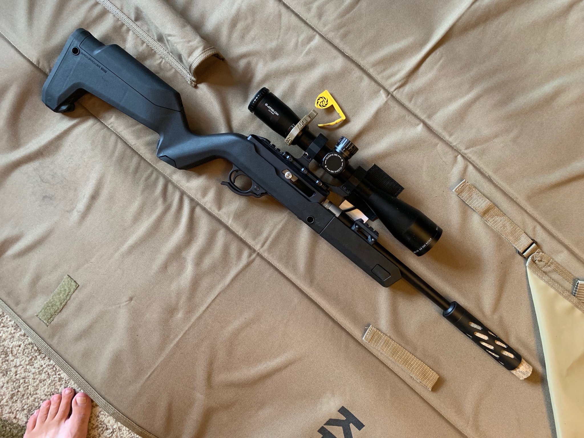

No flex problem at all with my Victor Titan using a Short Action Precision positional sling or loading the bipod hard:
