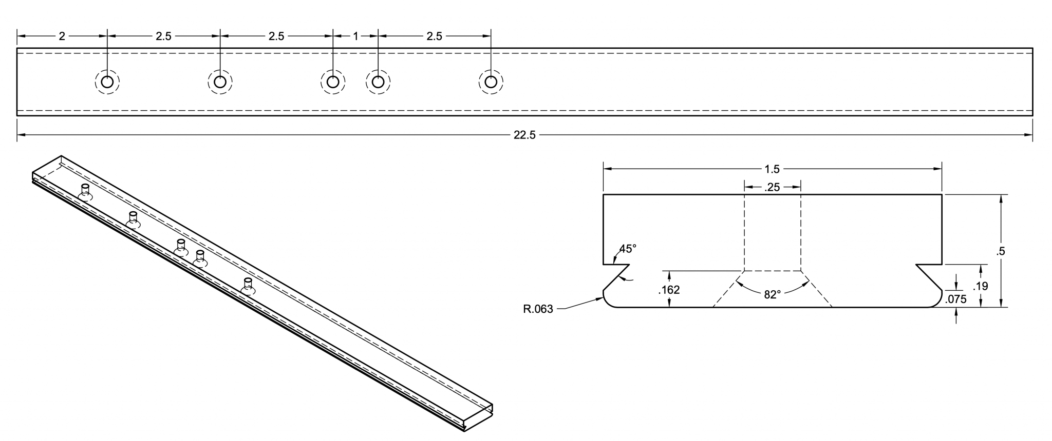

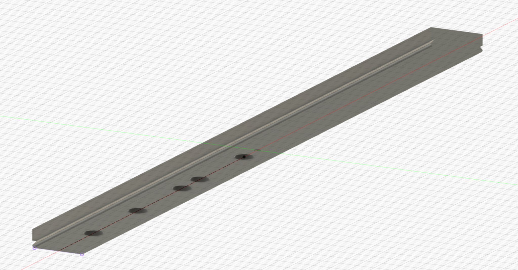

Hopefully this is the right place for this.
I’m looking for someone out there with a mill that can make me a custom Arca rail for a rifle. It will be 22.5” long, cut out of 1/2” thick steel bar, RRS spec dovetail, and 5 countersink holes drilled for attaching to a hand guard. I’m playing around with Fusion and got everything drawn up to my specs so I can send over drawings. If anyone is interested, please PM me and we can chat about specs, price, etc.
I’d like this done out of some sort of steel that has the least amount of flex. I’ll rely on you to tell me if it should be some sort of stainless, high carbon steel, etc. There is going to be a lot of weight on this part as well so that is something to keep in mind when thinking about steel choices. Thanks and let me know what you think.

You could always put it on Xometry and get bids, you may need to specify the material to get an accurate quote. Something like 416 or 17-4 stainless would be durable, probably want to go with prehard to hold tolerances. Although 6061 aluminum with type 3 anodizing would probably hold up just fine.
Thanks for all the help guys.
I've received quite a few quotes I'm sitting on right now. $150, $250, $350, (all 4140 PH) and Protocase came in at $1,660.99 (Carbon Steel) and $2,001.12 (Stainless) LOL.
I'm currently chatting with the guy that gave me the $150 quote. Not a terrible price but a lot cheaper that one of these...https://accuracysolutions.com/product/bipodext-elr-picatinny/
