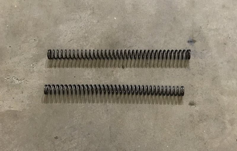

Have a 2006 production FN SPR in .308 and am looking for a replacement striker spring. Anybody know of any extra power ones out there?
Brownells has a section on replacement springs.
Looked there first. They've got a Wolff spring listed for long and short action, Pre- and Post-64, but the SPR is that weird WSSM action I think. I'll email Wolff to verify.
Thanks though!
These are the specs Wolff emailed me for their 25 lb. spring:
Wire size - .054”
End OD - .410”
Body OD - .403”
Body ID - .295”
Length – 5.61 inches long with 37 coils
How does that jive with the factory spring?
IMG_1144.JPG Old spring on the bottom and new 25lb Wolff on the top
