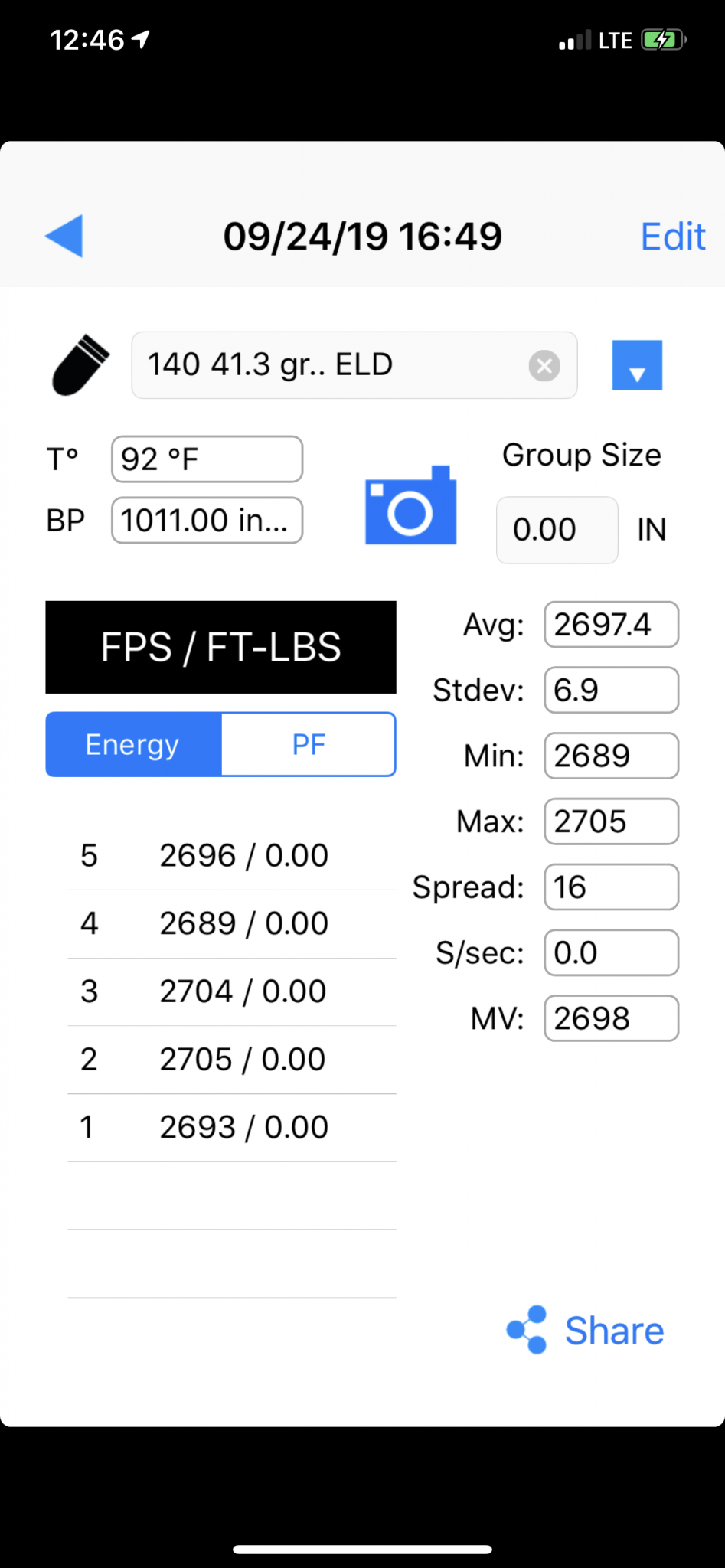

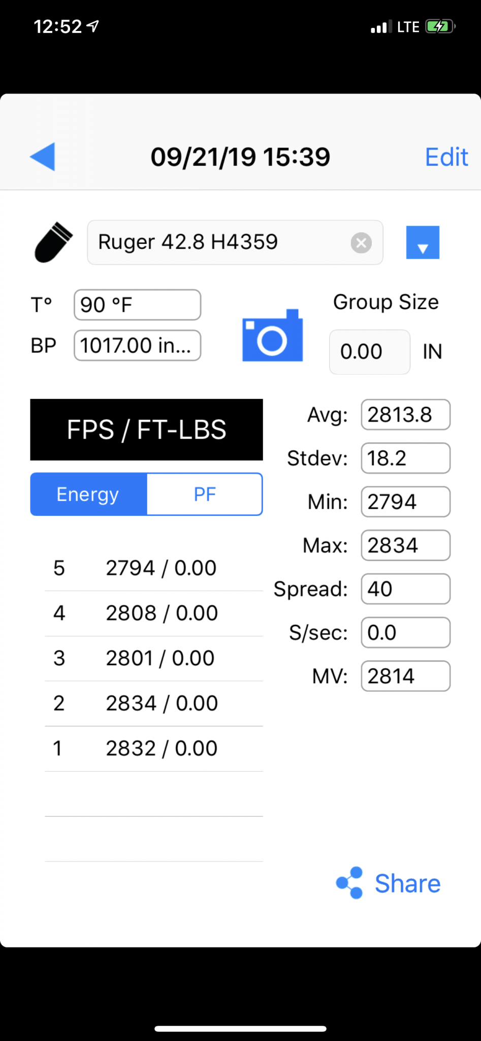

I'd call Ryan at Magnetospeed and see if he can help you. I trust them on all my guns from .22LR to my .416 Barrett. It has given me precise MV that has matched up with no truing past 2 miles. The people above saying to ignore chrono and true don't have to shoot different environments that much. I demand a chrono I can trust day in and day out.

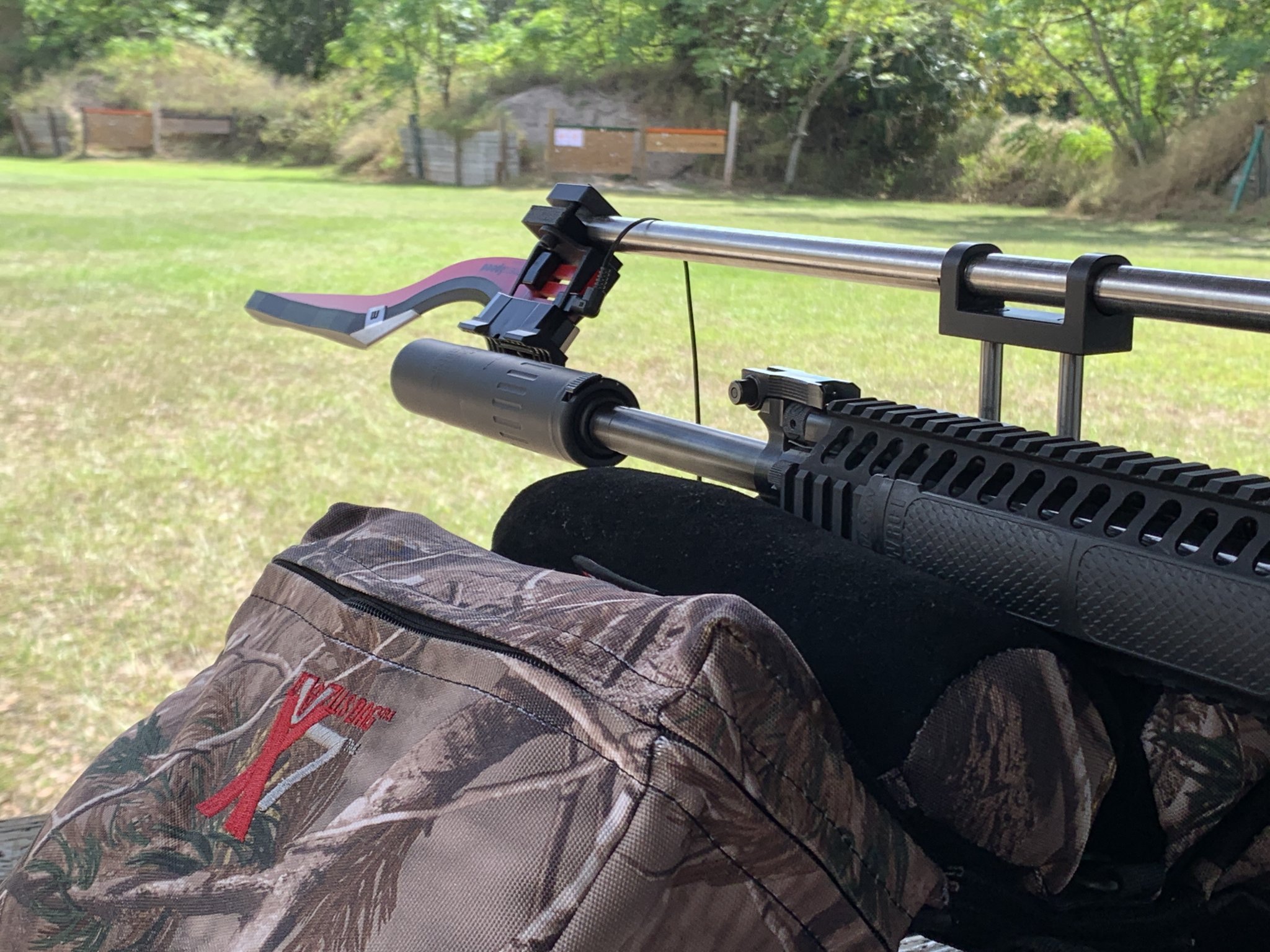

If you have a picatinny rail segment available the mount from MK Machine for the Magnetospeed V3 is a great option. No POI shifts to worry about. If you don’t then LabRadar would be my next choice.
