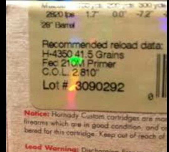

Need a lower ES do 6.5 creedmoor
Brian Turner
Target shooter mainly
Jul 3, 2023
22
6
90602
Hello all,
I’m looking for a powder with low ES for 6.5 creed. I am getting lapua brass tomorrow, but Starline small primer- with 6.5 staball and hybrid 100v I have never got anything less than 30-40 fps in ES - I am also looking for 2750 ish fps or above. Most everything seems to be reading pressure lower than that mark with a 140 grain eld-m or 147 grain eld-m. Is anyway getting 10-20 fps in their loads? Thanks - BT
Books and websites are always lower that’s why it’s recommended that you charge until you hit pressure then back off. Then you know your pressure for your chamber.
Reactions: Brian Turner
Sorry, didn't pay attention to the velocity part. Seldom is the "fastest" load the best in regards to precision or consistency. For years factory Hornady 140 ELD-M was 2710 fps out of a 24" barrel and was the gold standard for 6.5 Creedmoor.
You are going to make compromises to get there when the "easy button" answer is a longer barrel.
One of the VV 5xx series powders might be the answer for you but that also comes with a shorter barrel life.
Check out the reloading sub forum here.
Books and website are always lower not so much because each chamber is different, but more so because most people are running at a higher pressure than they realize. Just because you don't get pressure signs doesn't mean you're not running close to or over saami max pressure. There are no "built in lawyers" in loading manuals and such. Those loads are literally where they were at or close to max saami. That being said, that also doesn't mean it's not safe to go over book max. Just understand the reasons aren't what most people think.
Also, realize what you're asking for when you want a 20fps ES. That would mean a sub 4sd. Which is extremely good ammo and may require more work than just good components and such.
You're requesting a very, very narrow window. You want a very fast velocity with your cartridge/bullet, and you want a very low SD.
I actually just put on a a 28” barrel, the main thing I notice there is a more complete burn of powder. With Hybrid 100v I can get good velo and no pressure my es is between 30 and 40.
H4350 is a great place to start.
I agree that many people are running loads above what is traditionally considered to be safe pressures. I've been guilty of it as well. Be careful with others recipes on this site, because many are probably flirting with or are in pressure.
However, I think 2750 fps with 140's, especially out of a 28" barrel is okay. Factory loaded 140's will run faster than that. My personal load of 140's is 2850 fps in a 24" barrel, which is about 10 fps slower than factory loaded Hornady 140 AMAX ammo.
Using good reloading equipment and components, without any crazy reloading steps, it should be relatively straight forward to develop reloads that have an SD around ~7 fps. At least that's been my experience with the cartridge.
You might try H4831sc. I've been getting around 4-5 SD at 2700fps out of a 24" with the 147 eld-m.
I may soon. I just bought some new Lapua Brass. I got more interested in shooting 4350 because I know a guy who is semi pro in f class, and uses 4350- gets low sd and es, and gets damn near 2800. I can get near 2800 with Hybrid 100v, and I may just deal with the higher es if i get the accuracy I want, which was really good. I watched a video the other day where a guy was shooting 140 bergers, and getting 2800 and had a very low es with the factory ammo. So i know it is possible, and I think a certain powder is a key. All from 24" barrel.
Reactions: Tcorb734

The original loading of the Hornady 140 AMA Creedmoor load was 41.5grns and was 2820fps from a 28" barrel. They later dropped to a 24" barrel on the box and adjusted velocity accordingly.

Prolly Start a tad lower with Lapua brass.
That recipe Rob posted is for Hornady brass, different internal volumes.
