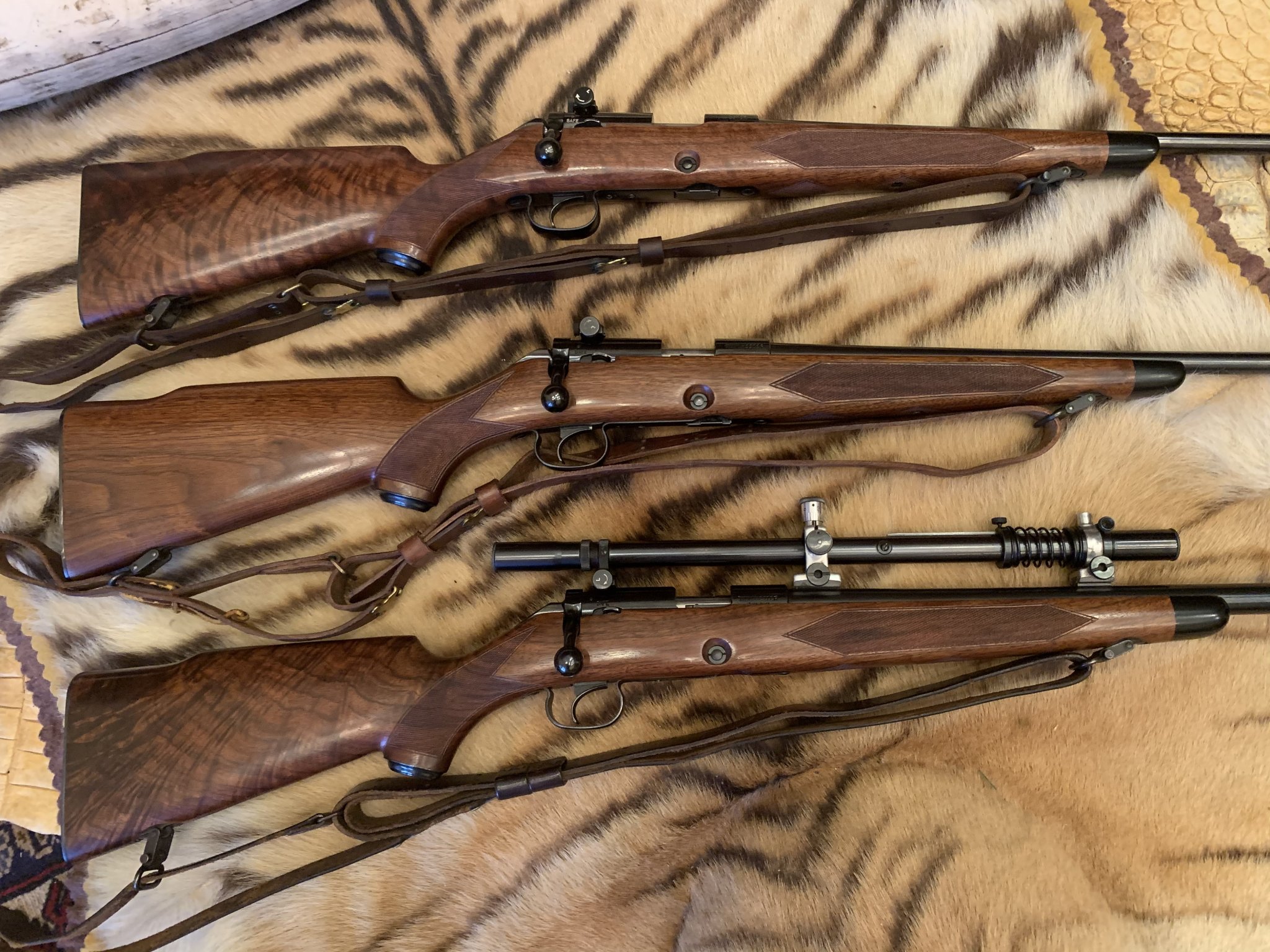

Dammit man, those 52 sporters are too pretty to hunt with. Beautiful rifles. Envious. As for the OP's quest, I like to use a 3-12x or a 4-16x on most of my squack rifles although I am not opposed to irons either. One of the best budget scopes out there today is the Hawke 4-15x-50 SFP illuminated. Another nice glass is the Mueller in 3-9x or 4-16x. They are cheap but have very clear glass and decent turrets for the money. There are better scopes and cheaper scopes out there but both of these are good ones that I would buy again.
