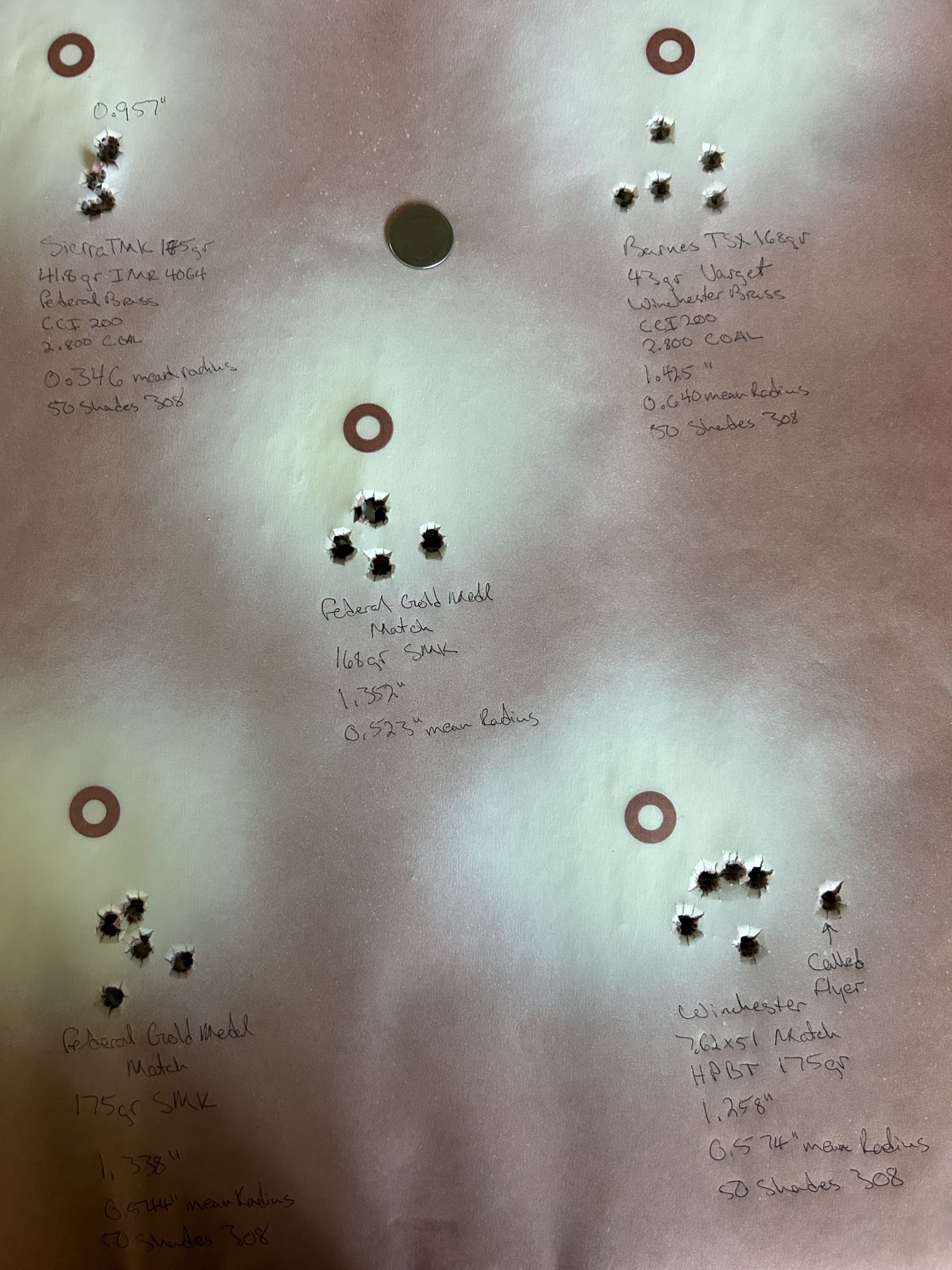

Had a Faxon Gunner that couldn't do under 3-4 MOA. Current Wilson Combat 20" Super Sniper won't do under 2 MOA with 5 different factory loads and it's heavy 50.7 oz
JP Rifles? I heard Wilson Combat makes the blanks?
Rainier Ultra Match?
Proof Research? Do carbon barrels have erratic accuracy issues?
Do you reload? I have the Wilson 20" and I get under 1" with my loaded 168's or 175's.
If you are using factory ammo for hunting, 2" isnt good enough? I dont hunt myself but I ask as I see these threads frequently on the hide and the answer always seems to be that you dont need to be under MOA with a hunting round / gun.
No, I don't reload. The barrel is too heavy to be 2 MOA. Just not worth it when I could get a cheapo pencil barrel for the same accuracy and be much more enjoyable lugging it around.
