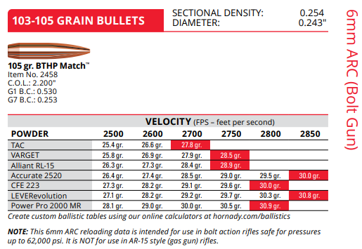

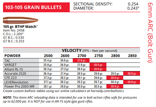

Link to Rob's reloading test with 105 gr BTHP and 28.5 gr Staball Match on a 22" rifle got 2699 fps and SD 16.5.

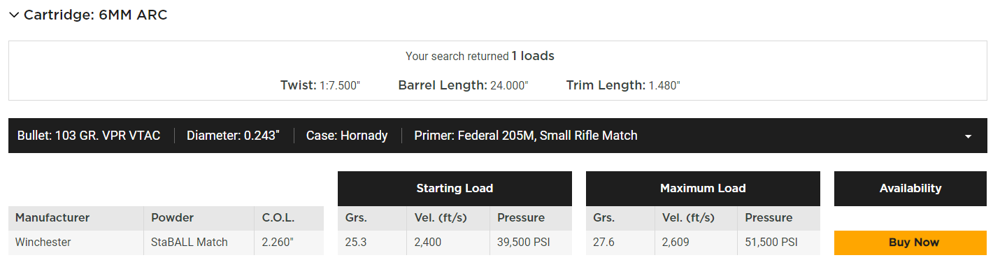

(Hornady's site doesn't list Staball Match reloading info and Hodgedon's site doesn't have bolt gun info nor the 105gr BTHP listed)

Hogdon will only give you data on the 6 ARC to the AR MAX Pressure.
I would load 3 at 27.6 and see what my velocity is and work up from there. You will not have issues getting the speed. The accuracy of the load could be the issue. I am at 30.2 of CFE 223 for my 112 Match burners in a 22" & 26" barrel. If my ammo is kept in my pack on hot and cold days my velocity does rise. I have a temp table of that ammo built 10* to 120* and my data lines up great to 1275. I typically get to shoot 2 PRS Matches a year due to all my rimfire matches.

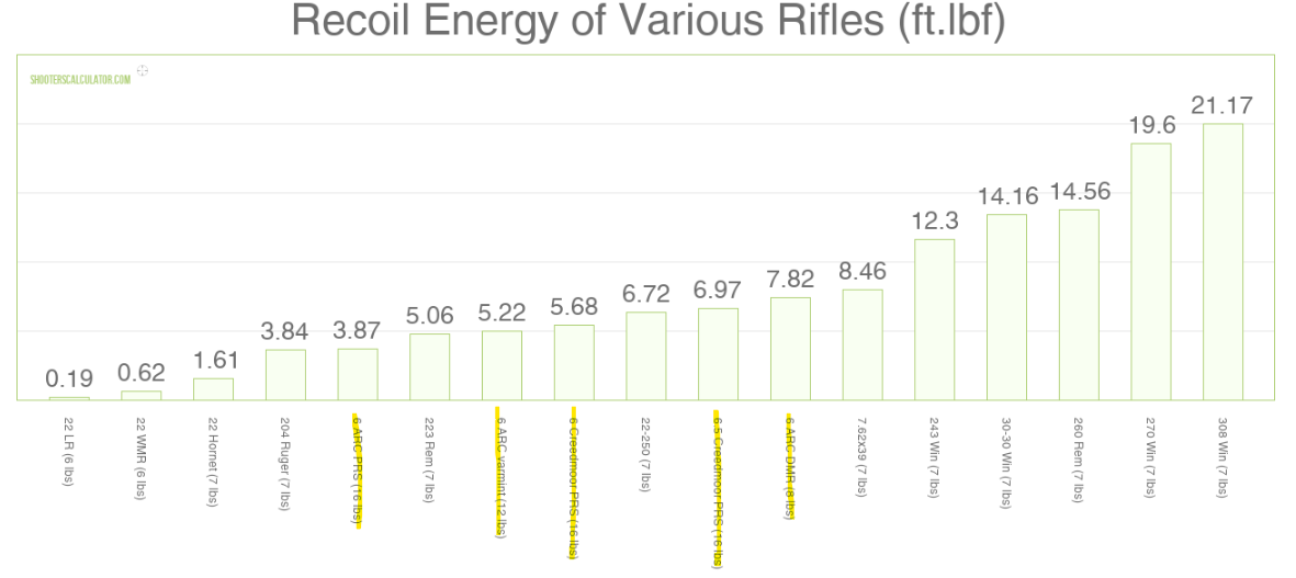

To carry the conversation along, I'll drop this recoil energy calc graph from ShootersCalculator.com
If 2850 fps can be safely reached with a 26" barrel, it may translate to an advantage to consider for PRS type shooting.
Agree, black line is geared towards the AR platforms, but even the 108gr Match has AR-15 platform in the product description.

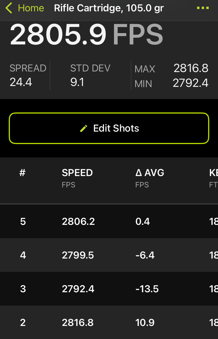

If it helps I get 2580 fps with hornady factory 108eldm and 2560fps with 105 black. Out of 16" bolt gun. Both shoot lights out at 500m but the match is more consistent.

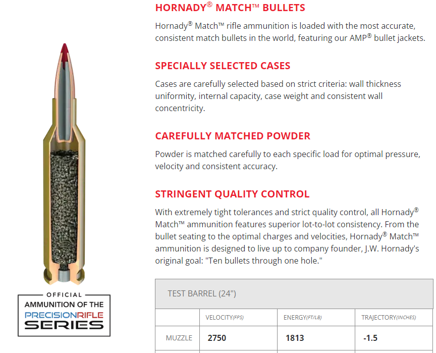

From Hornady’s official intro video of 6 Arc.
Looks very similar to CFE223/LeverEvo/Staball Match.
I’ll have to weigh and shoot the box ammo next to the same charge of Staball Match hand loads and possibly do a temp sensitivity test along side it.

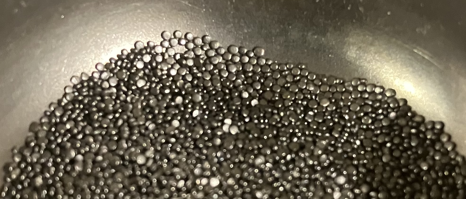

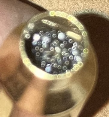

Update:

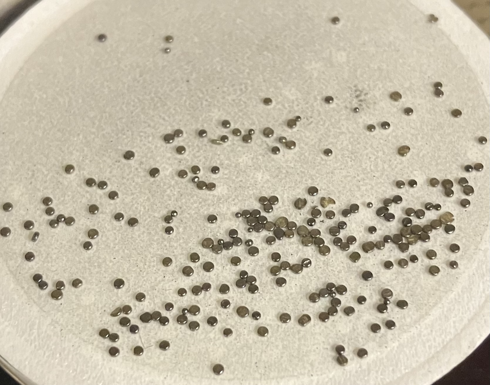

Used a kinetic bullet puller to examine the powder and took measurements.
Hornady 6 ARC Black 105 gr | Hornady 6 ARC Match ELD-M 108 gr
Total wt 254.8 gr | 258.2 gr
Bullet wt 104.8 gr | 108.1 gr
Powder wt 31.0 gr (compressed) | 30.1 gr (compressed)
OAL 2.206" | 2.250"
CBTO 1.728" | 1.704"
Base to datum 1.184" | 1.185"
Case length 1.481" | 1.481"
Neck diameter, loaded 0.270" | 0.270"
Comments:
1. For both factory ammo, powder fill is almost up to the neck, definitely a compressed load as I reseated the bullet to original CBTO. (photo 1)

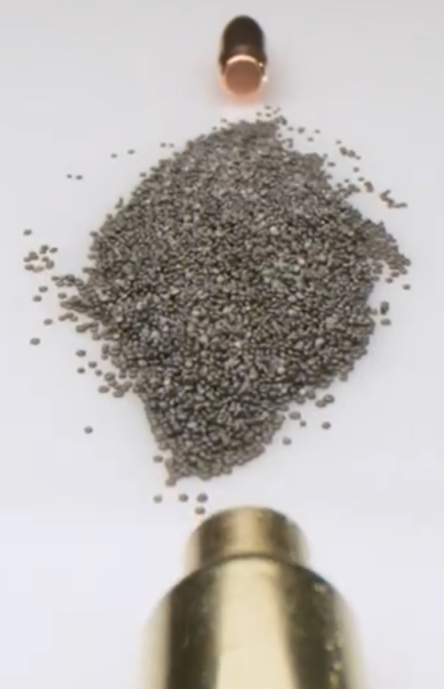

2. Ball power is very similar in size to Staball Match but slightly darker (photo 2).
3. Also similar to CFE223 but slightly more uniform in size but same color (photo 3).
4. Load data from Hornady matches up almost exactly with CFE223 for 103-105gr bullets (photo 4).

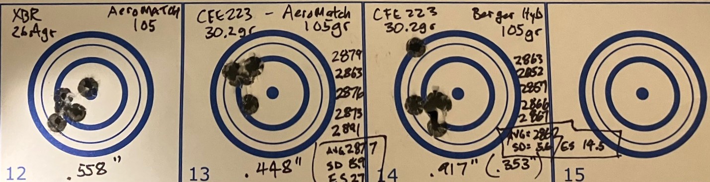

Once I have my barrel, I'll chrono the factory loads that's been cold stored, room temp, and warmed with a pocket warmer.
Once I have brass, I'll ladder test for velocity with CFE223 and Staball Match.
Final consideration, the Hornady Podcast had 4 shooters talking about their PRS and NRL Hunter cartridges and the cartridge they started, went 6 CM, then to 6 ARC bolt and gas gun, then considering going back to 6.5 CM.
Stay tuned.

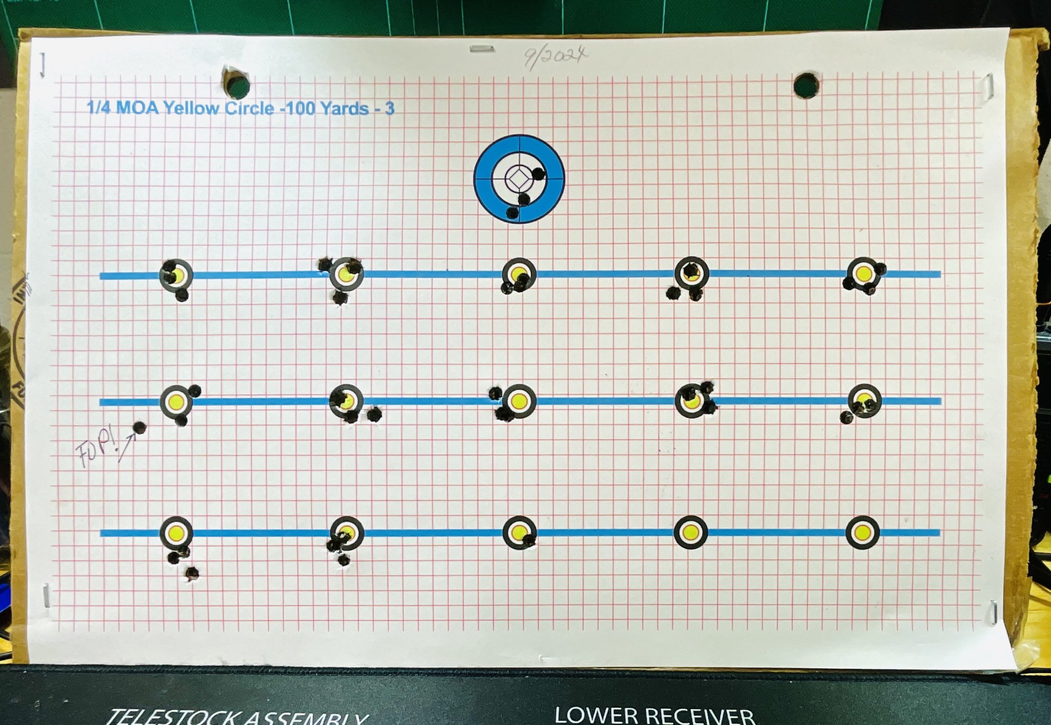

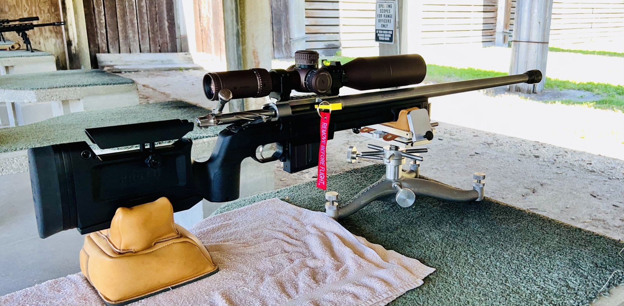

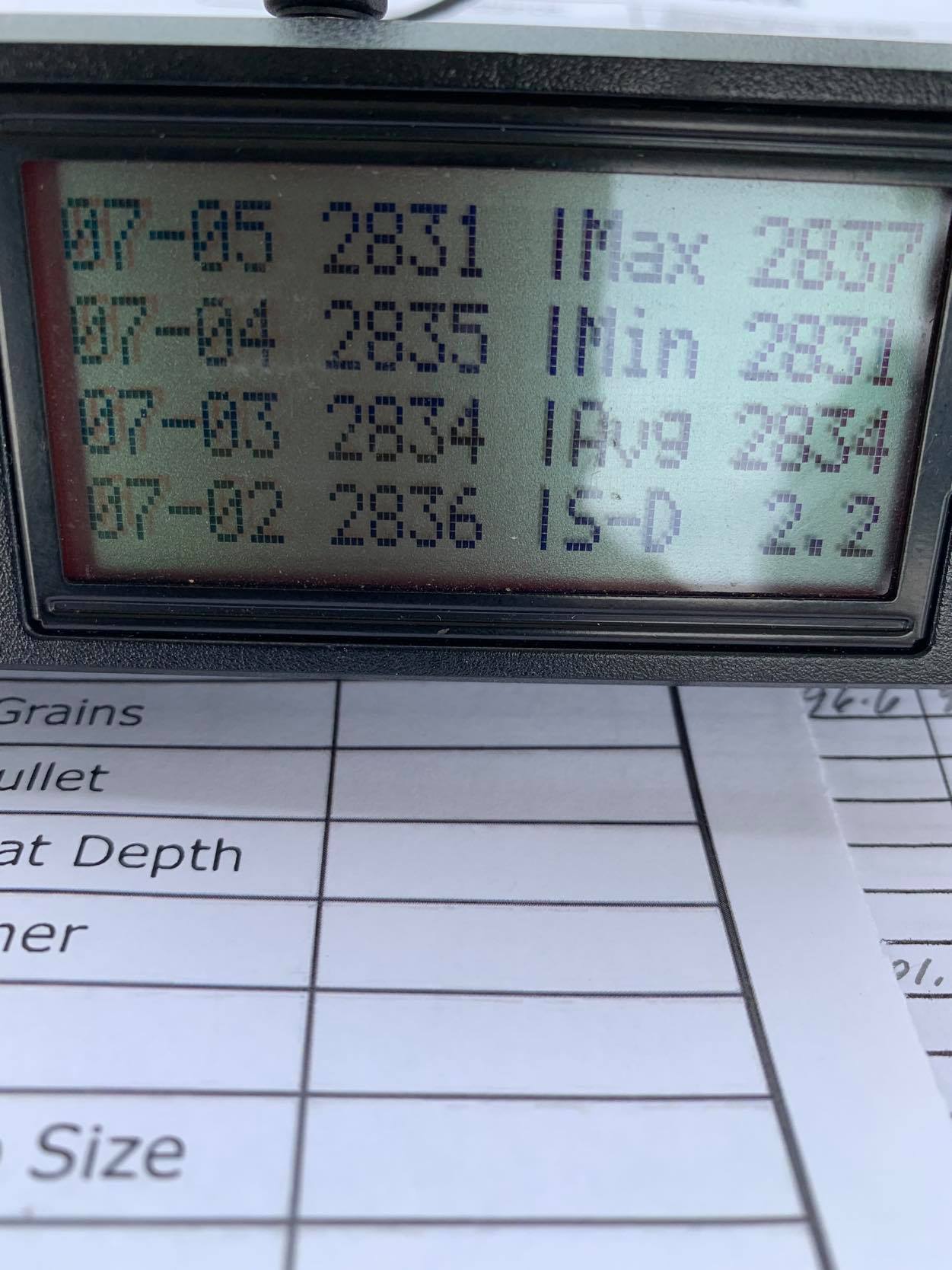

I've been shooting the factory 6 ARC 108s for a number of years. In Florida I shoot in the 60's and 70's in the winter and high 80's to low 90's in summer. The temperature instability is there but not as bad as variations in powder charge.
My 6 ARC (see below) with a 26-inch barrel averages 2750's in the summer an 2740's in the winter. However, I do occasionally (say 1 shot per box) get a shot in the 2690's, but that happens at all temperatures. Best guess is that with small case capacities a few grains left out from a case by the automated production process this is expected. That all said, I did get one case lot that was all in the 2690s.

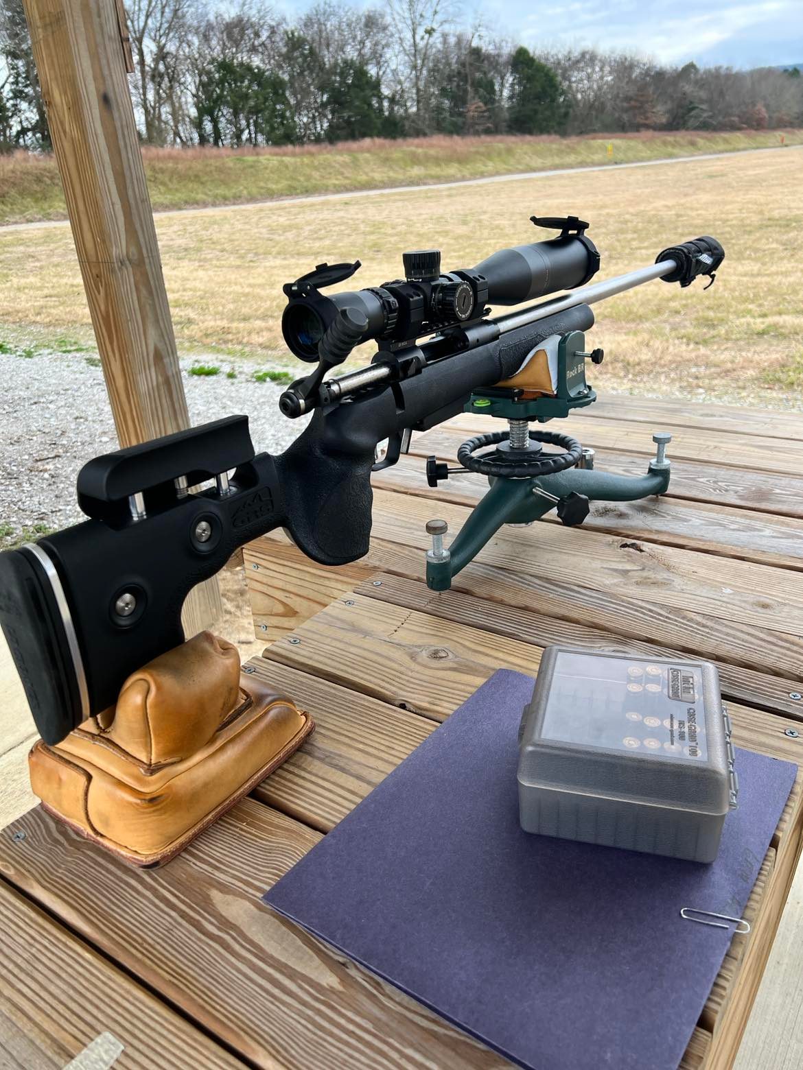

Here's the rifle - damn thing shoots! A 40-round target in 3-shot groups (with one Fup!) is below as well - the red grid on the target is made up of .25-inch squares.

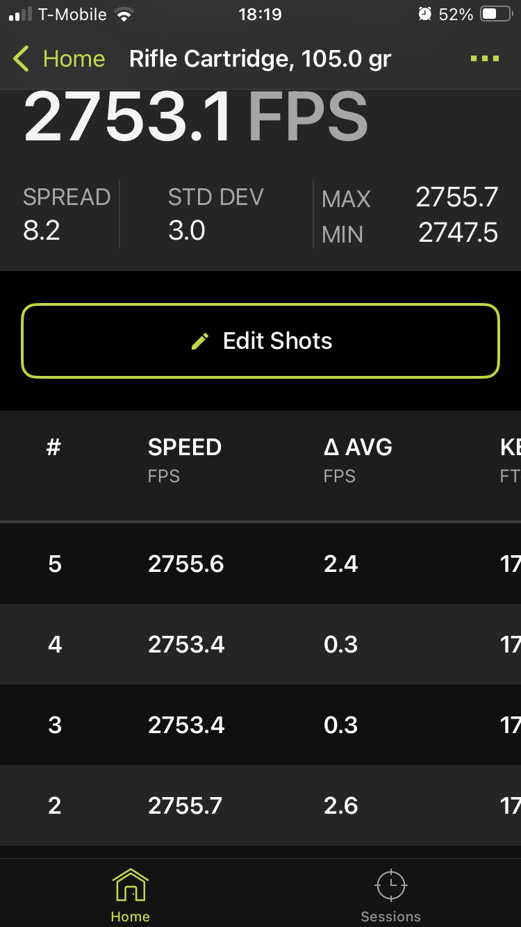

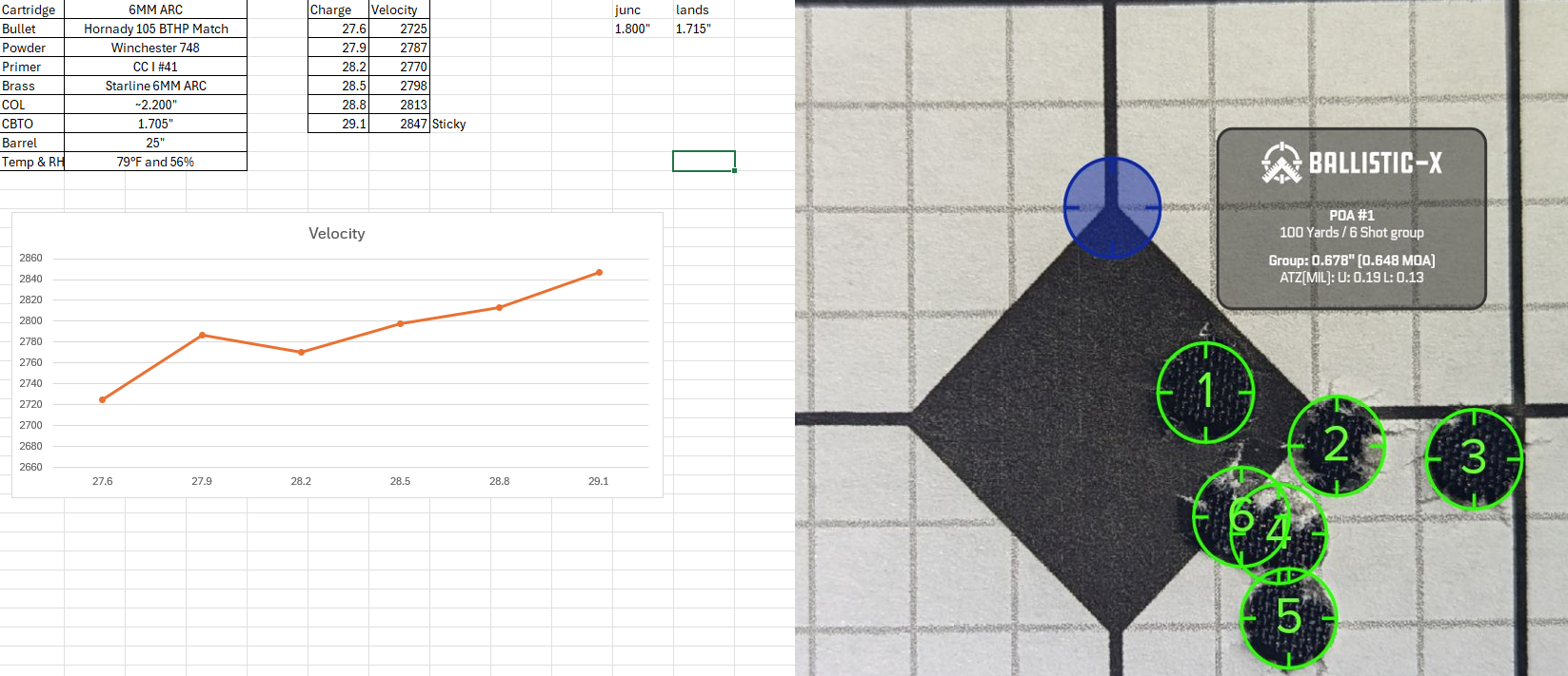

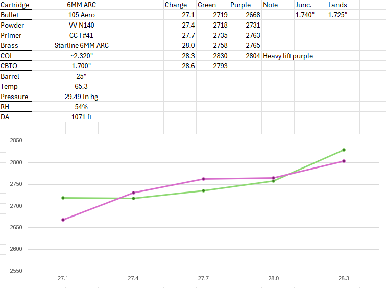

I get 2750 with Hornady 105, Starline, CCI #41 and W748 out of 25" and I've got some headroom. With slower burning powder like BL-(C)2 or CFE223, and a 26" it would be no problem. Shouldn't be a problem with StaBall Match either.

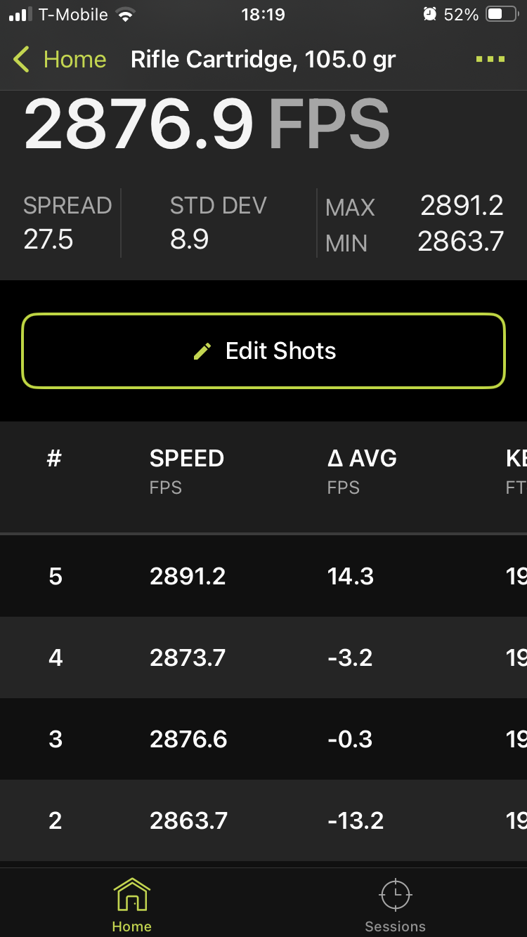

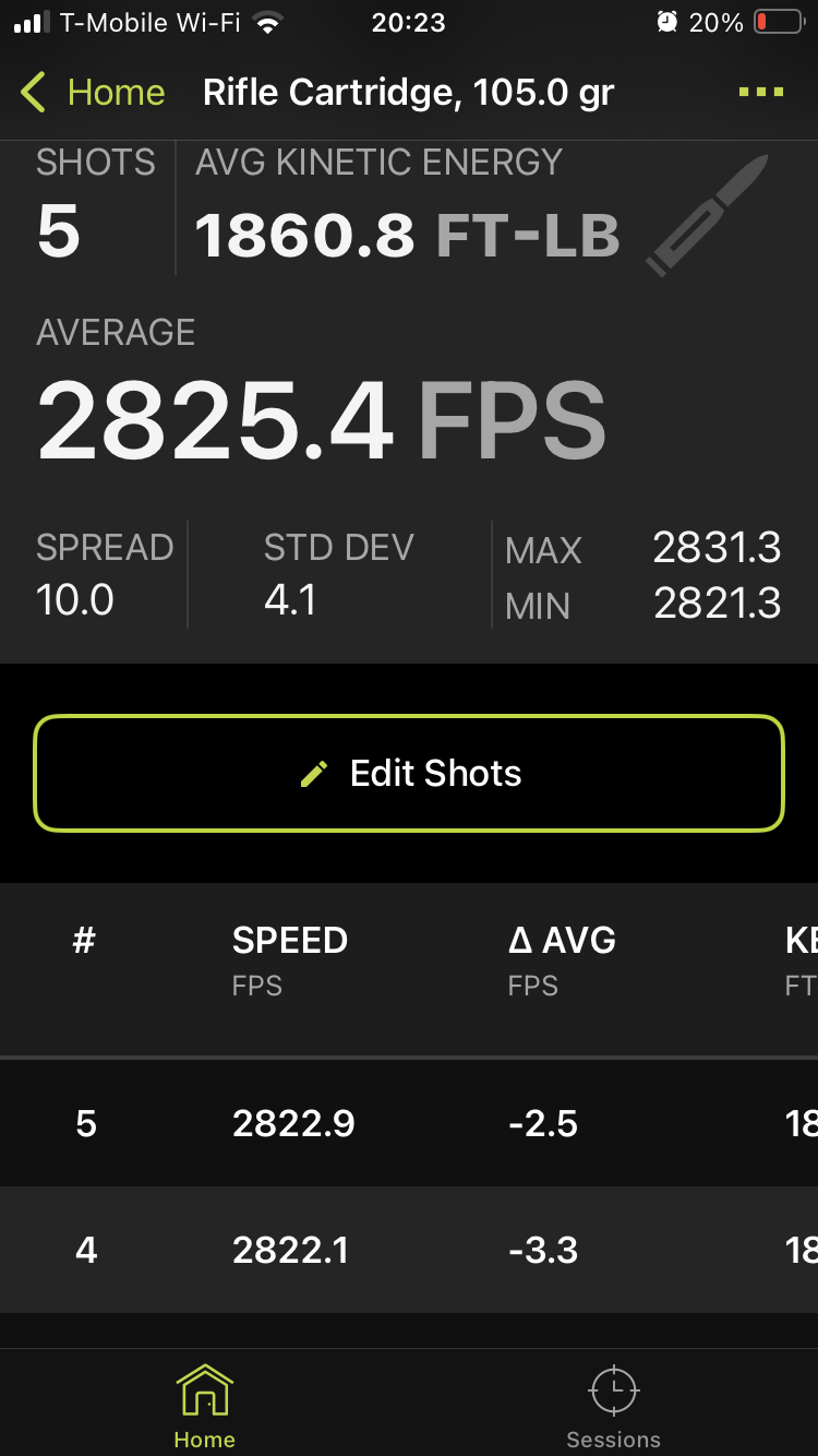

First 39 rounds through a new Benchmark 1:7t 26" looks like StaBALL Match may have some potential. Was getting compression on new Alpha at 28.5 & 29 grains but I'm also jumping about .055" so less jump or once fired brass may change that a touch.
Factory Hornady 108 ELD lot#3244067
2740 avg 14.1sd (very first 10 rounds fired through barrel)
StaBALL Match & 105 Hornady Aero Match bullet:
27.5 = 2572.8 SD 13.4 (5 shots)
28.0 = 2624.2 SD 6.4 (5 shots)
28.5 = 2661.4 SD 6.4 (10 shots)
29.0 = 2701.1 SD 6.9 (9 shots)
I don't quite understand how factory ammo is loaded on the max velocity end of the spectrum. All their load data is way slower than they load their own ammo. I've noticed this with 6arc and 22arc Hornady ammo.

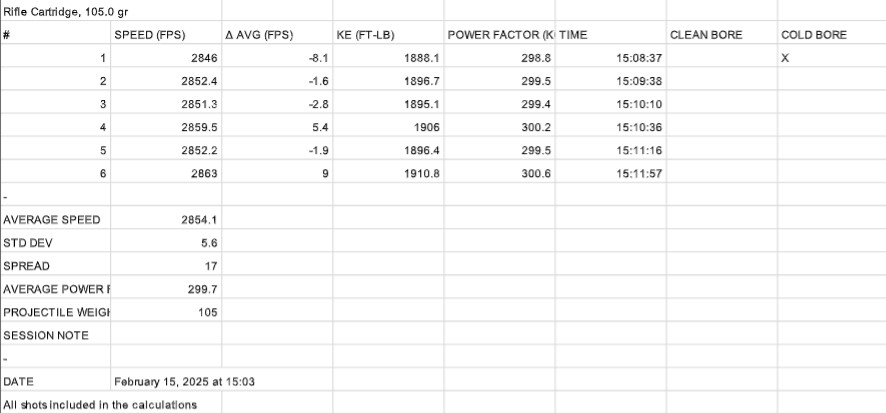

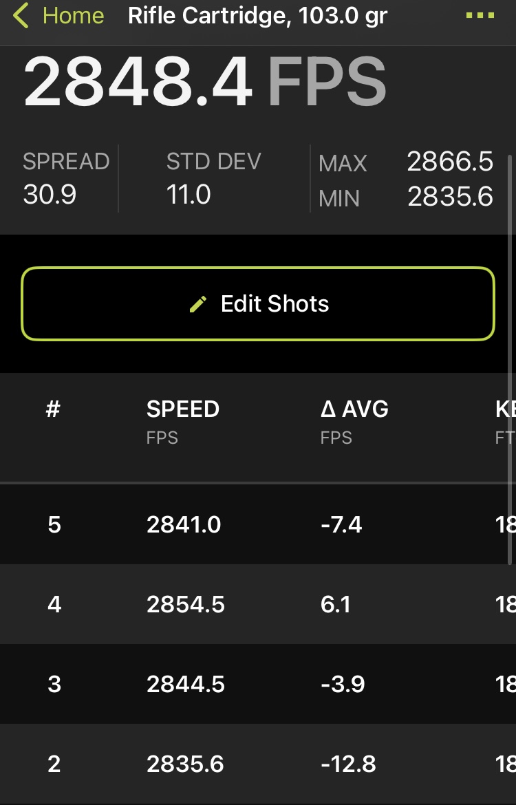

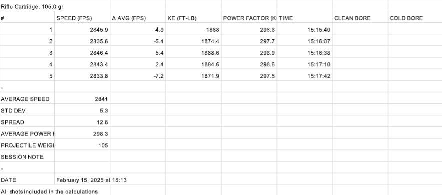

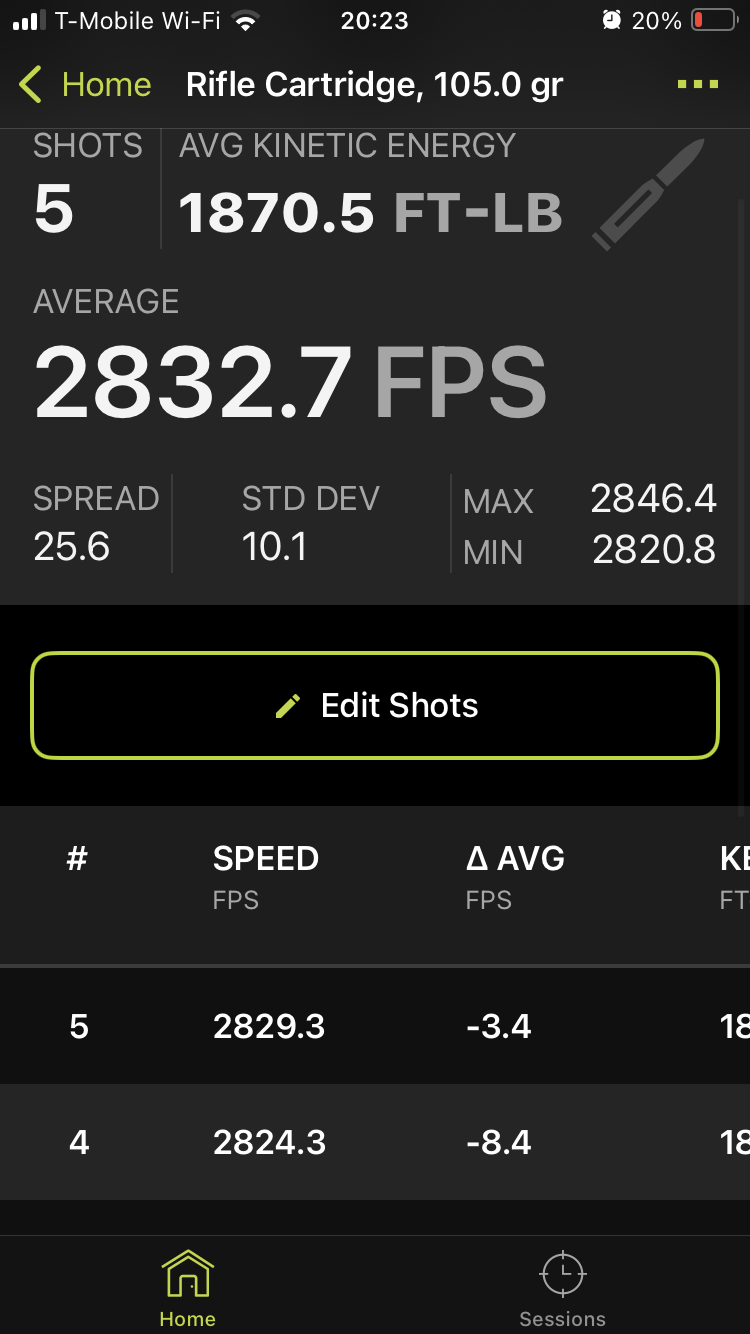

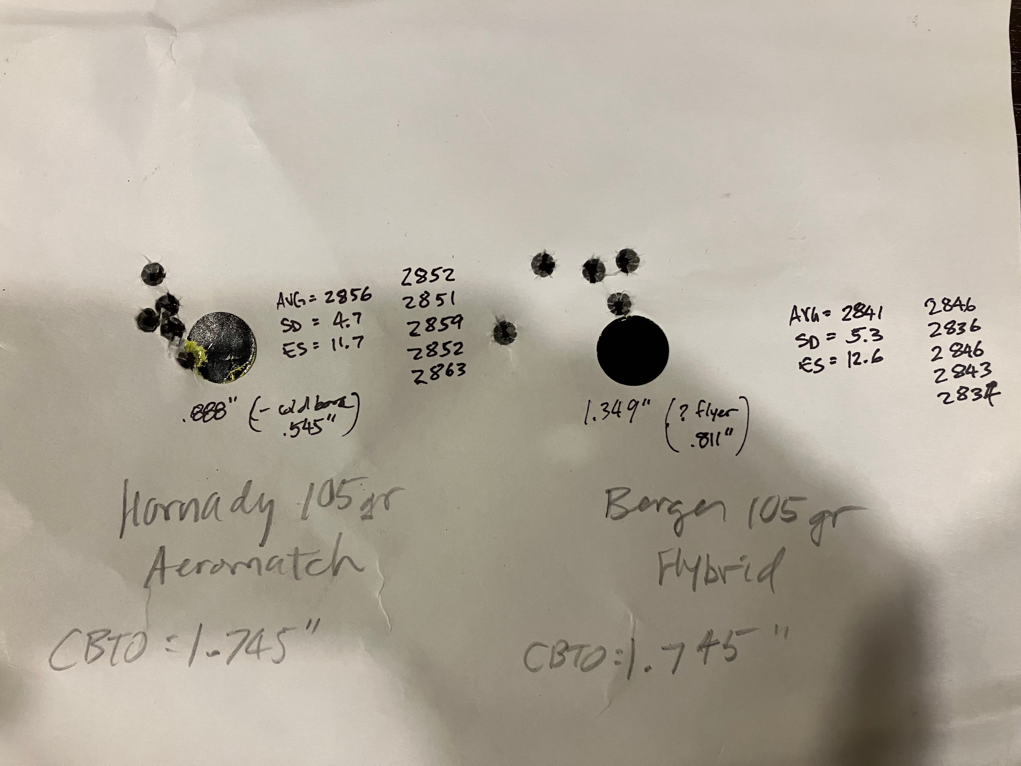

6 ARC bolt reloading update, 2/15/2025
40deg F, drizzle, 3-5 MPH from 8 o'clock, DA 1000'

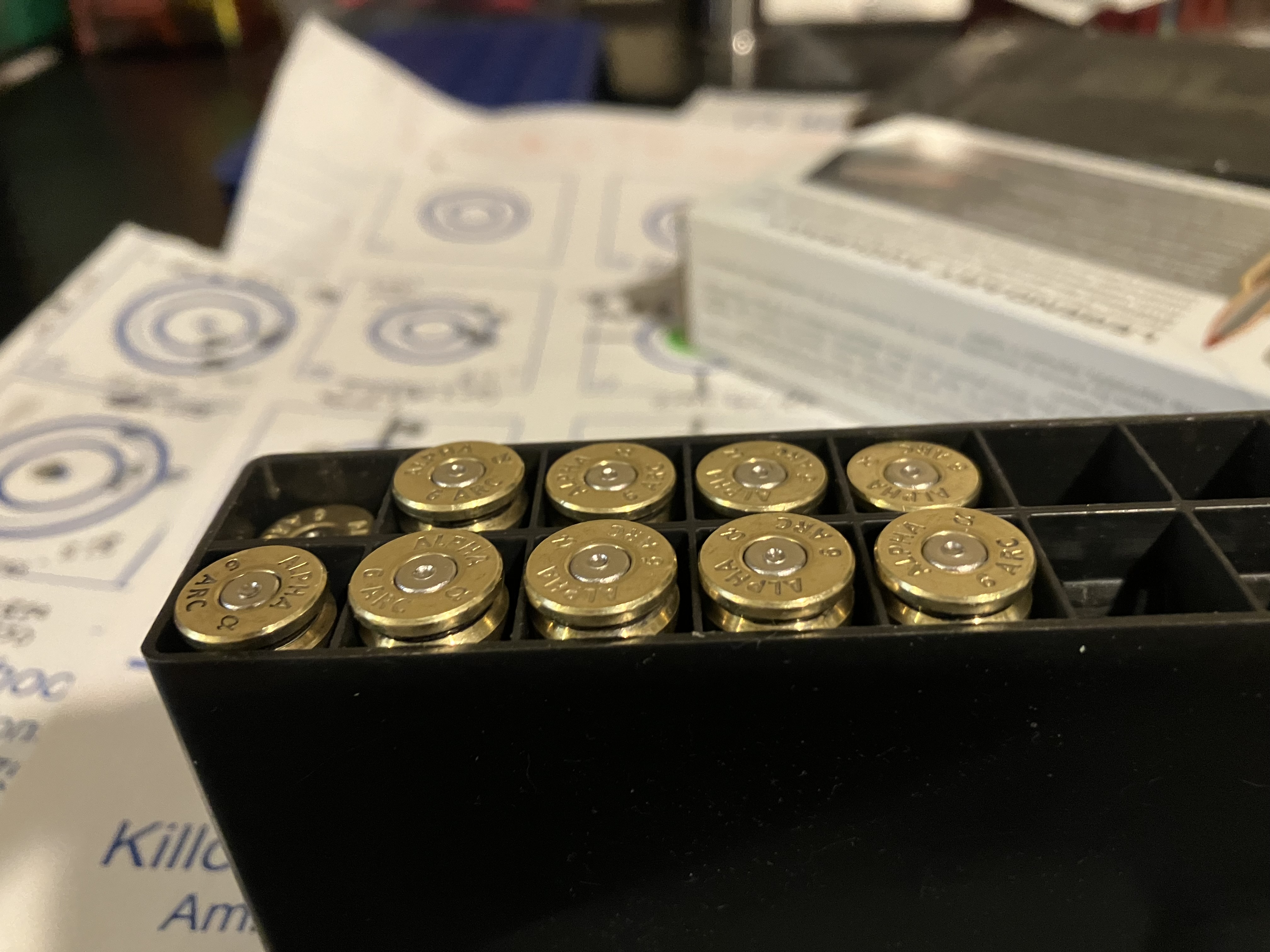

Rifle: 26" Criterion Barrel MTU, Silencer Co Muzzle Brake, Savage SA w/.442" bolt head, MDT 6 ARC mag, Athlon Ares ETR 4.5-30x56, MDT LSS XL2
Cartridge: new Alpha OCD brass, CCI 400 small rifle primer, Winchester Staball Match, Hornady 105gr Aeromatch and Berger 105gr Hybrid Target
CBTO: 1.745" Case Datum: 1.484" Loaded .005" off lands.
Moderate cratering, no ejector smears, easy bolt lift, post firing measure Case Datum: 1.487" (+0.003")
Aeromatch 105gr 6 shot group = 2854 fps, SD 5.6, ES 17 (5 shot excluding cold bore: 2856 fps, SD 4.7 ES 11.7)
Hybrid Target 105gr 5 shot group = 2844 fps, SD 5.3, ES 12.6
Excellent SD and ES for 5 shot groups. Aeromatch and Hybrid Target are almost the same dimensions and nearly the same speed.
Will back off .2 or .3 grains and test seating depth.
I wonder if the barrel sped up some, now at 90 rounds

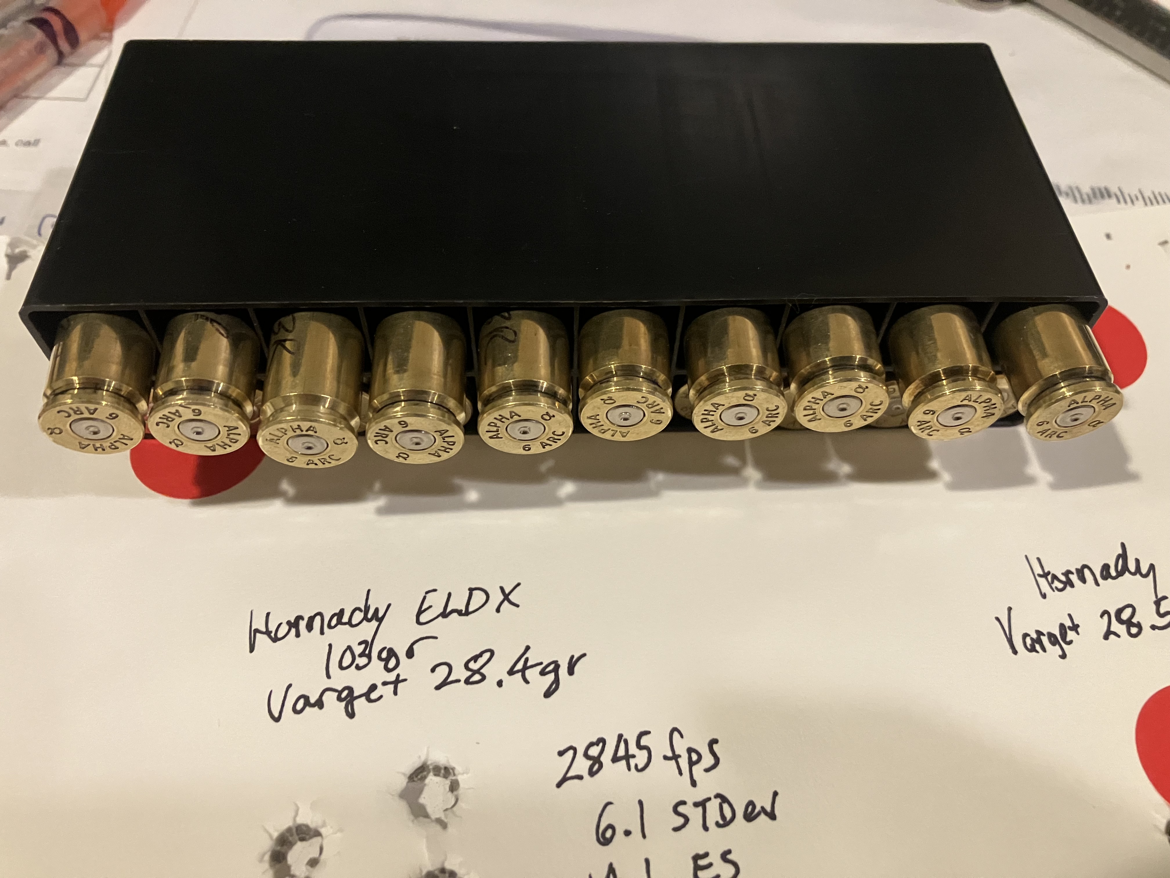

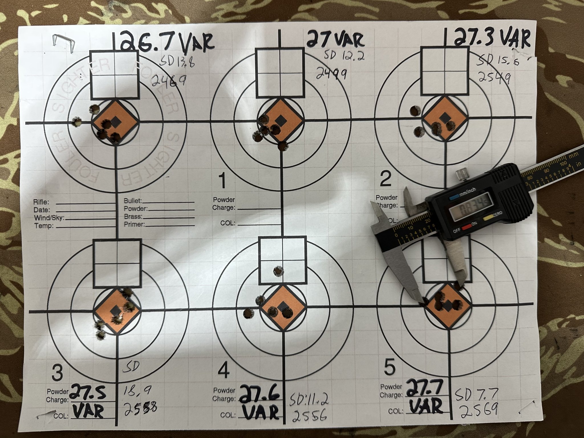

I'm finding that Varget slightly compressed groups better than Staball Match. Varget loads pierced primers above 2800 fps and Staball Match got up to 2860s with moderate primer cratering but no pierced primer.
Purchased an arbor press with an LE Wilson die for final seating depth testing.
Overall the 6 ARC load dev has been much more finicky than 6.5 CM, but it is so pleasant to shoot and it is so efficient with powder and barrel life, that I don't mind the chase.
Target goal: 0.5 MOA or better, with 2800 fps with temp insensitive power... so tantalizingly close!
Stay tuned and cheers!

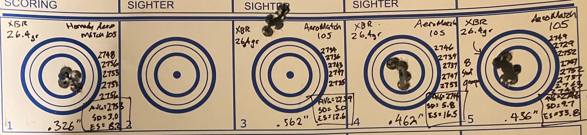

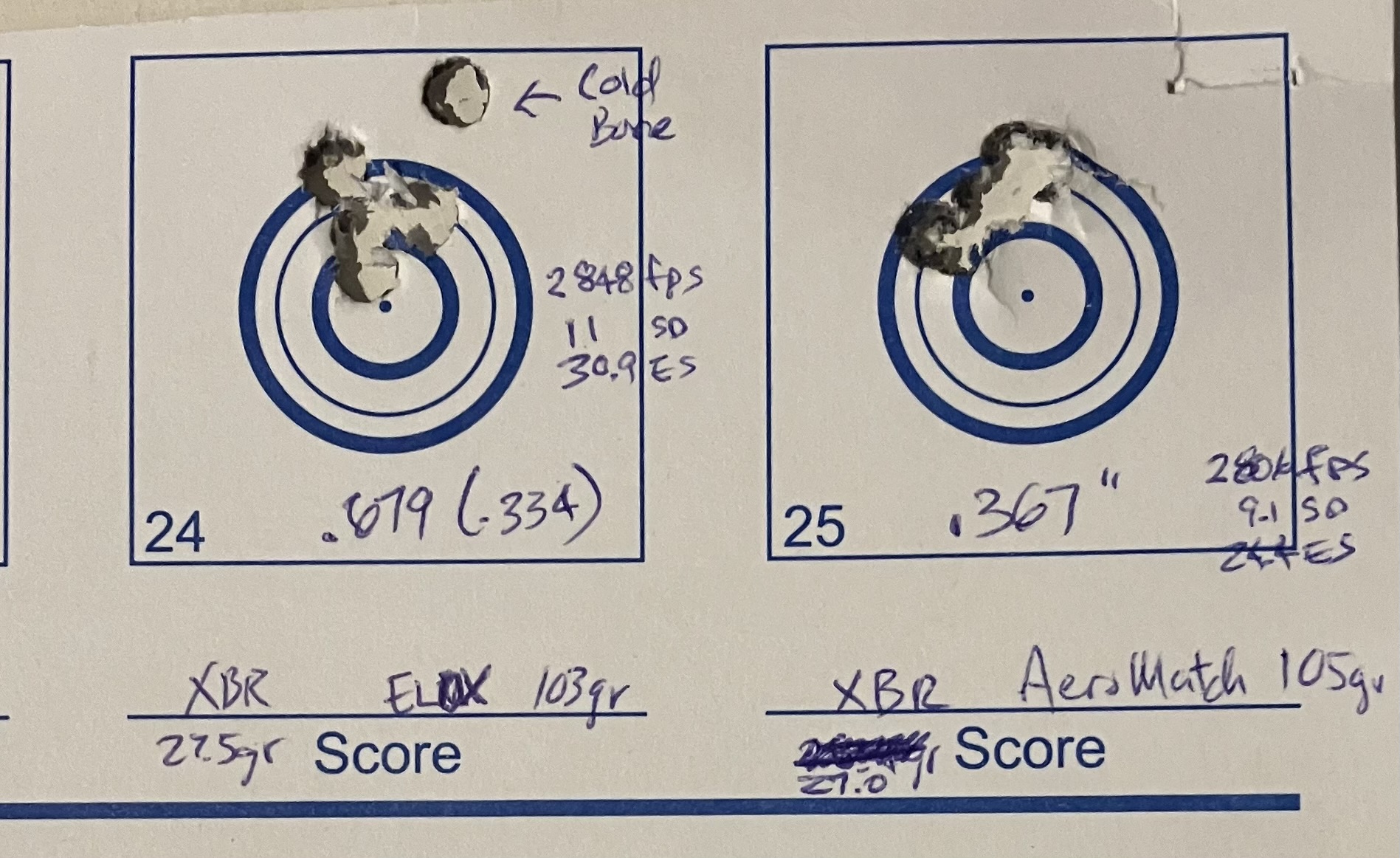

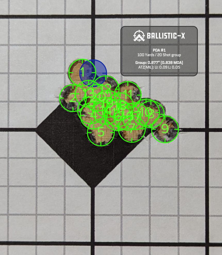

Here's a ladder with XBR I shot with shots 1-7 making a nice group through a range of 1.8 gr and 252 fps.
8 and 9 were outliers, but near the speed.
More testing soon coming with different powders.

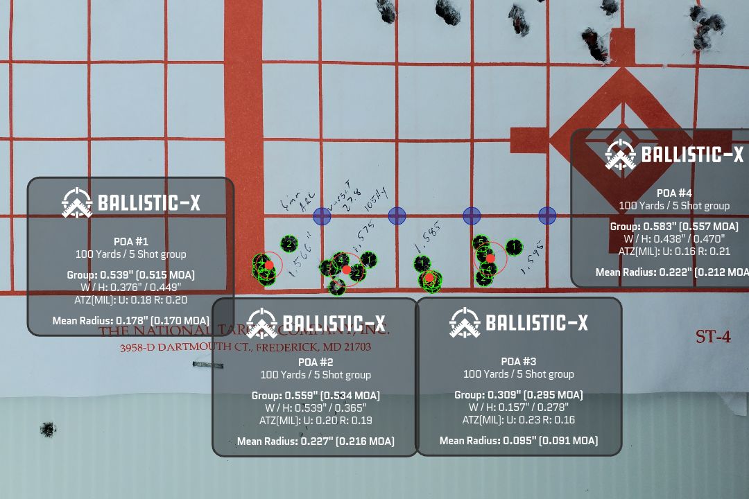

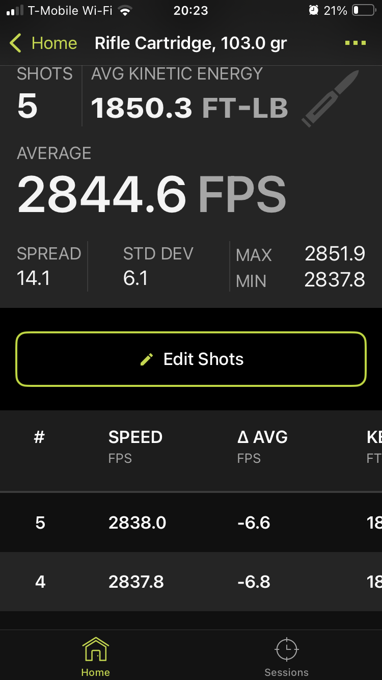

This has been an interesting journey and I am nearing my goal of 6 ARC bolt load development for PRS style shooting.
Build Goal: 0.5 MOA or better at 100 yards with 103-108gr bullet going 2830-2850 fps using temp insensitive powder.
Some valuable lessons I've learned along the way:
1. Some rifle actions do not play well with small rifle primers. Mass produced actions tend to have larger tolerances. Between different primer hardness/thickness, firing pin hole diameter, and what the shooter is trying to achieve with speed/pressure, some mass produced actions may work fine with SRP, some may blow primers without other pressure signs.
2. A well designed, squared up action will provide consistency and ease of working up a load by showing gradual signs of pressure increase. Think of it as a rheostat where the signs are early, consistent and gradual rather than an on-off switch.
3. My Go gauge vs No-Go gauge had a difference of 0.004". This may be standard in gas guns but I think that the extra tolerance in the headspace was contributing to more primer metal flow and pierced primers. When I set my headspace on the new action, I used the Go gauge and added 2 layers of Scotch tape with the edges trimmed off with a razor blade. This method added 0.0025" to the overall length. What I see now is much less primer metal flow and the brass all are within 0.001" headspace from the mildest load to the 2870+ fps loads. The primer pockets are tight even with Hornady brass after 4 firings. The limited amount of headspace growth should theoretically slow down the progression of the case elongation and insipient case head separation.
4. Download and use Gordon's Reloading Tool for initial ladder development. The key here is finding the case volume of a fired and sized cartridge YOU are using. Don't go by what's listed on the website or what you find on the internet as the case and your chamber will all be different. In Gordon's Reloading Took, once the variables are entered correctly, my true speed was within 10 fps of predicted. This can also be further adjusted (similar to truing your BC in a Kestrel). I've noticed that older powders seemed to be a bit hotter than the new ones. Some speculate that older powders may have lost some of the moisture making it more energy dense per weight or it could be manufacturing tolerances. Whatever the case, the energy factor can be adjusted along with the ambient temperature in the tool to get a very close estimate of pressures and expected speed. Check out Little Crow Gunwork's video on how to use the tool in my previous post.
5. The 6 ARC is an extremely efficient cartridge. The barrel was just getting warm after a 10 shot string. I usually stopped after shooting 2 or 3 five-shot groups. The barrel stopped speeding up after approximately 280 rounds. YMMV as there are too many factors on barrel break-in, but mine is a 26" Criterion button cut stainless barrel, MTU contour, 1:7.5 twist using a Silencer Co ASR brake/suppressor mount. Great chambering, service, and price from Northland.
During this load development session:
Fired 58 shots, max string of fire was 10 shots practicing off props.
First chrono info is a mild load with XBR with excellent accuracy and low SD/ES but slow.

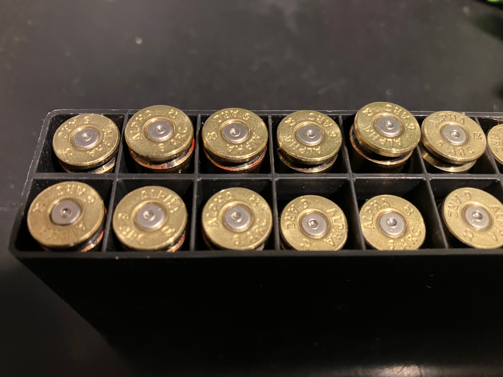

The second chrono info was to test max velocity/pressures with CFE 223, tight clusters with 1 outlier but the speed and SD/ES were very good.
The primers for the CFE 223 @ 2877 fps were slightly cratered and mildly flattened, but no ejector swipes, easy bolt lift.
The best 5 shot group today was the last group @ 2753 fps, SD 3, ES 8 and 0.326" center to center group in target #1.
Hopefully the next range session will have my 6 ARC load all sorted out at 2800-2835 fps shooting 0.4" or less.
YMMV, happy shooting

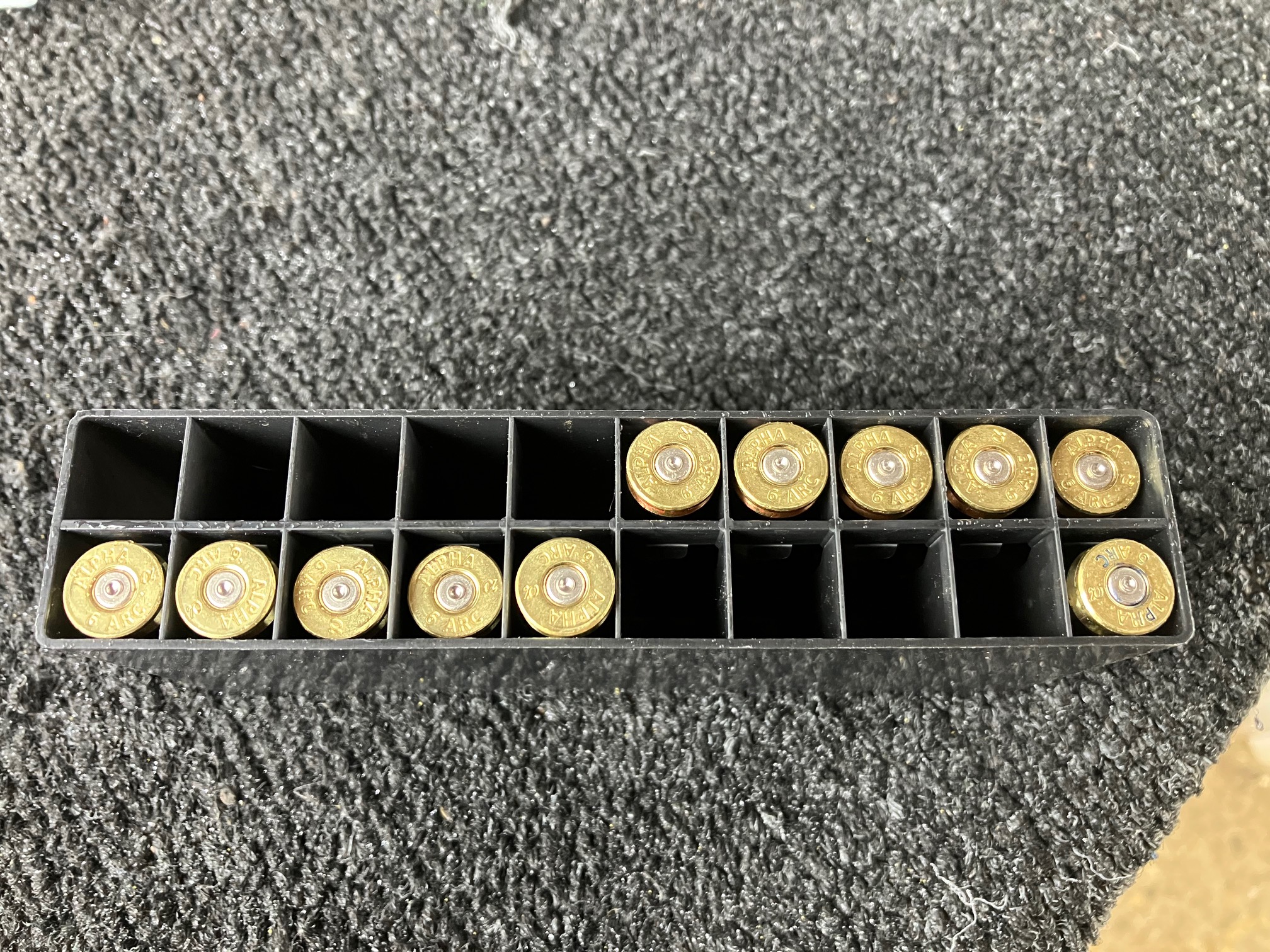

Recently switched to N140, think of it like Varget Short-Cut. Just the slightest bit of crunch. Ran 10 round loadings of this charge after running a pressure ladder. 2 different batches of brass, one with slightly less capacity, so I ended up backing off .10 gn for final load in that brass before a match. Chrono'd with Xero C1 Pro. 25" button barrel, SAAMI chamber.
105 Hornady Aeromatch
27.8 gn of VV N140 via RCBS Chargemaster 1500
Starline Brass - 2 different lots
CCI #41
CBTO 1.700" - Hornady Comparator
COL ~2.320"
Lot A - 9rds
Min: 2731.9 fps
Max: 2768.8 fps
Avg: 2752.8 fps
ES: 37.0 fps
SD: 9.4 fps
Lot B - 10rds
Min: 2746.3 fps
Max: 2782.1 fps
Avg: 2768.7 fps
ES: 35.7 fps
SD: 11.9 fps
*Load at your own risk*
Goal achieved. Both loads capable to 1000+ yds, very mild recoil, efficient, temp stable, groups well.
Many thanks to the Little Crow Gunworks YouTube videos on reloading.
I think that this is similar to the journey Frank is on with his podcast but with factory ammo. I had the pleasure of learning from him at Treadproof and brought up the idea of a bolt gun in 6 ARC as it was coming online in 2021, but I am a poor so it took a while to get it built up and load developed.
Anyways, here are the groups and data.
Temp 59F, Humidity 63%, 29.93 mm Hg
1. XBR 27.5gr, Hornady 103 ELDX, Alpha brass, CCI 450 SRP, .010” off lands, minimal crunch with seating
2. XBR 27.0gr, Hornady 105 Aeromatch, Alpha brass, CCI 450 SRP, .010” off lands, no crunch with seating
Minimal cratering, no shiny spots, easy bolt lift.
YMMV and happy shooting!

Appreciate all the inputs and help with my foray into 6 ARC bolt gun for PRS and long range steel shooting.
I think my barrel has stabilized, my brass prep tuned, and my load development ironed out.
My system likes 105 bullets with 27-28 grains of Varget or XBR at .010 - .030 jump.
So far, loving the efficiency and how soft it shoots.
Happy to answer any questions, YMMV and happy shooting
