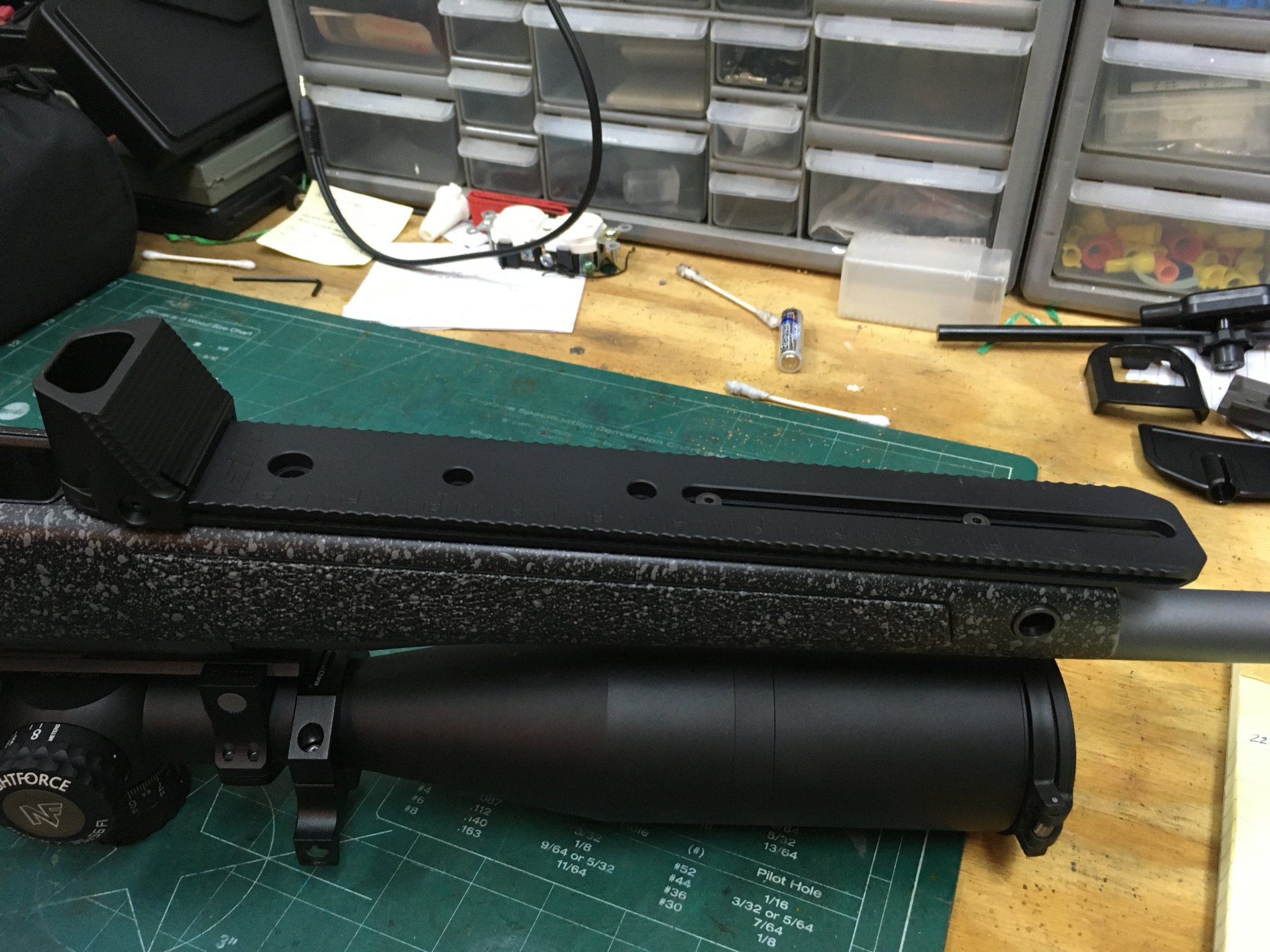

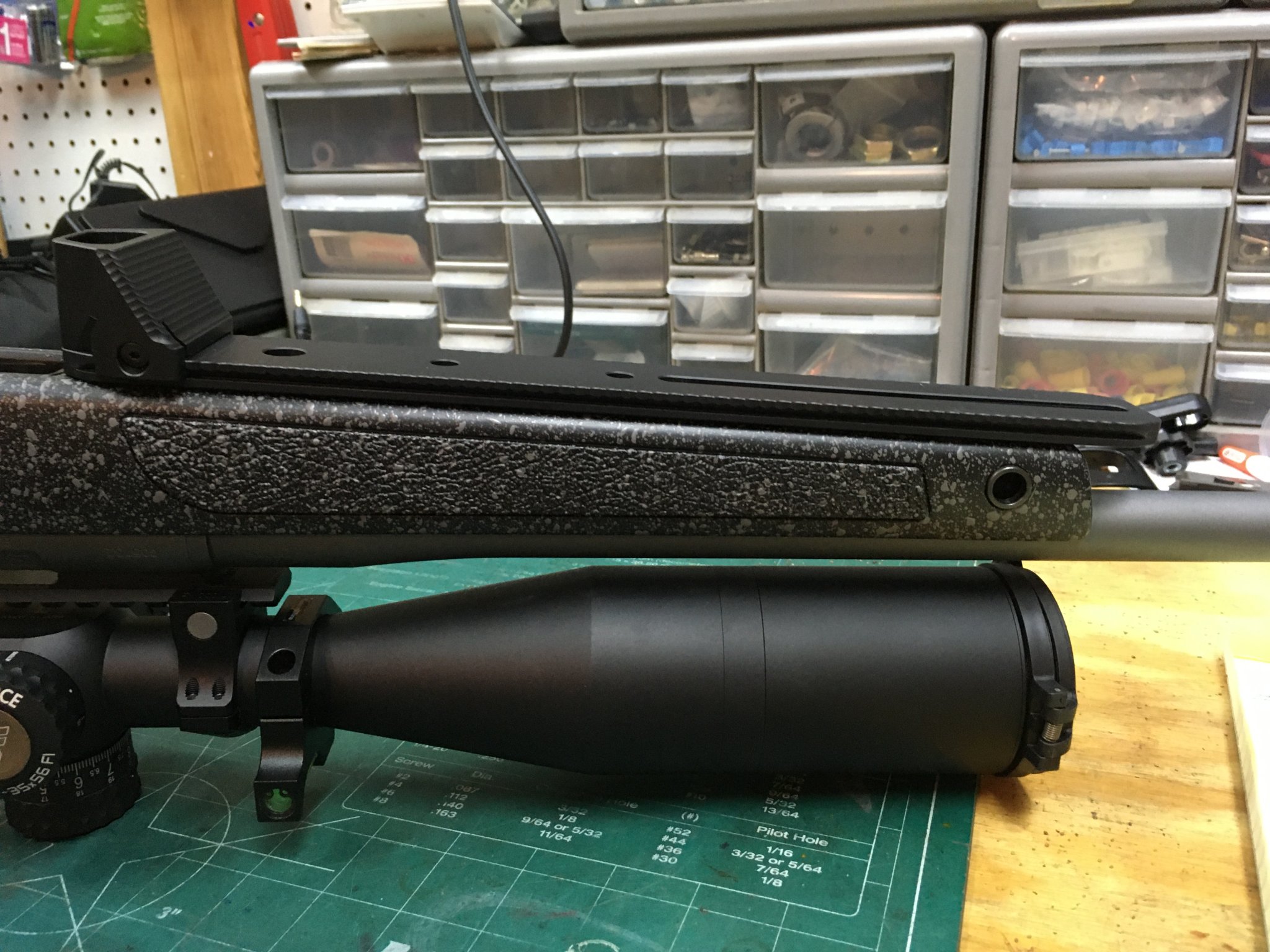

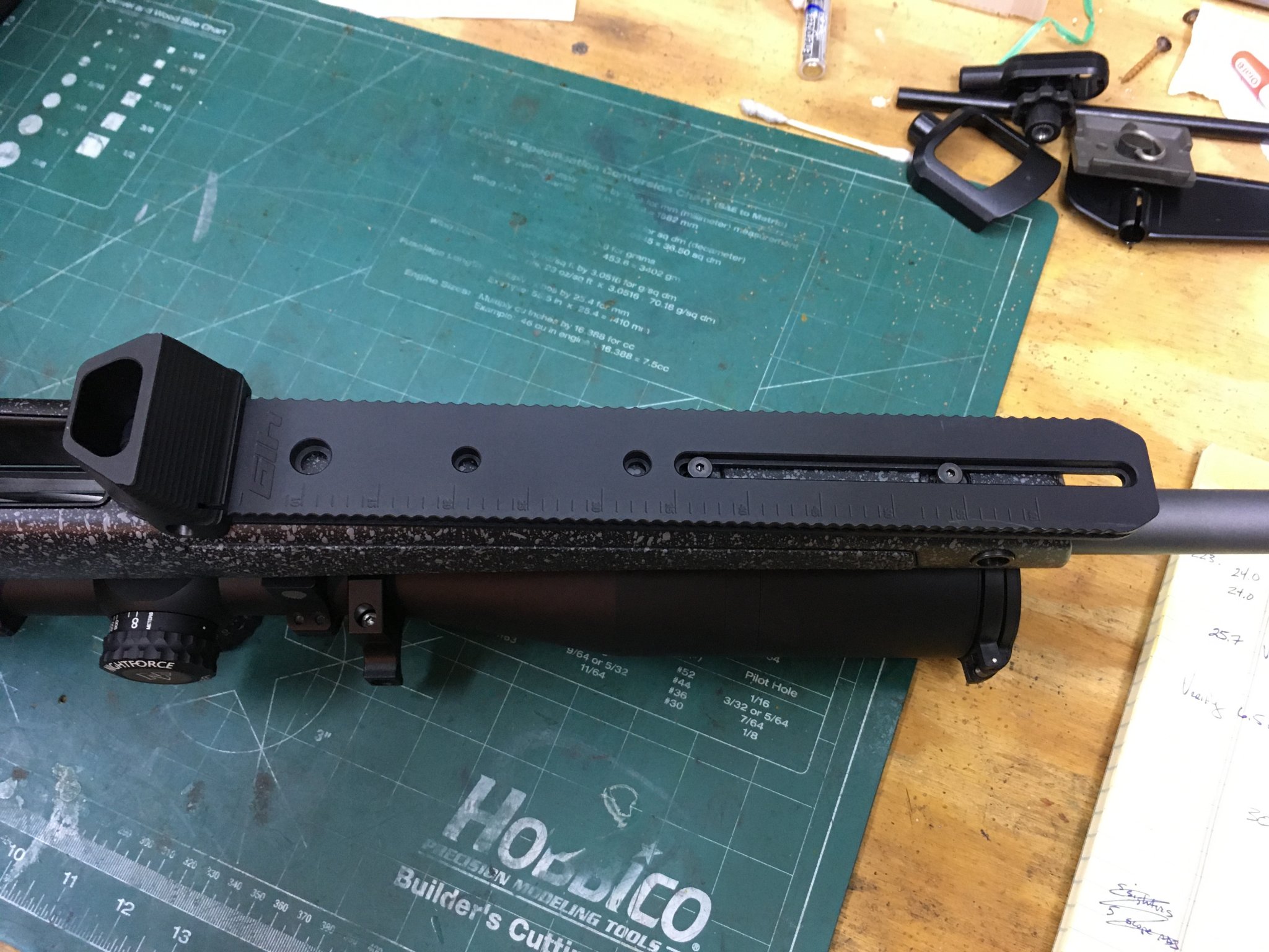

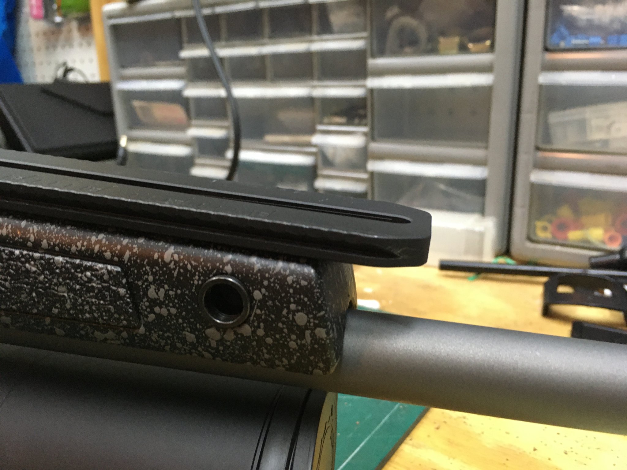

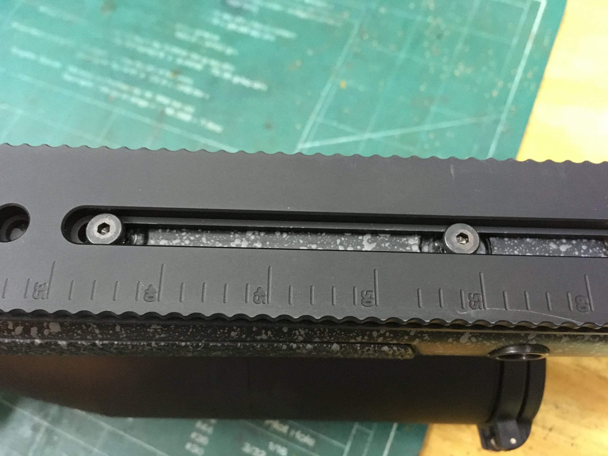

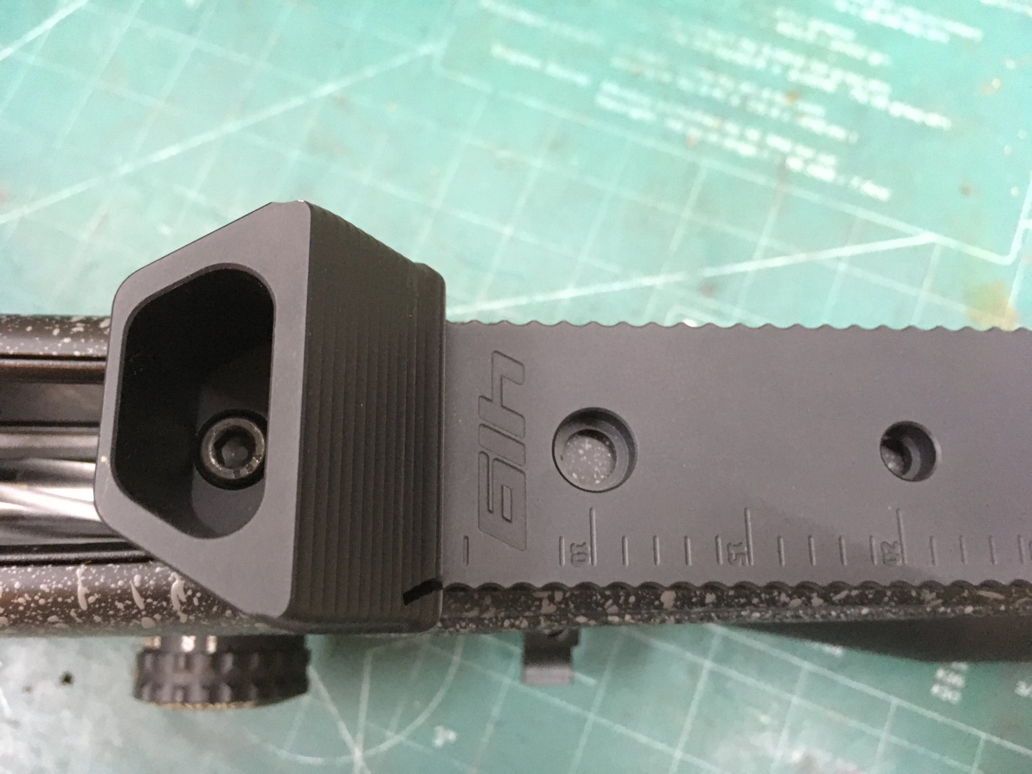

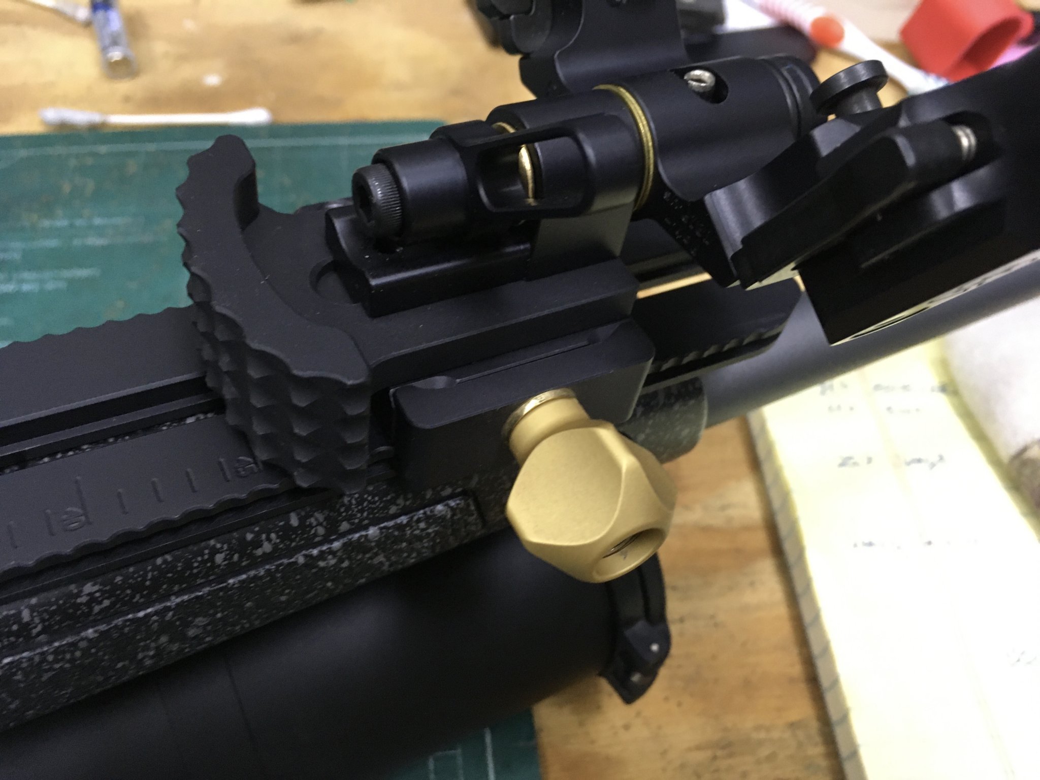

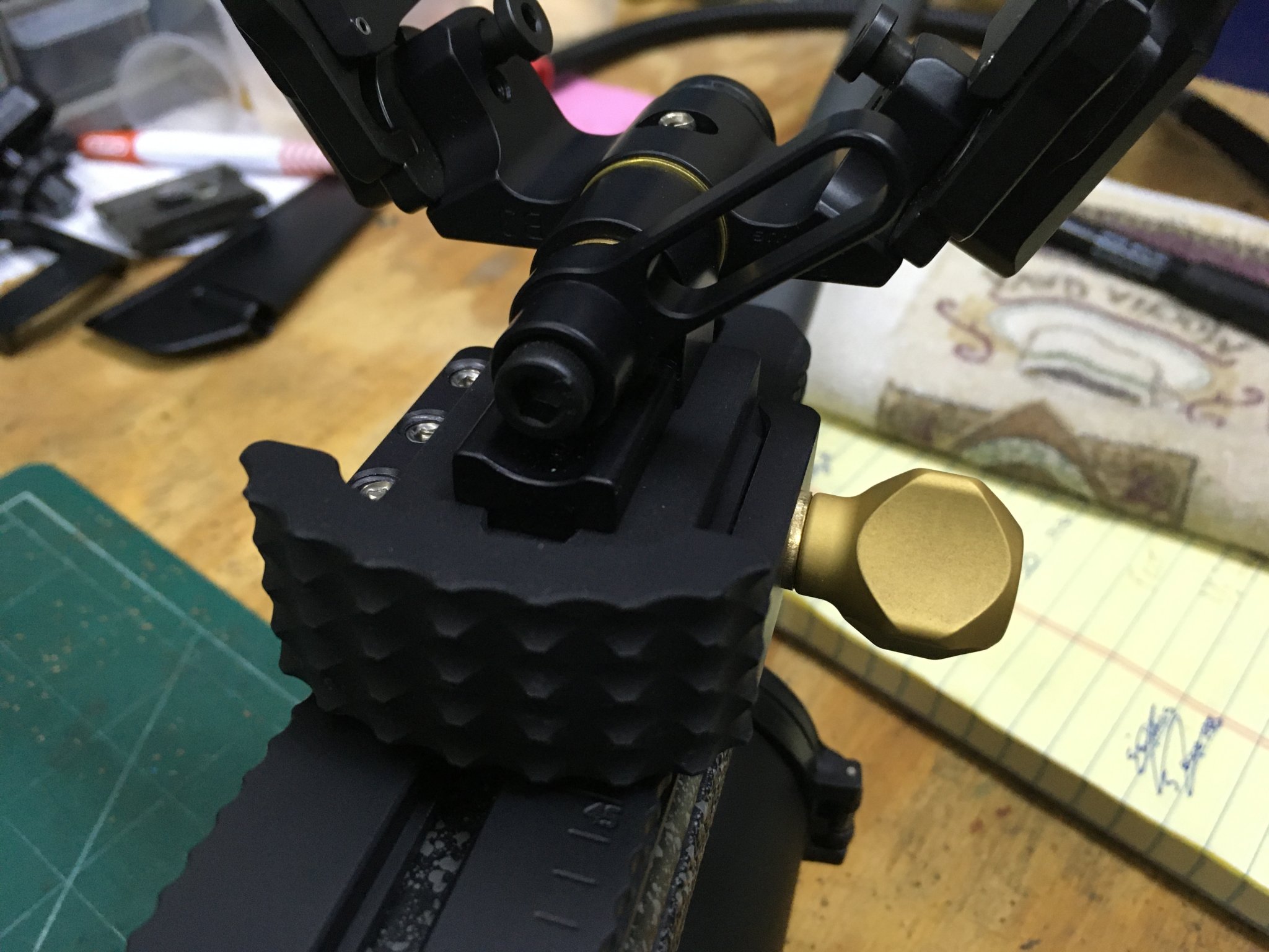

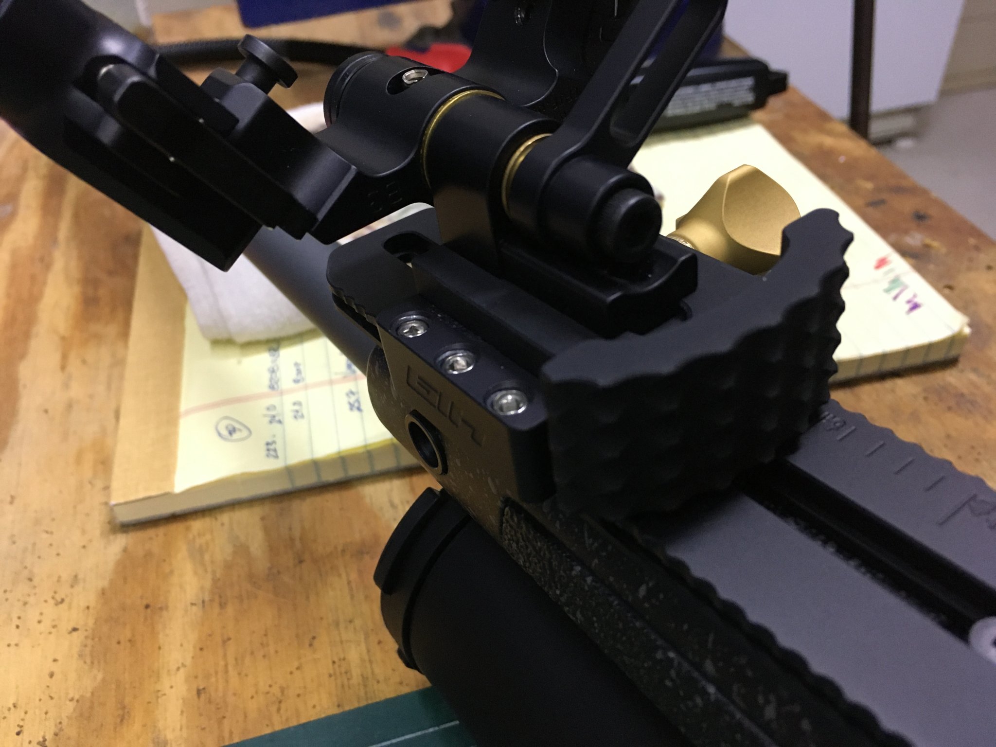

Two weeks ago I just installed the Area 419 Arca Rail kit they make on my 6.5 Premier Pro. I think I got the 12” version of the rail, I do know they make a 14” rail kit as well. The 12 rail protrudes about 1/4 of an inch forward of the front part of the stock if I remember correctly, currently I’m at work. When I get home in a few hours I’ll post a photo for you.
the only thing I had to do to make the kit “work” was to cut down the replacement forward action screw they provide, the screw will be to long and will enter the action lug area. Just a quick zip with the dremel cut off wheel and the screw is the correct size. You will then also use the replacement screws they provide and pick up the two holes for the two sling swivel holes already in the stock. The rail kit bolts one with just the forward action screw and the two sling swivel holes..... they also provide additional screws and t-nuts if you want to pickup the additional holes in the rail, and transfer new holes to the stock by drilling..... just use the forward action screw and the two sling swivel holes and you'll be good togo!
it’s a really nice kit, you will enjoy it, very high quality. If you want the bipod to be mounted out front (or more forward) of the stock, then the longer 14” rail would be your bet.
Photos in a few hours!
all the best,
Jeff
Reactions: flyer1a
Ok as promised, some photos! :p
12" Arca Rail Kit from Area419 ....... Installed on the Bergara Premier Pro HMR in 6.5 Creedmoor....
Hope this helps!
All the best,
Jeff

So does the CKYE pod attach directly with the front barricade portion of the rail system? or will an adapter be needed? or does the front barricade need to be removed and then slide on bipod?
Afternoon,
I don't have the CKYE POD so I can't comment. I do have the Thunderbeast bi-pod.... I ordered the TB without a mount, the TB bi-pod just mounts / bolts directly to the front movable ARCALOC CLAMP & BARRICADE STOP.
I do know if you want to run a Harris bi-pod you'll need both of the following.
and
Hopefully someone with a CKYE POD will chime in for you.
All the best,
Jeff
