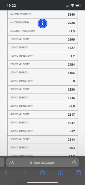

What range does the 87g shoot?
Straight from hornadys website.
  • Love
Reactions: Benaj
