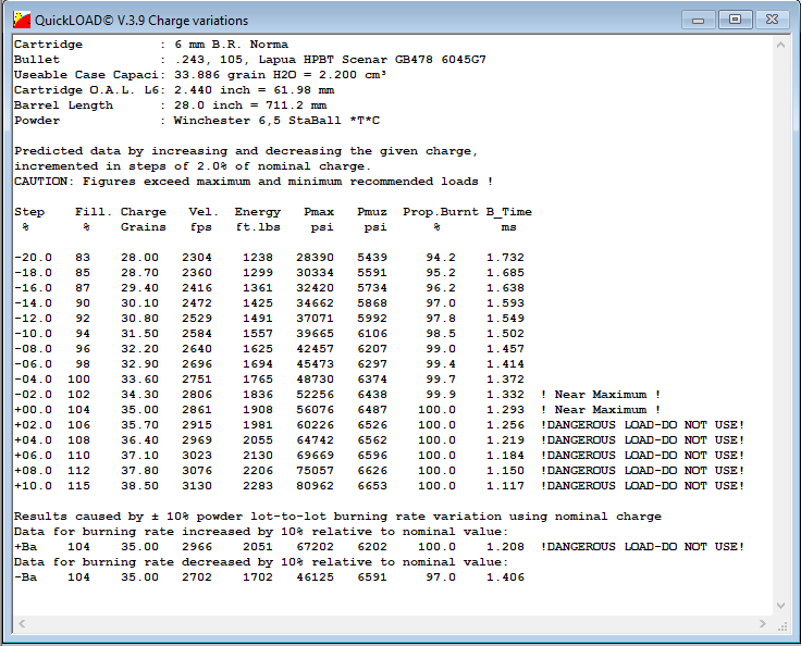

Here's the numbers using the 105 Scenar GB478.
It looks like the StaBall issue is "Fill Percentage" ... but it might still work, as I've found that calculation is done inferring the space the bullet uses.
Anyway ... build yourself a ladder test starting around 33.0 and going to 35.0 ... and see how it shoots. I've actually gone a bit above the "Danger Zone" looking for pressure signs, and gotten good results (as long as you do it in little steps like 0.2gr).
Hope this helps.
Hope this helps.

My only argument with that, is that if you have the QuickLoad data, you can start safely at a higher velocity and save a lot of reloading supplies shooting at lower velocities that you really don't need to test. The QL info I sent indicates a 33.0 start is very reasonable. I would agree with your advice if I had no data and was just "spit-balling" my first loads. To each his own. Just my humble opinion ... in a time of constrained supplies.
