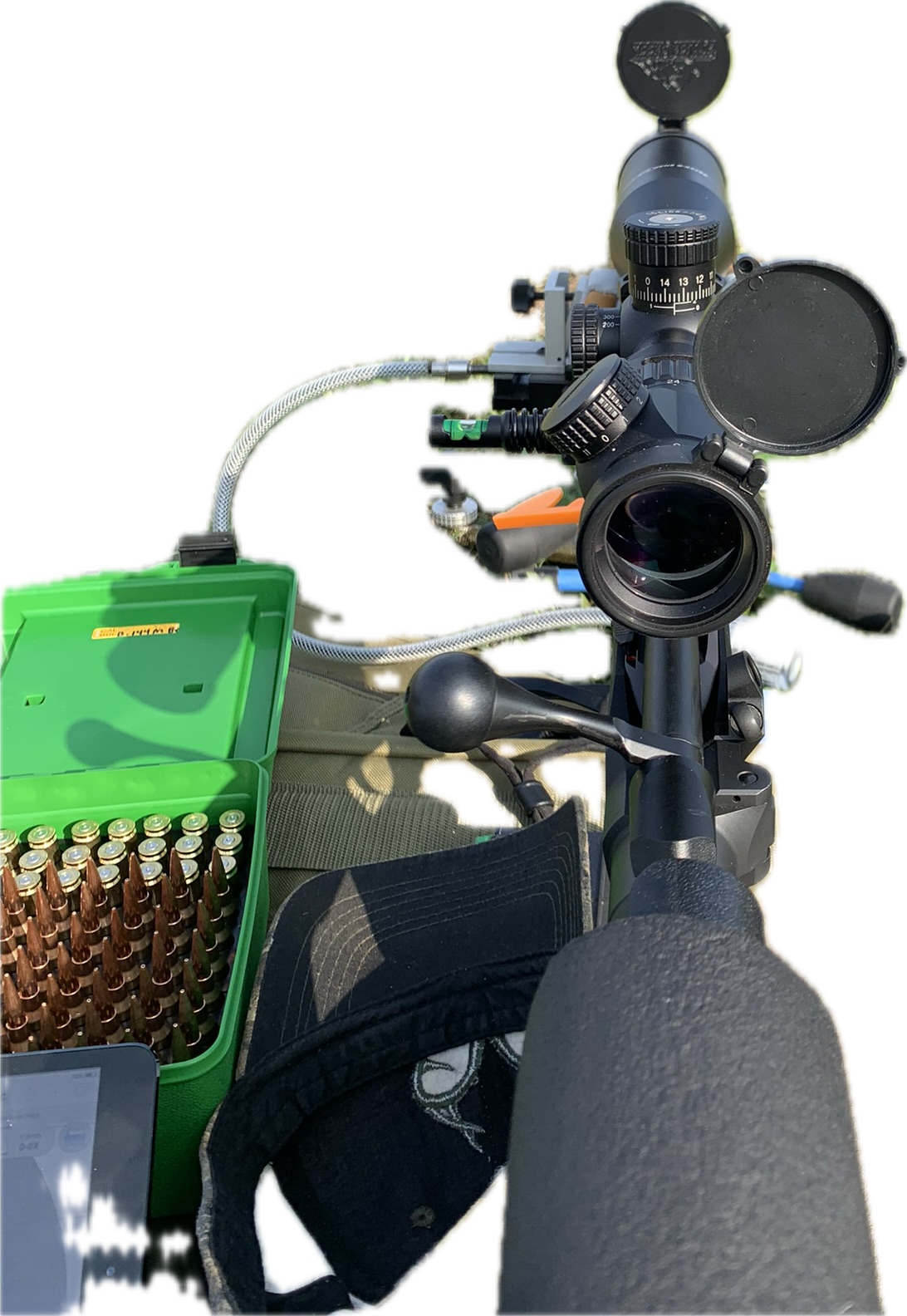

What kind of matches and what kind of accuracy are you getting out of your rifle? Are you shooting factory barrel?
Currently it is the factory barrel. Shoot 600 yard prone. Using a Bald Eagle with precision top. Berger 140 hybrid Lapua brass…Protector Rear bag.
