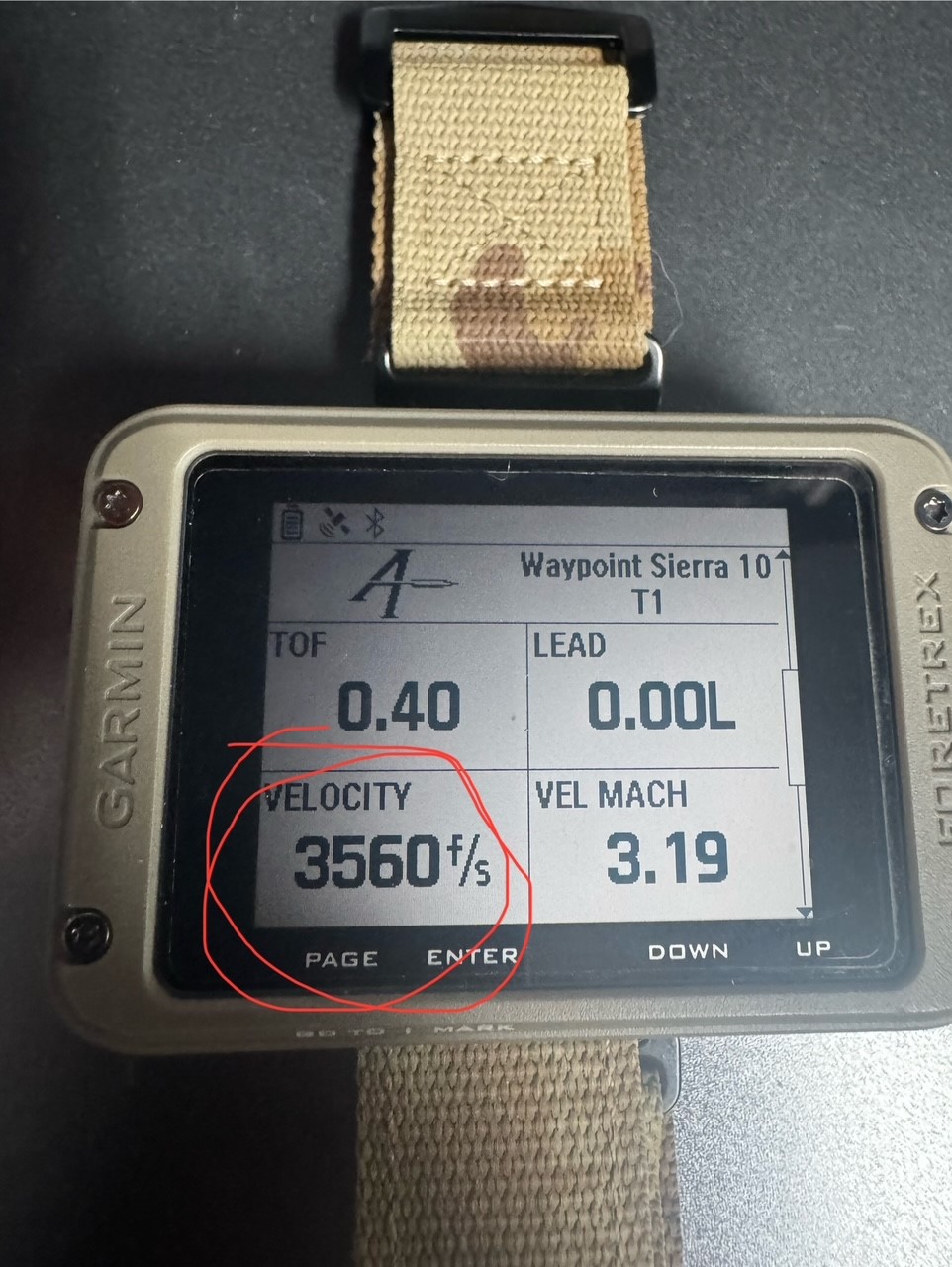

Need Garmin 901 help
BeteNoire
Apr 2, 2009
120
54
53
I just updated FW on my 901 and now the velocity of my gun profiles is all weirdly high and goes up instead of down as I change range. MV of the profile in this pic is 2865 and as I increase range, the velocity of this field keeps increasing. Any ideas? Nuc it all and start over or ??
Confirmed that the Garmin software is working, but my gun profile got corrupted during the firmware update process. I deleted and rebuilt the gun profiles and now the velocity updates as expected. I should try to download profiles from the cloud backup and see if they are okay too. Might not have had to rebuild from scratch.
