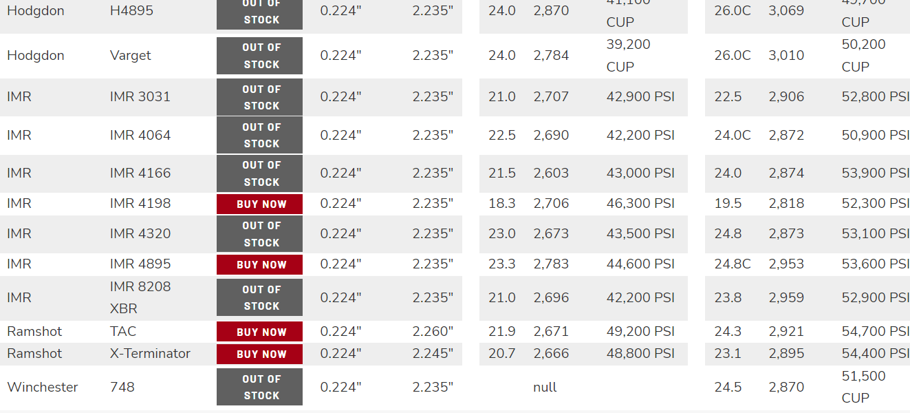

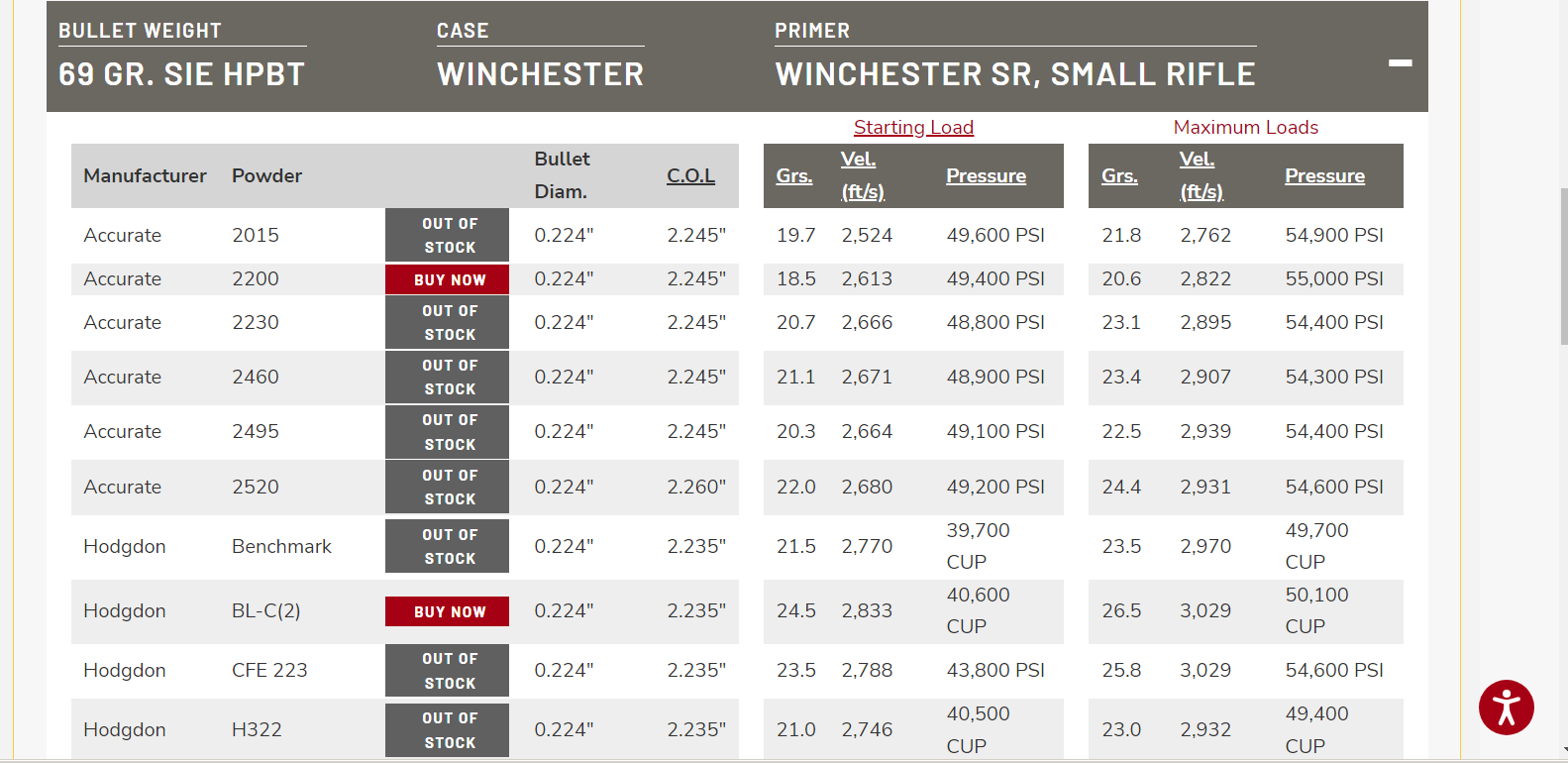

Hi All,
I’m going to get into reloading sometime in the future. The calibers I want to load are 6.5 CM and .223 (accurate loads for p-dogs and targets, not mag dumps). My plan is to start buying primers and powder as I am able and then pick up the components and bullets later.
From what I’ve gathered I should be looking for H4350 and something like a CCI 200 or BR2 for 6.5 CM. Most of what I’m seeing agrees on these - I just wanted to confirm this with you guys given your experience.
I’m having a little more trouble with the .223. I know it uses small rifle primers, but the powders in the loads I’ve seen are all over the map. Is there a powder that I should start with? I will be loading for target and p-dogs. The guns will be an 18” AR with a Wylde chamber the other will be a bolt .223. Any help on what powder would be good to start with would really be appreciated!
Thanks!

The .223 has endless choices for powders . Nobody can tell you what your rifle will like , Trial and error will . I shoot bolt .223/5.56 . I like H4895 ,4064, and other stick powders , some guys like spherical powder for ease of metering . Here is a quick shot of what the Hodgdon site listed for a 69 grain bullet, as you can see this will take some research.

Thanks! Tells me I wasn’t nuts thinking there seemed to be no “go-to” for .223 like there seems to be for 6.5 CM.
TAC is very good for 223 and I'd be very surprised if it didn't do well for anyone for 223. If I was going to get powder stocked up in preparation, that's what I'd get. As others said, it's best to see what bullet and powder works well for you, but TAC is a very safe bet for 223.
6.5staball and H4350 are also pretty safe bets for 6.5cm.

If you want a powder that works in both rifles there are many choices . These plus many other powders cover both ,depending on what bullet weights you will be shooting. H 4895, IMR 4064 ,BL-C(2), CFE 223 ,Varget, etc. .
