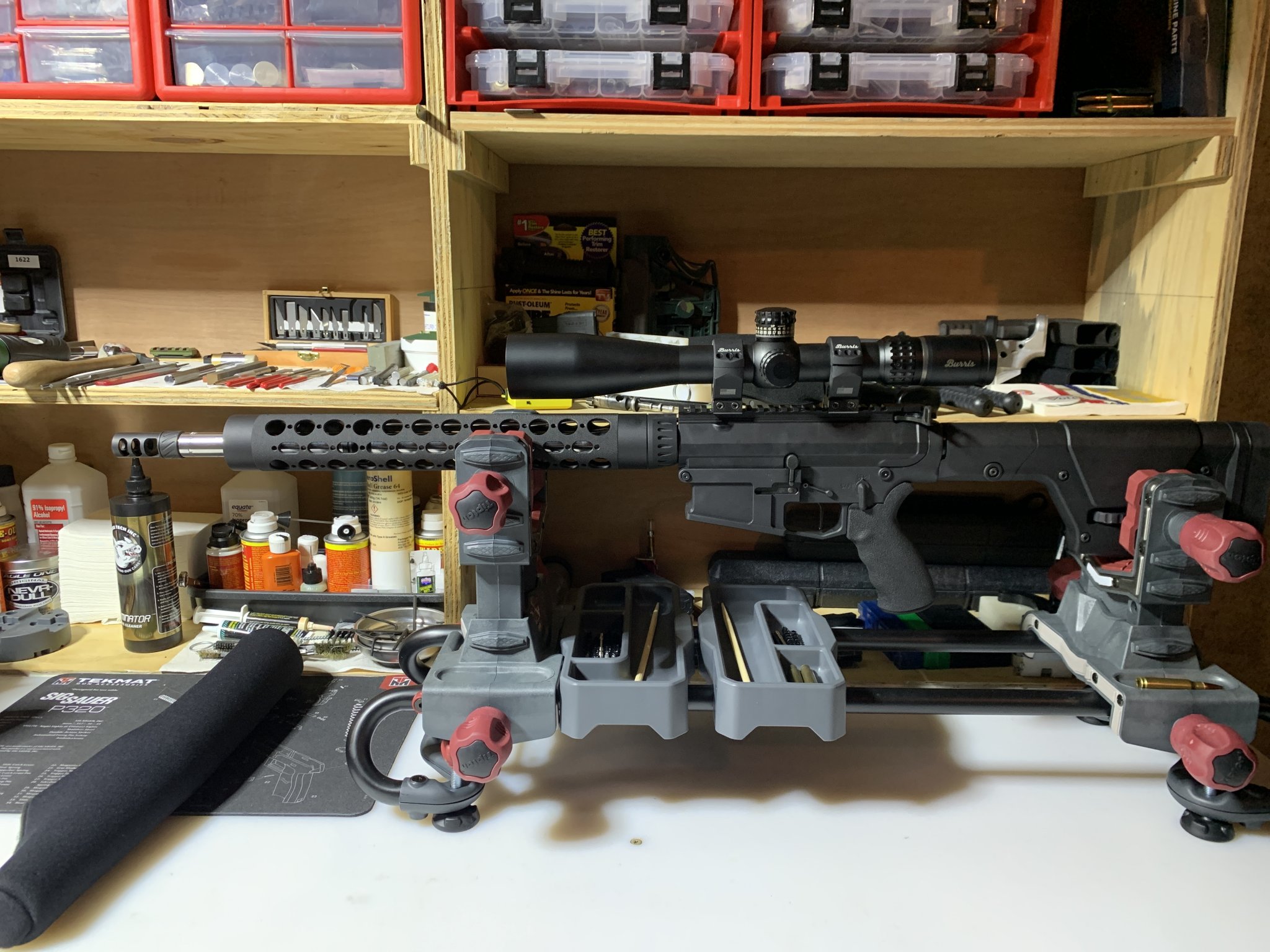

Here’s my craddock 18” Bart 308 w. A 15” jp mk3 handguard. I have the mk3 on several rifles very nice in my opinion.

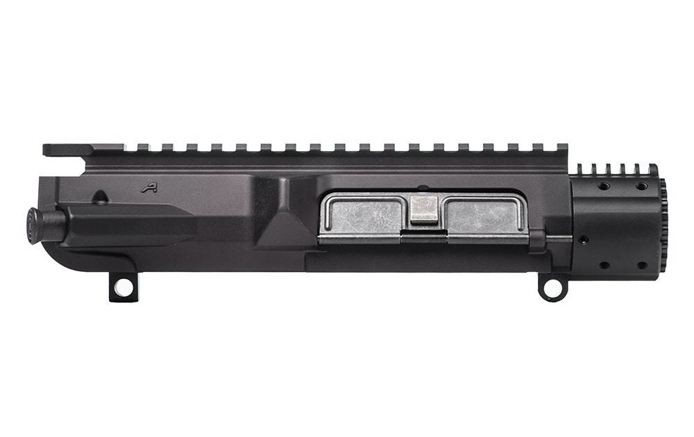

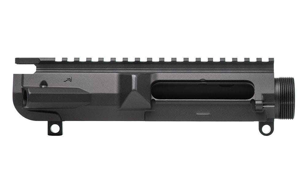

That's a very good point! To the original poster; which one of these uppers looks like the one you have?
If it looks like this you can use whatever DPMS high profile handguard you'd like.
If it looks like this you are only going to be able to use an Aero M5 Enhanced handguard.
