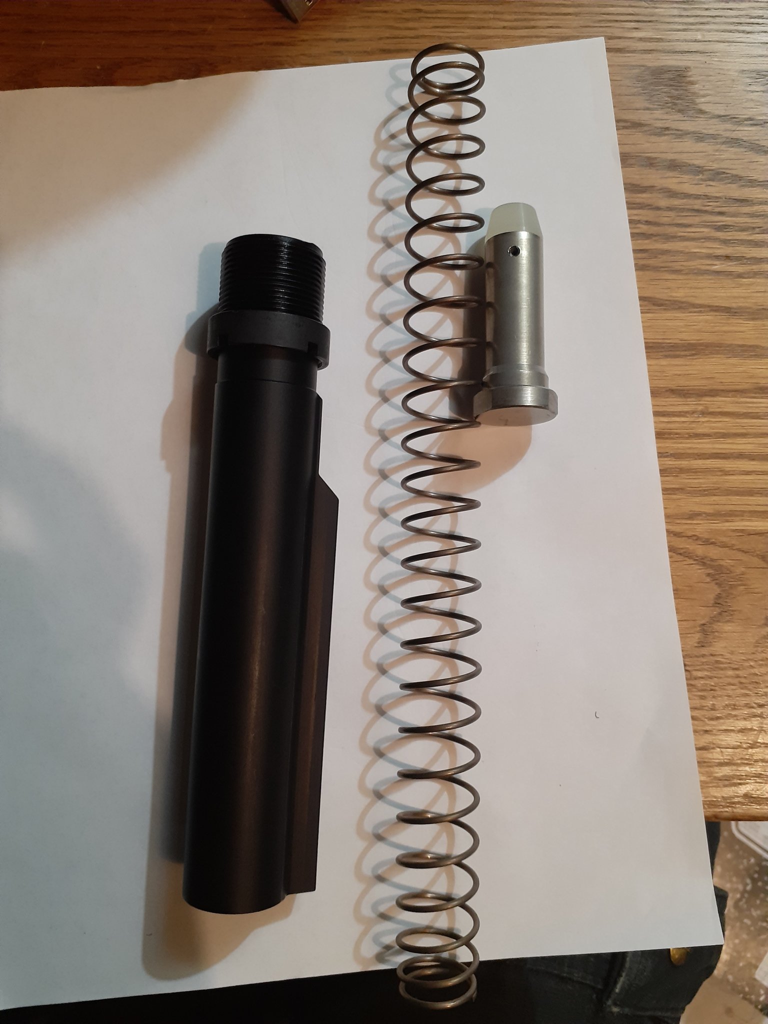

Hello. I recently put together an Aero Precision m5e1 chambered in .308 win.
It has an 18" barrel with a rifle length gas tube. Mil spec carbine lower.
The upper I bought complete and I put together the lower. Everything is Aero.
It fires and ejects properly but it won't pick up a new round. My only thought is that a rifle length gas tube and carbine buffer don't work together, although I've read differently. As you can tell I don't know much about ARs, so any suggestions will be appreciated. Thanks
Not sure about the buffer group I bought it off Aero.
The buffer is 2.5" and weighs 3.8 oz
The tube's outside length is 7 7/32"
Usual 308 buffer weight is about 5.4-5.8 ounces but if it's short stroking (it seems everyone is agreeing with this) this won't be the issue.
I ALWAYS run a A5 type buffer tube on a 308...it's 3/4 of an inch longer give or take a tad and helps more than I could ever say.
The 308 bolt is longer than a 556 bolt so it helps having a bit more to play with....that bolt also has to come back farther to accommodate the longer 308 round.
You need that 3/4 inch.
Vltor makes the tube, maybe get a Tubbs or Wolff buffer spring to go with it and a real (5+ ounce) 308 buffer...2.5 inch long is correct.
Don't use 5.56 shit on a 308, they ain't the same.
The simple test is the charging handle pull, it should not be all that hard to pull back and you should not be able to max out movement with the handle, should still be about an inch rearward motion of the bolt possible.
(I hope that's understandable).

He has a carbine buffer tube and a shorter buffer to allow for the longer .308 bcg. This isn’t his problem.
How many rounds do you have through it?
Try different good quality ammo with a different magazine. Also really lube the bcg, often times the gas rings and the bcg need to wear in. Generally this is not an issue if properly lubed. Good video on where to lube:

Also my buffer tube is 7" measured on the inside.
I would recommend you correctly lube the BCG, try at least 2 more types of ammo and have another magazine brand on hand then go shoot a minimum of 20 rounds to see how things go.

And do lube it well.... be sure the chamber is clean of any packing oils, and lube the recoil spring as well ( not dripping wet ) disassemble the BCG, lube as normal. ( It could be your BCG was shipped sparsely with oil )
Aero uses a DPMS pattern buffer tube setup.
That means... a AR15 Carbine length buffer tube, with a 2.5" 308 carbine buffer, and a 308 Carbine length recoil Spring.
As a FWIW... the Armalite pattern buffer tube setup, uses a Vltor A5 length buffer tube ( about 3/4" longer internal depth ) to allow use of typical AR15 3.25" carbine buffers, and ( typically ) a Armalite EA1095 recoil spring.
The various parts, listed above... DO NOT INTERCHANGE..... Misunderstanding and Interchanging parts can cause a lot of issues.
As examples....
1. As mentioned, using the 2.5" buffer in a A5 / Armalite length carbine buffer tube can cause battering at the lowers RE threads.... and even if the lower doesn't get smacked / beat up... the additional excess recoil travel could cause bolt catch breakage, and other "odd" issues.
2. Using a 3.25" buffer in a AR15 carbine length buffer tube will cause short stroking.... because the to long buffer doesn't allow enough travel for the longer 308 BCG.... that means the bolt catch doesn't have enough clearance to function as designed.
And just for more info in context to buffer tubes and the Large Frame AR... A rifle length buffer tube setup, uses a standard AR15 rifle length buffer tube, with a 308 rifle length buffer ( 5.2" long , and shorter then a AR15 rifle length buffer, by that 3/4" ), is needed from the added 308 length / travel of the 308 BCG.
If you have any other questions... be sure to ask, many of us have gone through the same thing you are.
The lack of a "Mil-Spec" guideline for Large Frame AR's is a pita... we are spoiled by the AR15 Mil-Spec guidelines , Lol
