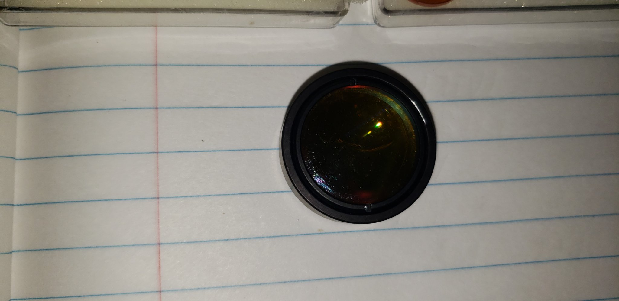

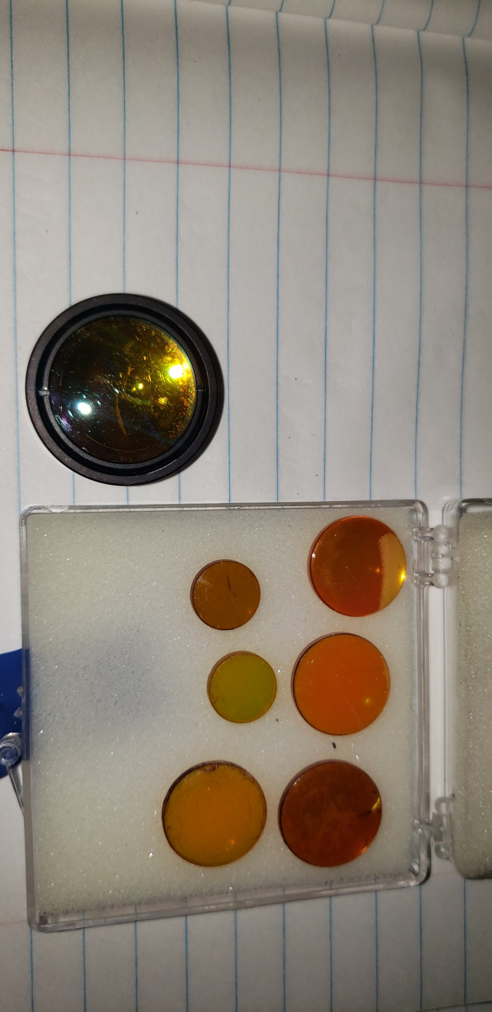

I just posted some pics of a ThOR LT I modified with ZnSe lenses. I think total was about $1200. The graphics processor can handle the larger images it's just scaled down. At 60Hz refresh rate it's good for about 250 yard now on .224 Valkyrie. The other picture is the actual screen, it's just a small LCD with a Focus Lens behind it to give the "feel" of a scope I guess.
EDude, anyway can get a little more information on this? I'm following you about changing out the lens but did you match the size with existing or make it larger?
I have several ATN's and what I have personally found is that the electronics are sound, the soldering isn't. I am an electrical engineer and when the first ATN Thor HD I bought just suddenly stopped working I figured as much. I removed the screws and sure enough it had a loose solder joint, quick fix. Also, the Thor LT is highly modifiable if you want to get a budget Thermal. The most expensive parts on thermal scopes hands down are the lenses, you can't find a used one (just one!) on eBay made out of Germanium for less than $300. So I did a little digging and found that ZnSe lenses for C02 laser cutters pass the same wavelength of light as Germanium, and they are $20-$40 on Amazon. Just remove the ring holding the old lens, get your focal length adjusted and you've got a much better, clearer image that rivals scopes over $4000. Since they are digital it doesn't matter about purging it out with some noble gas either. (I've also modified them for much further telephoto capabilities using combinations of ZnSe lenses)
Can we chat about the mods you made to the ATN Thor LT?
