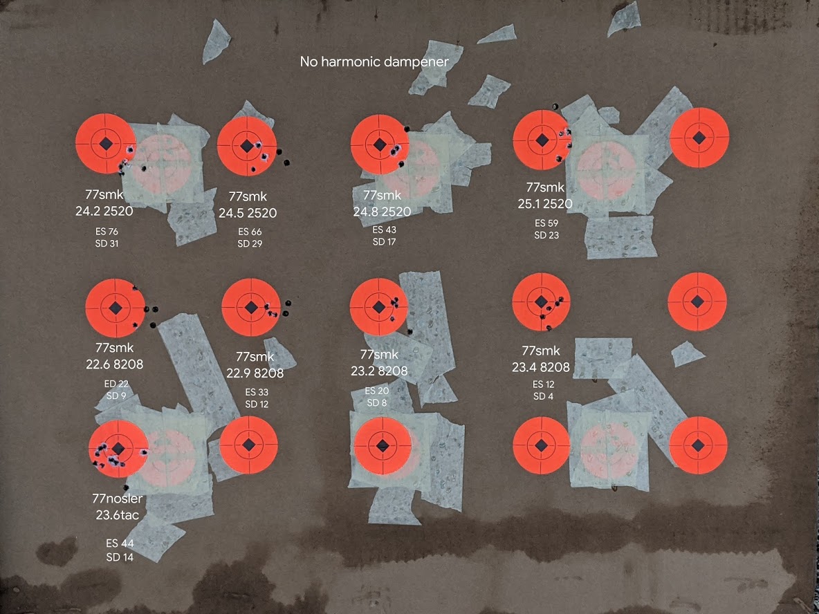

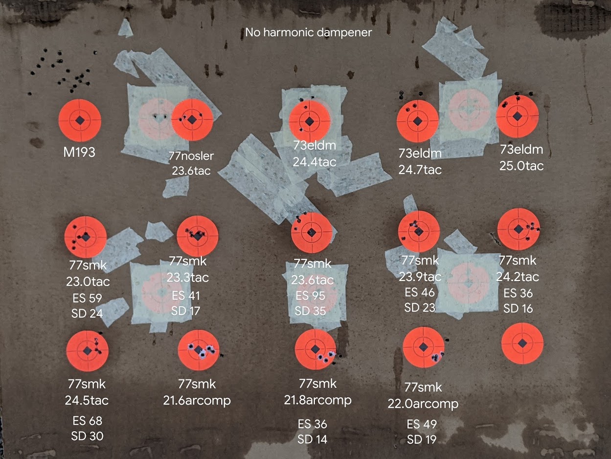

I just got a hold of a labradar to chrono some of my loads through the 18" WOA 1:8 223Wylde AR15, would appreciate some input on selecting a load. Goal is to have a load that can consistently hit 4" plates at 400 yards and maybe 600 yards.

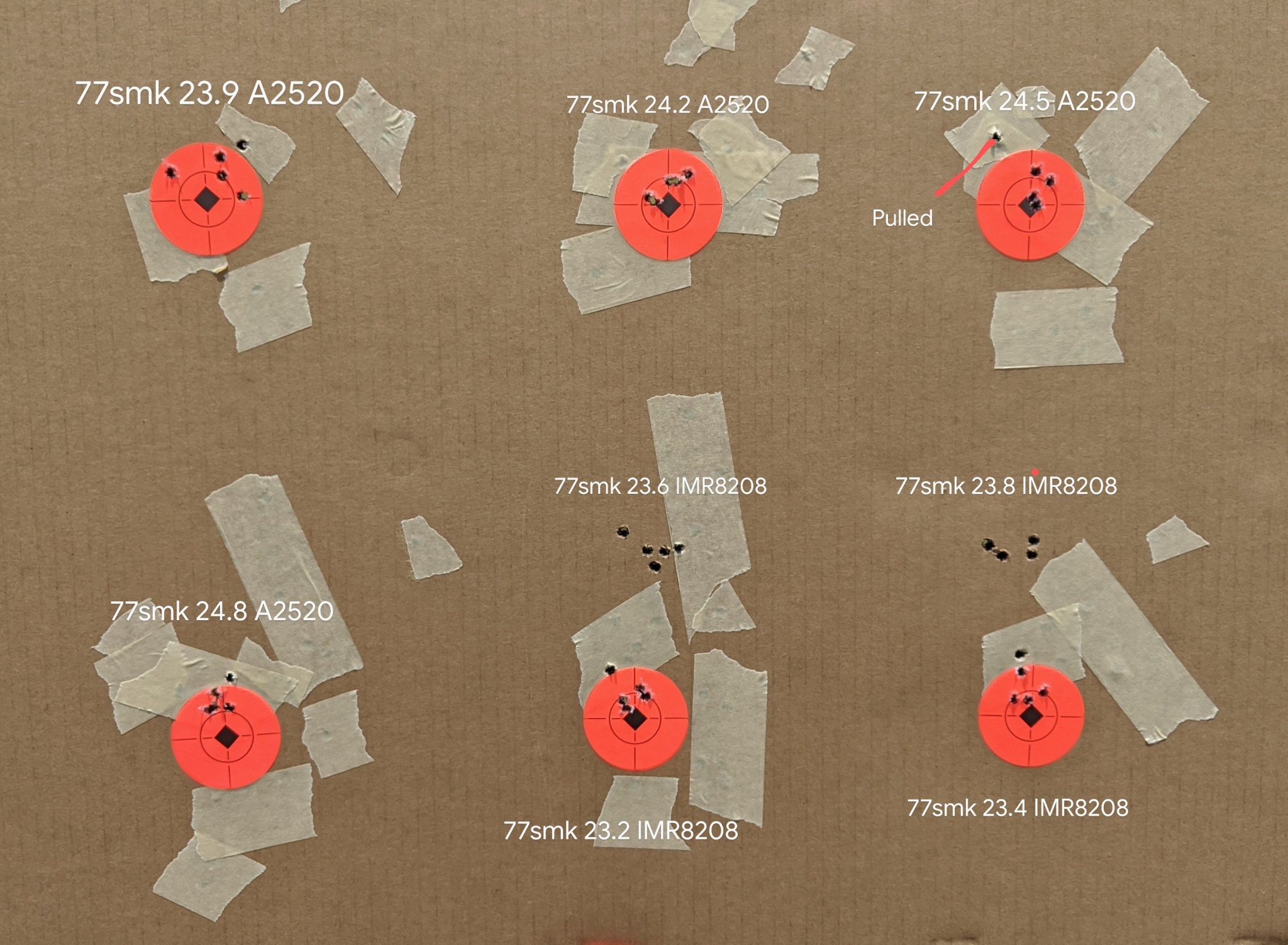

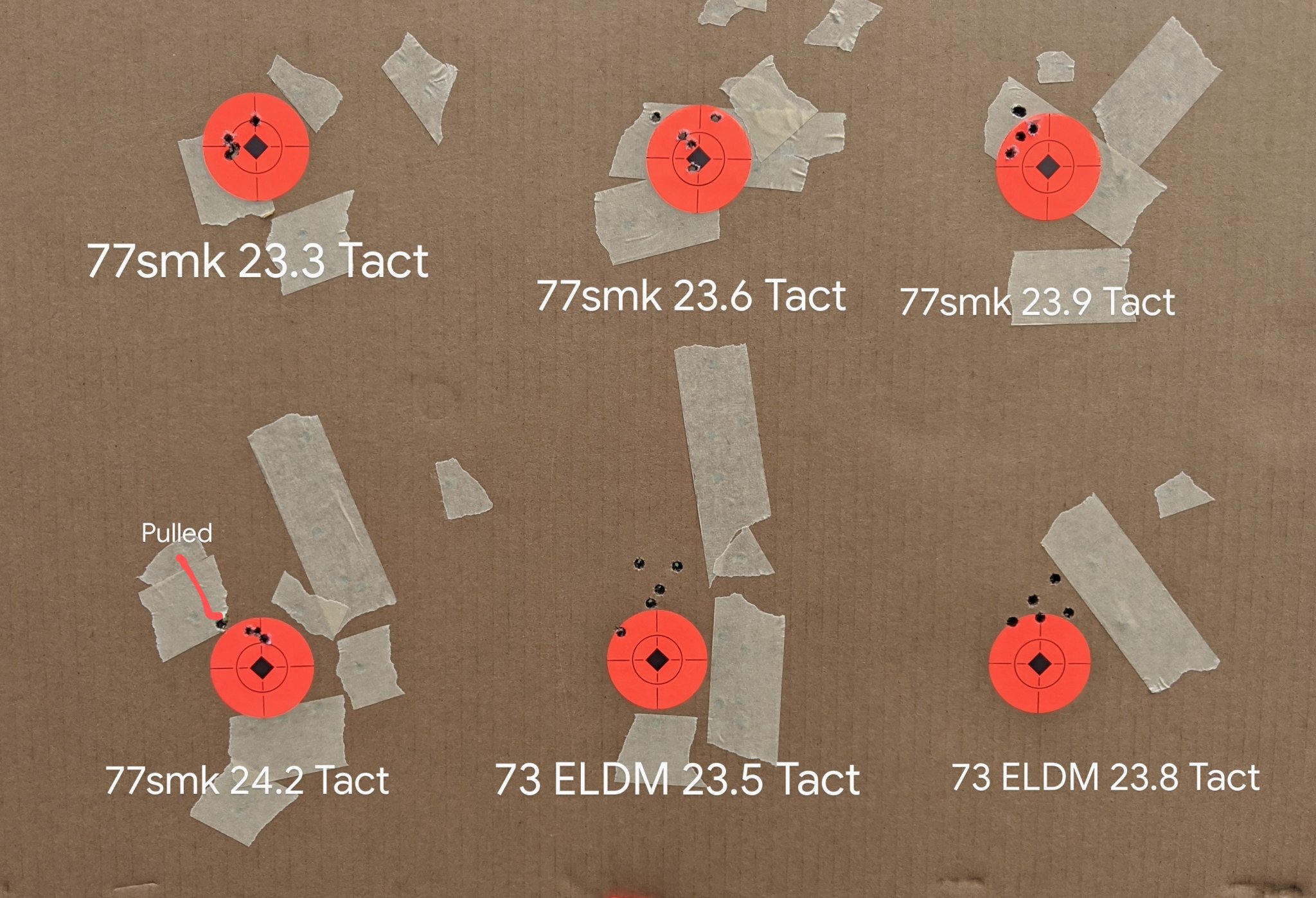

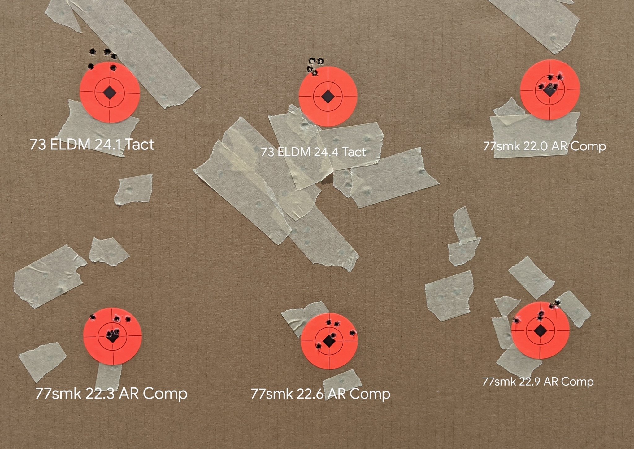

One additional variable, i removed a rubber harmonic dampener from the barrel, right behind the muzzle devise/suppressor where it grouped best, this time around. Having the dampener did seem to tighten the groups. Take a look and let me know what you think.
The 2 pics with 15 targets each did not have the dampener on. The 3 pics with 6 targets each are from last week's testing, no chrono yet, had dampener on.

have posted the ES and SD for each load on the 2 pictures with 15 targets each.

Single shot ladder tests are not very efficient. Especially if your loads don’t have a low ES.
If one charge is fired and it’s on the high end of the ES and the next load is on the low end, you will get a false flat spot (and sometimes, depending on primer/powder combo, there are no real flat spots).
If you’re not getting consistent ES of 20 or less, single shot ladder tests are not the way to go.
Reactions: Formosan
Well, the ladder test is just a starting point with load development, yes?
It’s not needed. You can pick your target velocity based on published load data and work up and down from there. The only time I would use a 1 shot ladder test us when testing primers.
Unless it’s a complete wildcat, there is enough load data online that you’re just wasting ammo to get the same info most everyone else has. Not to mention, if your flat spot was indeed an anomaly of high/low ES, said ladder test is now worthless.
With modern chronos and easily sourced load data, finding a powder charge can be done in less than 50 rounds. Then 50 or less for seating depth. While having almost complete confidence in a powder node that will withstand environmental changes In the equivalent of .3-.5 grains of powder.
Reactions: Formosan
