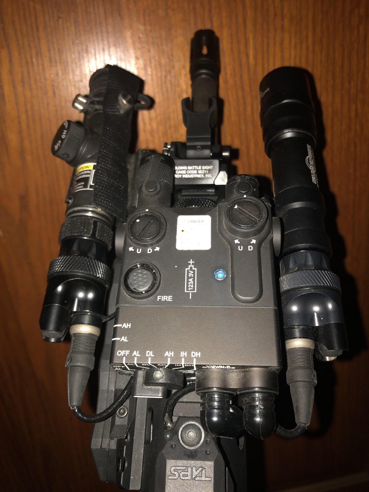

Below is a Dbal A3 Civi slaved to a Luna ELIR-3. Robert at JRH can get you the Dbal A3, Luna ELIR-3 and the Luna Surefire Adapter. Then you would need 2 Surefire DS00 switches (one for Luna, one for White Light) then get 2 Taps Sync Switch's. One slaves the A3 to the Luna, and one slaves the A3 Vis Point Overide Port to the White Light.
The really nice thing about slaving the Luna to A3 is that you can use rechargeable RCR 123 batteries in the Luna which puts the battery in the A3 only running the IR point. So batteries in the A3 last forever because that battery is not having to run the A3 Illuminator. Another huge plus is redundancy. If for some reason the Luna went down, you can quickly rotate the A3 nob and use the A3 Illuminator.
Another thing to note about the above system in the photo is that if the Unity/TNVC pressure switch's were to fail/quit working, every device (Dbal A3, Luna ELIR, and Surefire M600 with MOD Lite OKW head on it) all have their own on board switch which provides redundancy should the 2 Unity/jTNVC switch's have a failure.
You can also take your time building this system so you are not having to fork out all the money at one time.

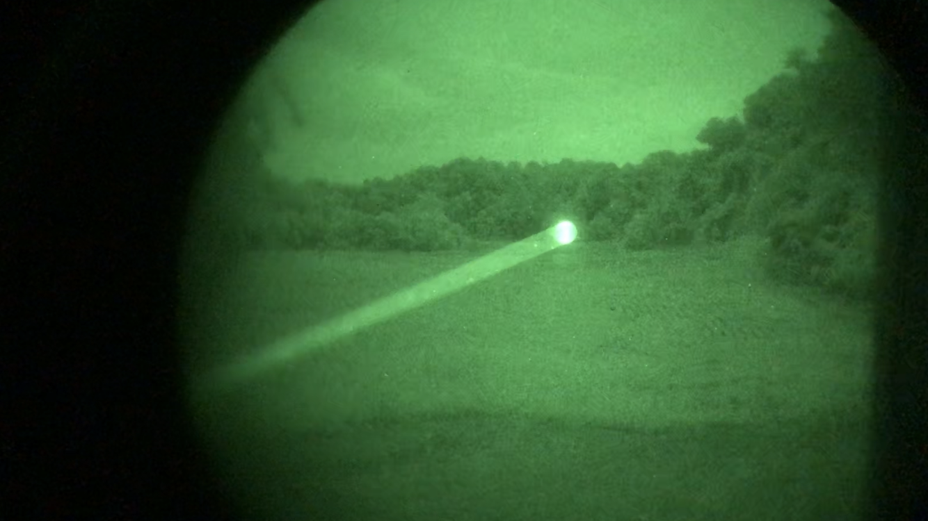

Here is the Luna wide open at 1,000 yards.
However the really nice thing about the Luna is that you can turn the Rheostat down in a split second to do close indoor CQB stuff where it is but a trickle of IR that won't bounce back into your NODS and is "eyesafe" if dialed way down with the beam wide open.
However, the Luna can deliver a lot of IR energy and ALWAYS MUST BE HANDLED CAREFULLY AND APPROPRIATELY, so as not to put out critters (both 4 & 2 legs) eyes.
