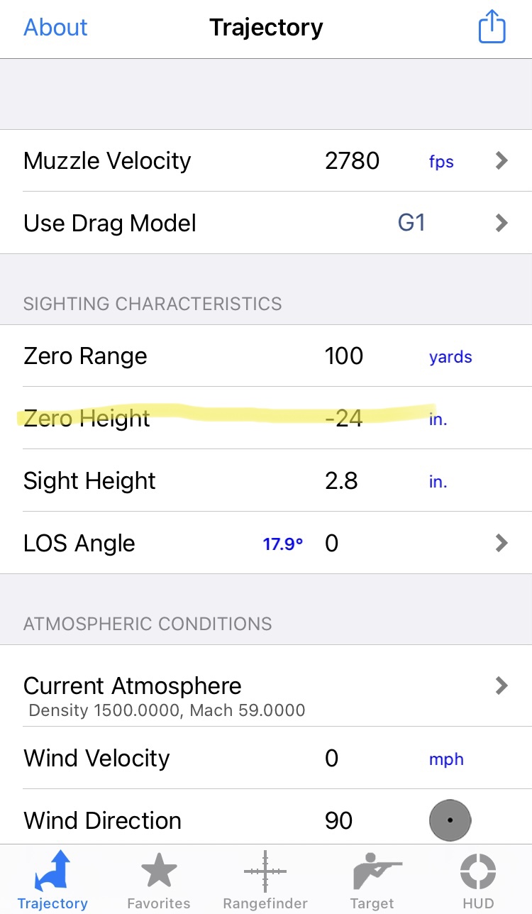

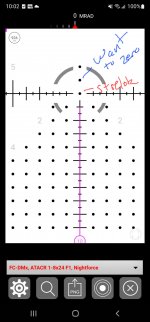

So strelok only let's me zero on the center dot. I can get rough estimates by playing with it but are there any calculators that will let me zero on a different hold? I'm trying to get numbers for the 1 mil hold under. Again I can get rough numbers but just curious if there's a better way.
Pic for clarification

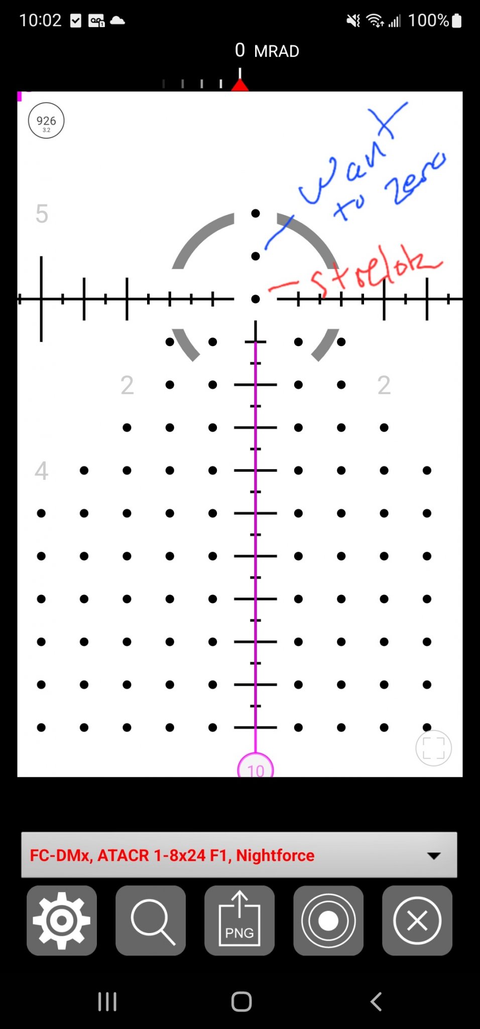

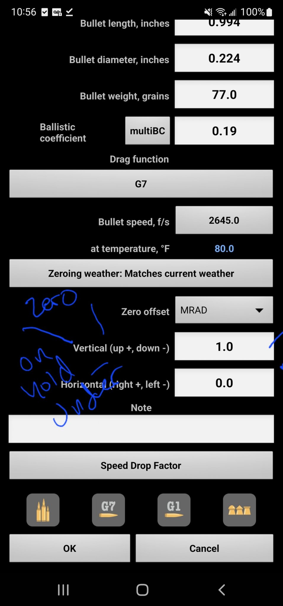

Ballistic AE ?
Can enter zero height as a positive or negative number in inches. Maybe can set it to another value in settings, as there are a ton of options to change. Idk
Reactions: Hoody2shoes
Apple version.
Not sure if this would help, but the air gun guys are using that with a zero offset.
Should be able to view the pdf link in the post.
  • Love

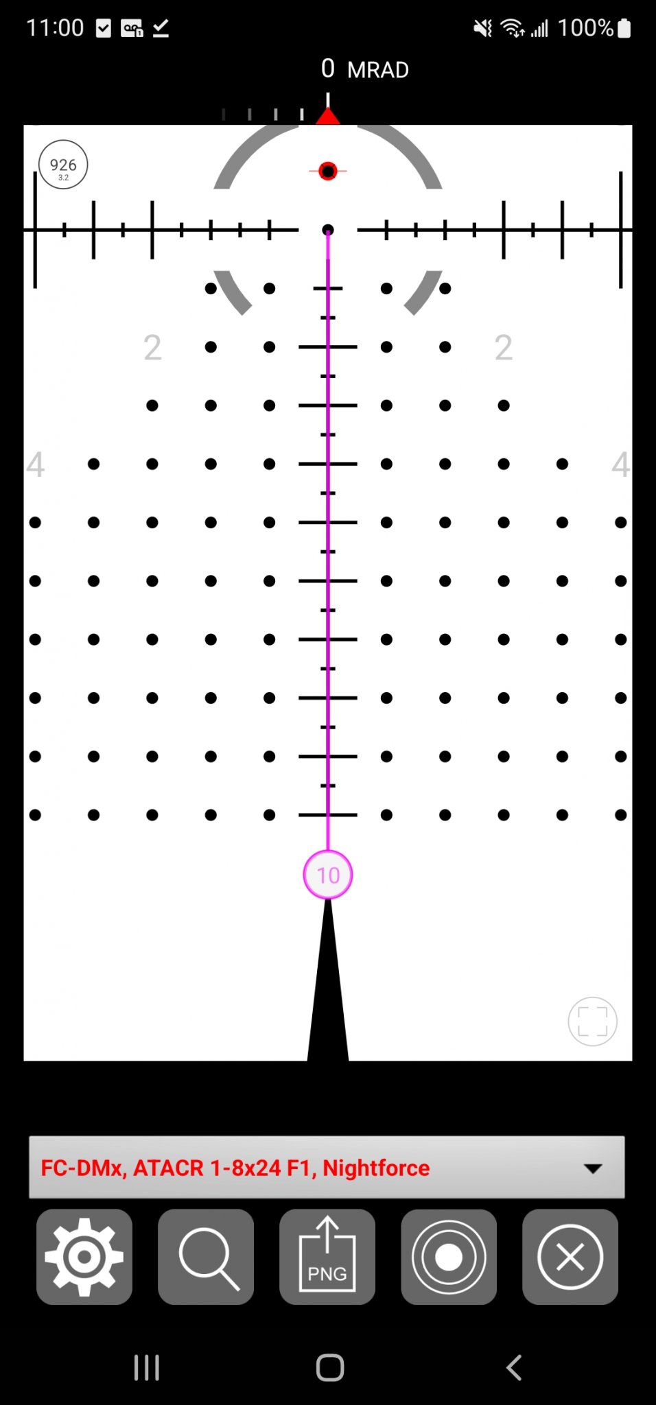

Holy shit super helpful. I've been using this app for years and learn something new all the time about it
Now just to figure out how to get the windage/spin drift line to go away
In main settings, turn off spin drift.
For windage line removal, within the reticle display page, using three fingers simultaneously, tap to toggle presenting, or not, wind lines for 2, 5, and 10 MPH/KPH. This feature will only be available with “Christmas Tree” type reticles.
  • Love
Holy.sheeeet.
