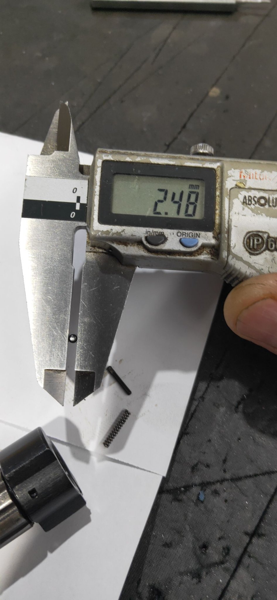

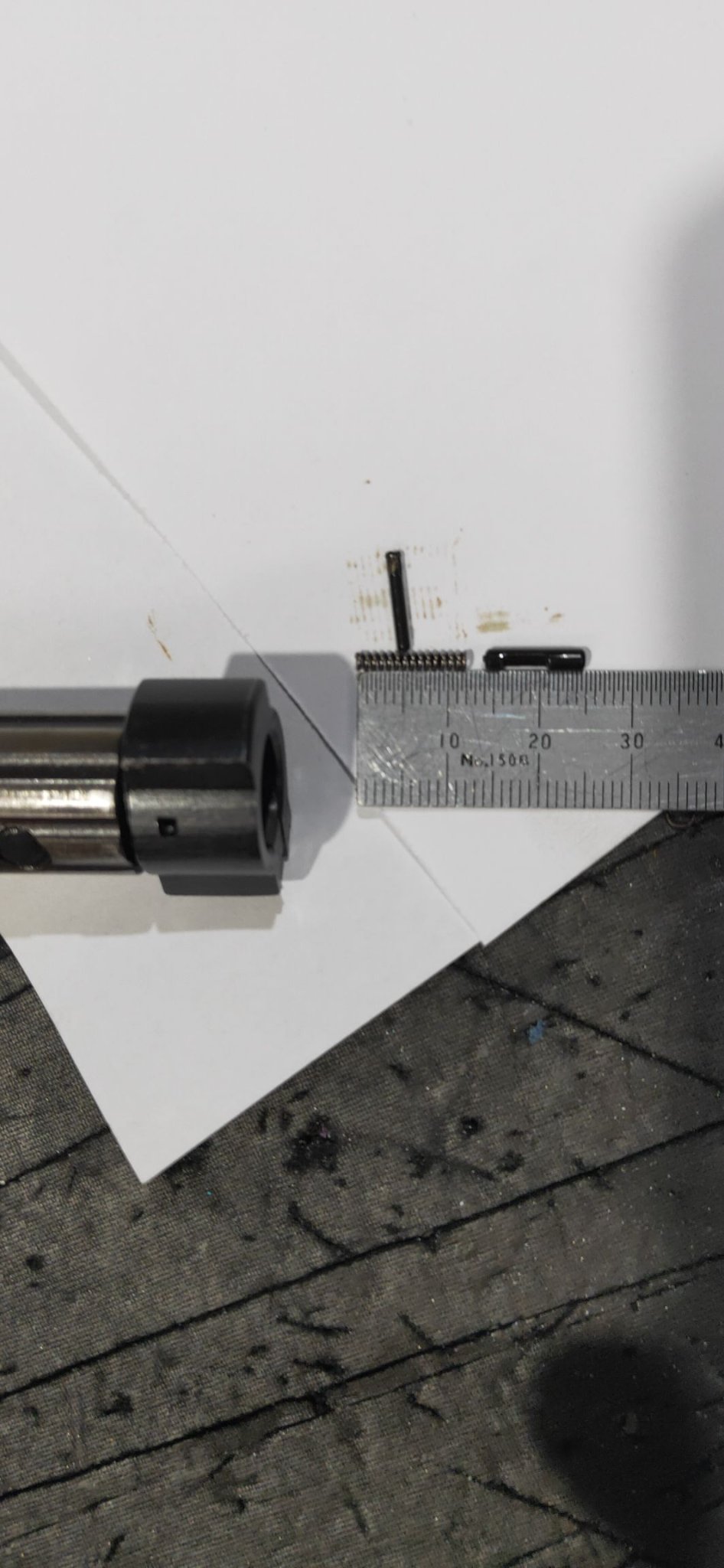

I have a XS7 I can measure and confirm things, and I'm going to suggest a rem700 ejector will probably fit. I'll try it tomorrow and see what's what.
As for removing it... It's got something jamming it. Be it grease-gunk or brass shavings. One it starts moving, you should be good. Personally I have a little old Allen key which I cut most of the end off. I put it into the cross pin hole, and try to lever the back of the ejector pin, like a tiny little crow-bar. If I start to make it budge, even a tiny bit, I'll push it back in with a pin punch, and repeat. It eventually works loose.
Lube (CRC 556 or whatever oil) helps. Penetrene is best I've found.
Pin diameter is 2.5, so a 3/32" drill will work nicely. Rem700 spring cut down won't work. Won't even fit.
Hope this helps
