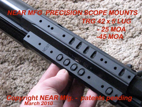

I replaced the factory Picatinny rail with a Near MFG rail after the factory rail sheared the mounting screws. Spuhr is another good choice especially if you want to mount directly to the receiver dovetail. I'd think the Spuhr ST-4701 would work.

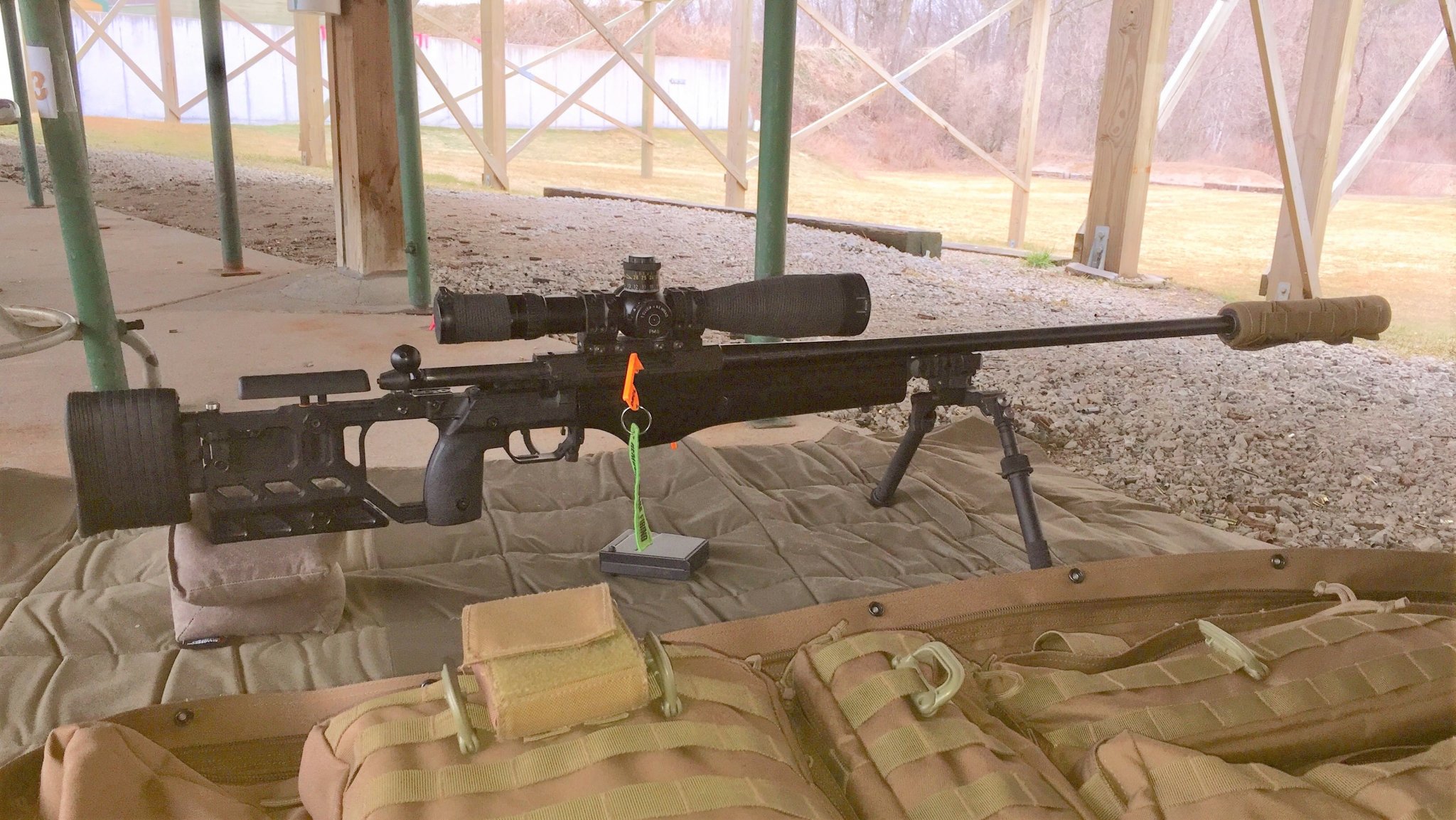

Its an awesome rifle I have a Pre 2013 using TRG mounts and a Post 2013 came with a Picatinny rail, Spuhr wasn't around than, and none of the TRG came with tops, I'd still go with a one piece Sphur mount. probably get away with a Med 1.35 I use 1.5 I can measure it later or post a Pic,
How did you do that? The factory rail is epoxied and pinned in place in addition to the screws.
Mine was only secured with screws, it wasn't pinned. When I called Near MFG he mentioned the factory rails have issues, and while he might not be the most impartial source, he seemed to be sincere.

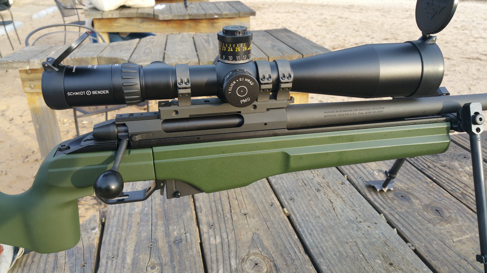

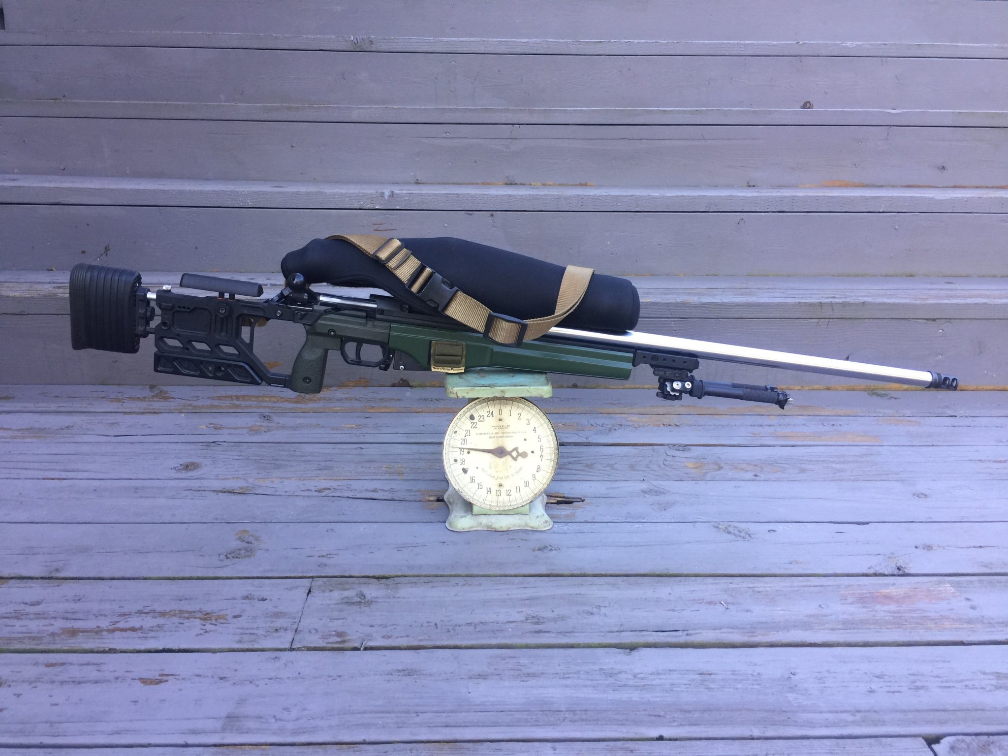

I ended up knocking my rail off and direct mounting a spuhr mount, I highly recomend the KRG spigot, below is a KRG folding stock. I'm kind of set up for PRS stuff or at least that's the goal. made some changes this year with a whiskey 3 on the 22 and moved the folder over to the42 300win
