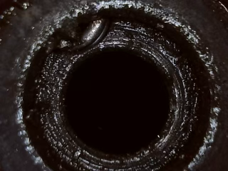

So I finally got a backup 700 .308 backup setup blueprinted and it came back DOA and would not fire. It was all new parts and never fired. I have been sitting on the setup until I had the $$$ to get it set up properly and trued. The smith said they fired several rounds through it and it fired no issues. I have another 5R and zero issues with my loads and standard loads. My main go to is Federal Gold Match SMK 168G. I picked up a MDT TIMBR chassis and bedded and set everything and took to the range with first pull was no fire, which repeated 4-6 attempts. So I was scratching my head, and a bit upset, so I sent it back and they said that it fired at their shop when it left and again when I sent it back with no issues. I received it back and today got to go to the range, same issue.
As I have been racking my brain in sequence from part to part, I decided to use my bore cam and here is what I found. Is the general consensus that the bead of solder in the bottom of the bolt is the reason why the firing pin could have never fully seated to get the proper depth to strike the primer.
Looking or a second, third, forth or fifth opinion.
I appreciate the feedback, gang.
Update, So I checked my other 700 .308 bolt and it also has some level of solder in the bottom as well. Perhaps a TT Diamond issue?At this point any thoughts are appreciated. Thank you, in advance.
