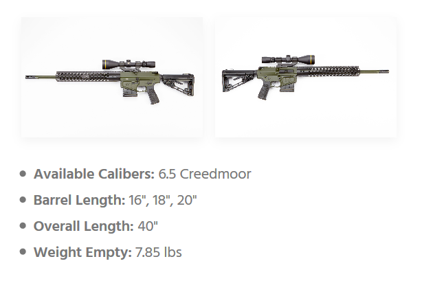

FYI - Wilson Combat has exactly what your after with the Recon Tactical but it's $3K @ under 8 lbs is pretty damn good for a large frame.
