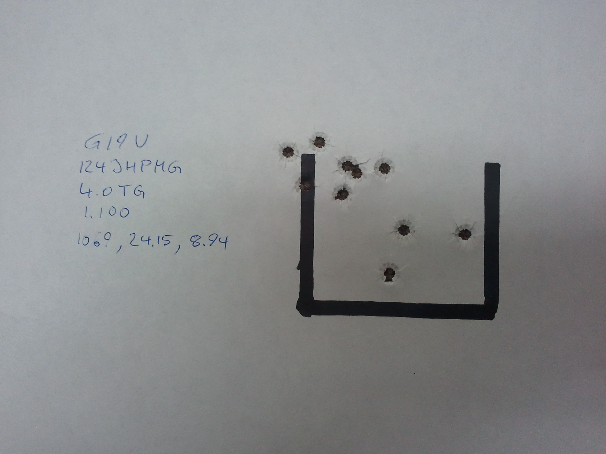

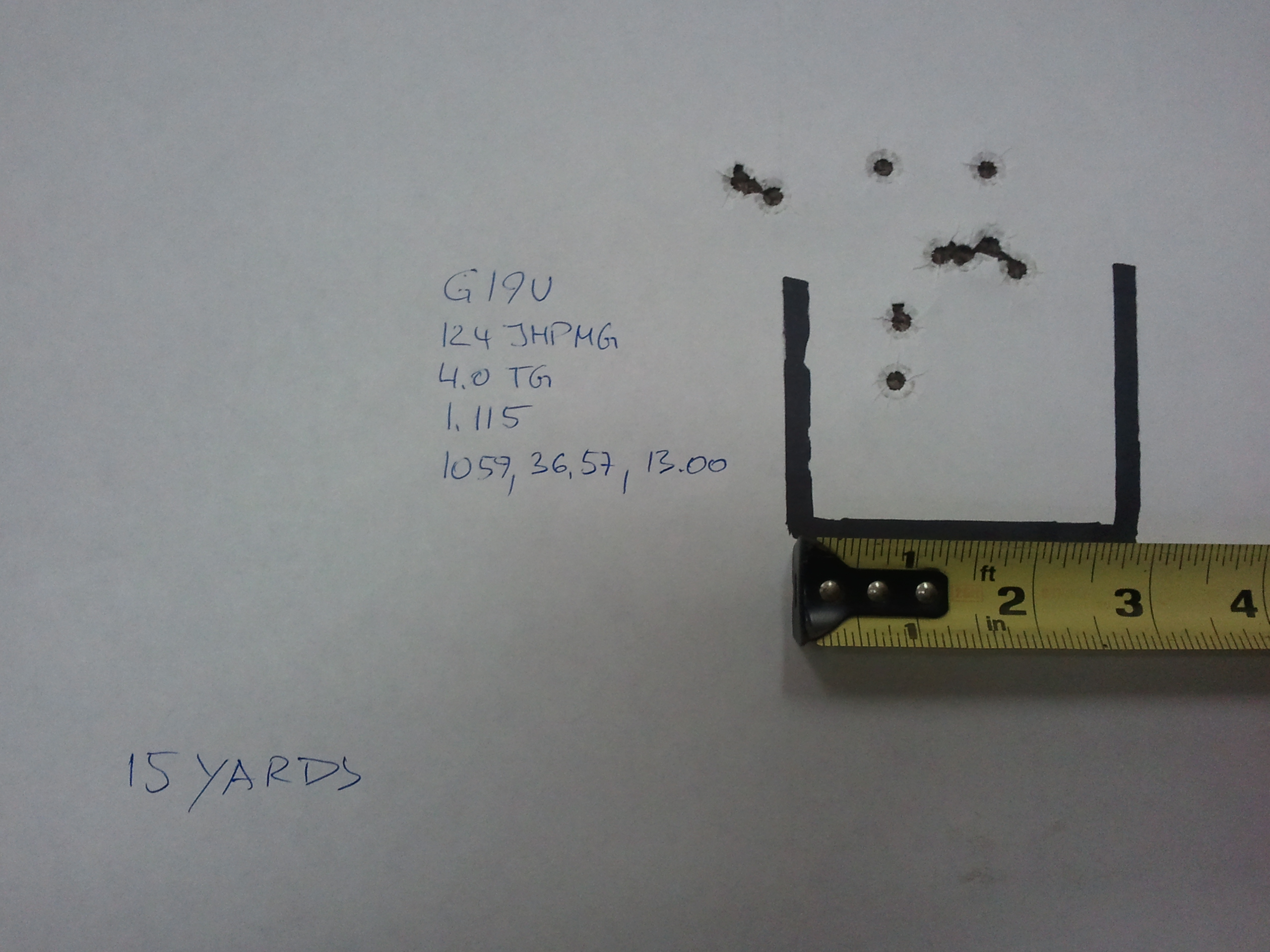

Attached are two pictures to show the operator influence on the POA/POI relation. Both groups were shot successively. Since I was testing ammo for speed consistency, I did not go "completely anal" about accuracy.
The same bullet, launched with the same powder at roughly the same speed (seating depth was the variable) should have put the center of gravity of both groups at the same spot in relation to the POA (top of front sight aligned with the bottom edge of the U-shaped box) - if it were not for the nut behind the gun.
