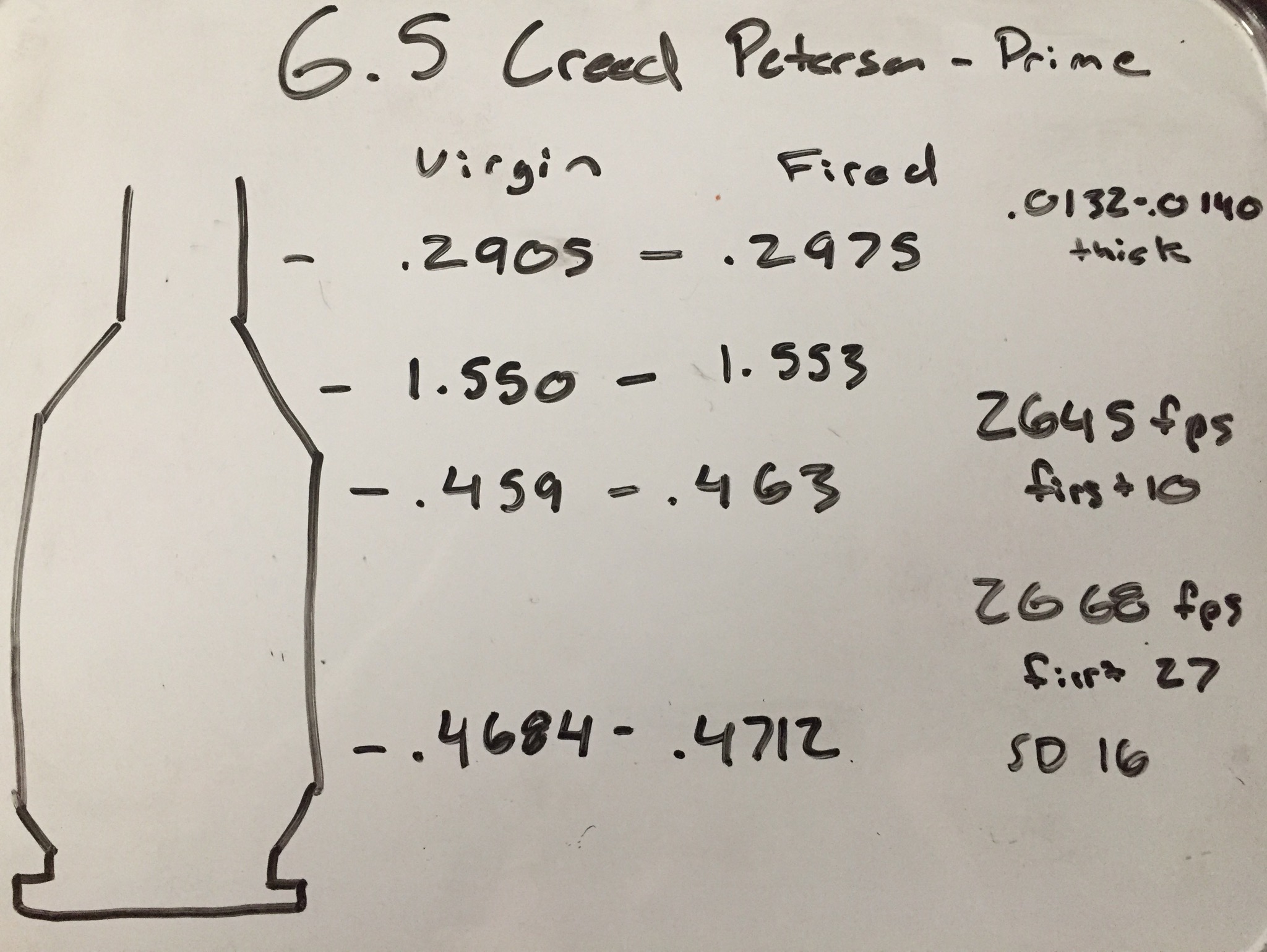

Need help - rounds not chambering?
awpk03s
Jun 17, 2017
544
294
Ohio
I recently started reloading 6.5CM. I have 4 rifles in that chambering, two bolt guns and two semiautomatics.
In load development, I used once fired brass from the bolt gun. Redding FL sizing die, and micrometer seating die.
When testing, in both bolt guns all went smooth, and I settled on a charge weight, and seating 0.015-0.02” off the lands.
Moving on to mass production, I sized all my brass same way as I did originally.... screwed die to top of the shell plate, backed off a little. Now all this once fired brass was from all my rifles, auto and bolt.
Long story short, I made a bunch of rounds, and discovered that a high percentage (half based on my small sample size) will not chamber. Bolt will not close - I could force it maybe, but enough clues that something is wrong.
My hypothesis is that the brass fired by semiautomatics is hosing me up, and perhaps I should be more aggressively sizing/bumping back on the cases...? Is this feasible? I’m probably looking at pulling a bunch of bullets, dumping powder, resizing, and then loading again...? I guess?

You shouldn’t just be running the die down and then backing off a little.
You need to be using caliper/comparator and knowing exactly how much you’re bumping the shoulders. And you should be just bumping enough to chamber properly.
Each rifle may be close enough in measurements to bump them all back to a uniform bump, or you may need different bump for each rifle.

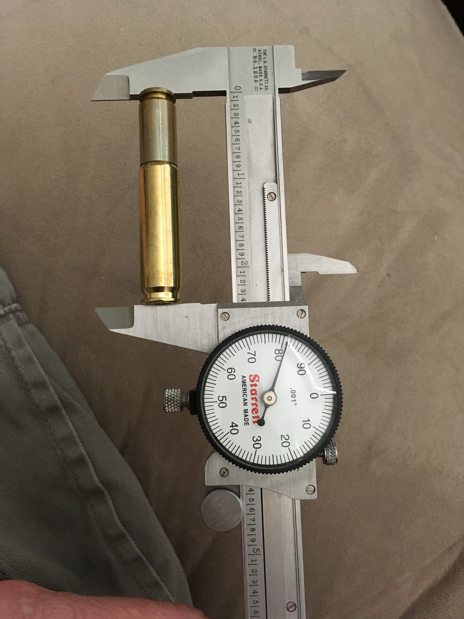

Thanks guys.
I’ll get a gage in to measure the shoulder properly (Found a Wilson one that looks like it will do the trick). In the meantime, will sort what I’ve got and reduce the rounds to bare components again, and then resize properly for the bolt gun chambers respectively, and start over.
Any input as to which of these would be more suitable? And am I even looking at/for the right stuff? There’s a pretty wide disparity price wise here, so I don’t want to over/under do it...
Thanks again everyone.
Another way to do it is to get to "zero headspace" using a stripped bolt and adjusting your die, then use the stepped redding shell plates to go .002 off. But, with two different rifles, you'd need to make sure that headspace works for both of them, so will be sub-optimal for at least one. Not a gas gun guy, so this is worth what you paid for it.
Good demo here:
Regarding measurement tools - do you have a set of good digital calipers like a Mitutuyo? If not, you should. You can get bump gages, etc that fit the calipers, same for bullet comparators for measuring CBTO.
Aha, yes, I use those inserts to measure bullet ogive, something similar for case shoulder should be the ticket.
Yep. Hornady and Sinclair both offer the headspace comparator bushings. It’s the way to go, assigning an actual number to each dimension instead of those plunk gauges that are just a pass/fail with no telling what dimension it was that failed.

Wanted to say thanks again for the help in this thread. I got my Sinclair bump gage in yesterday, and going through my brass, found a variety of different dimensions - explaining my issues.
I’ve already pulled all the bullets from the loaded rounds, and am going to get more scientific with my brass sizing and segregation here going forward and try it again.
