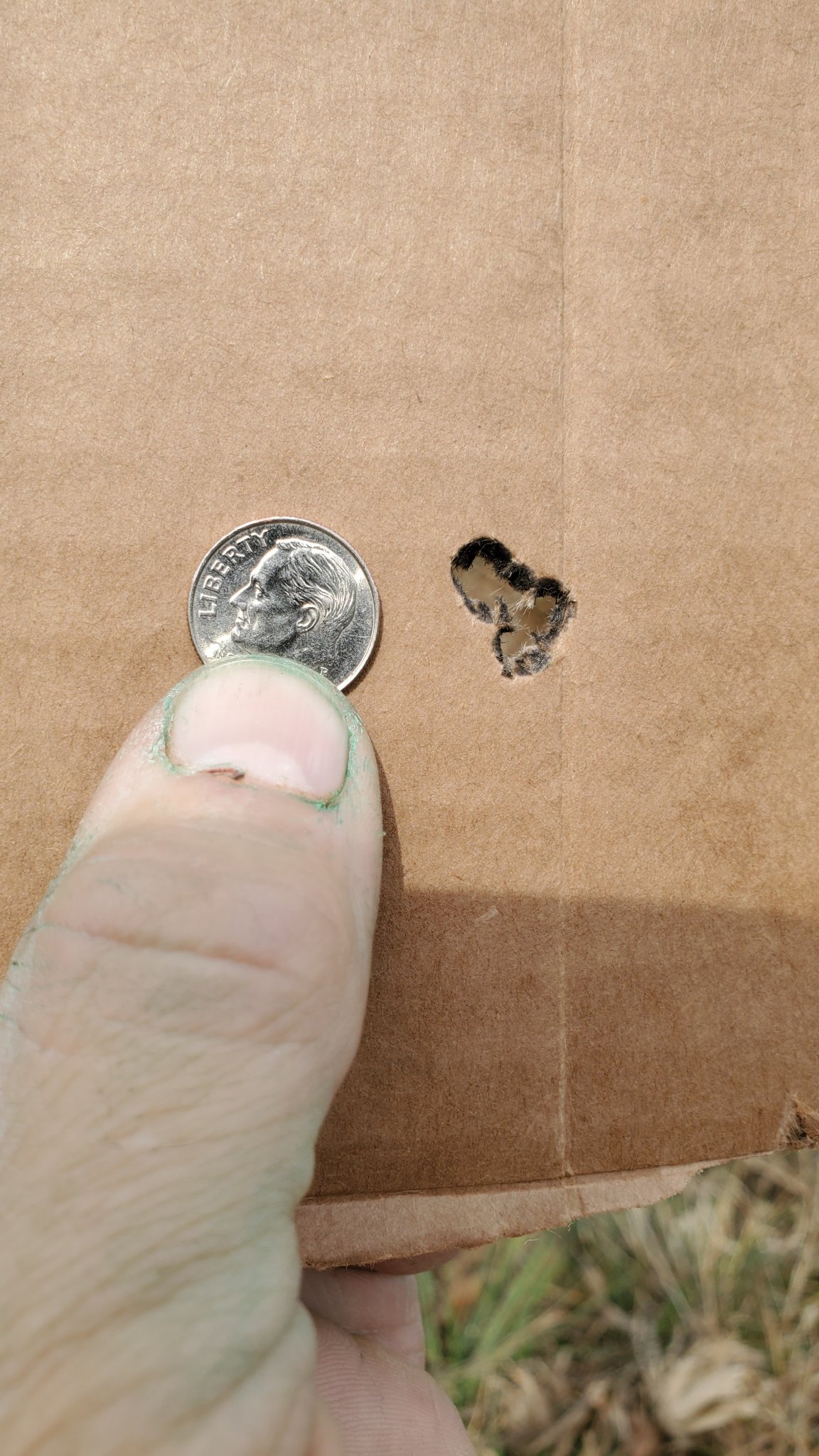

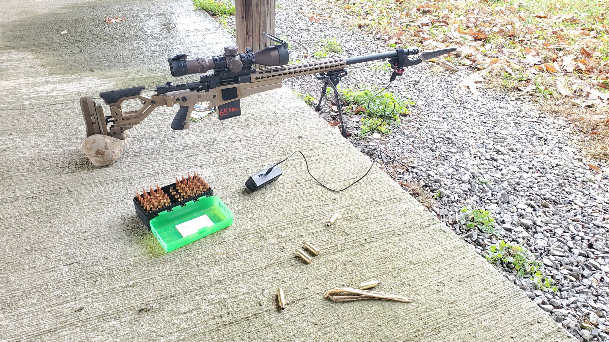

I did a retune on my 6.5prc, think ill stick with h1000 till my 12lbs are gone. 140eldm@3080, 6.1sd on 10rds, 2 5 shot groups.
Edit: 5rd groups, not 6.
