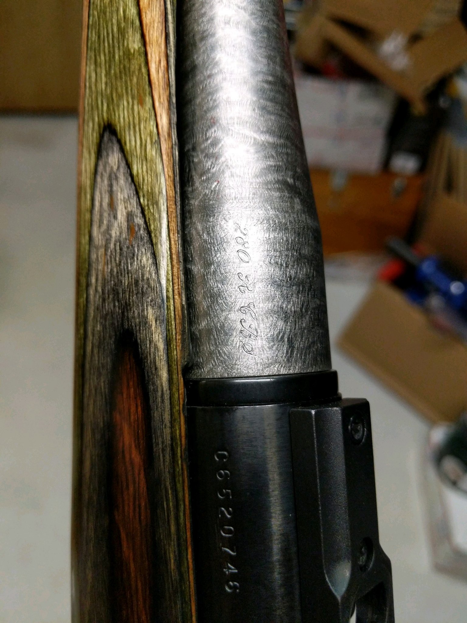

Have a barrel chambered in 280 RCBS, shouldered and not a Remage set up. Can't find head space gages to check it though. Loosely screwed onto the action, the lettering engraved is just above the stock line (see picture). If torqued down, I'm sure it would line up but not going off that to tell me it is headspaced correctly. I do have some fired brass from this barrel.
Can someone either lead me to some gages or a smith for some advice. I asked a couple local smiths and they don't have gages either.
I thought I could use 280 Rem gages since I was told you could shoot factory 280 Rem from this barrel, but want to be sure.
Any advice would be appreciated. Thanks!
You definitely would benefit having a smith screw on and headspace that barrel!
Just because the engraving lines up properly doesn't mean it'll headspace properly.
I had the same issue and my smith had to cut down the shank and touch up the chamber with reamer to set it correctly and have engraving sitting in the proper factory position.

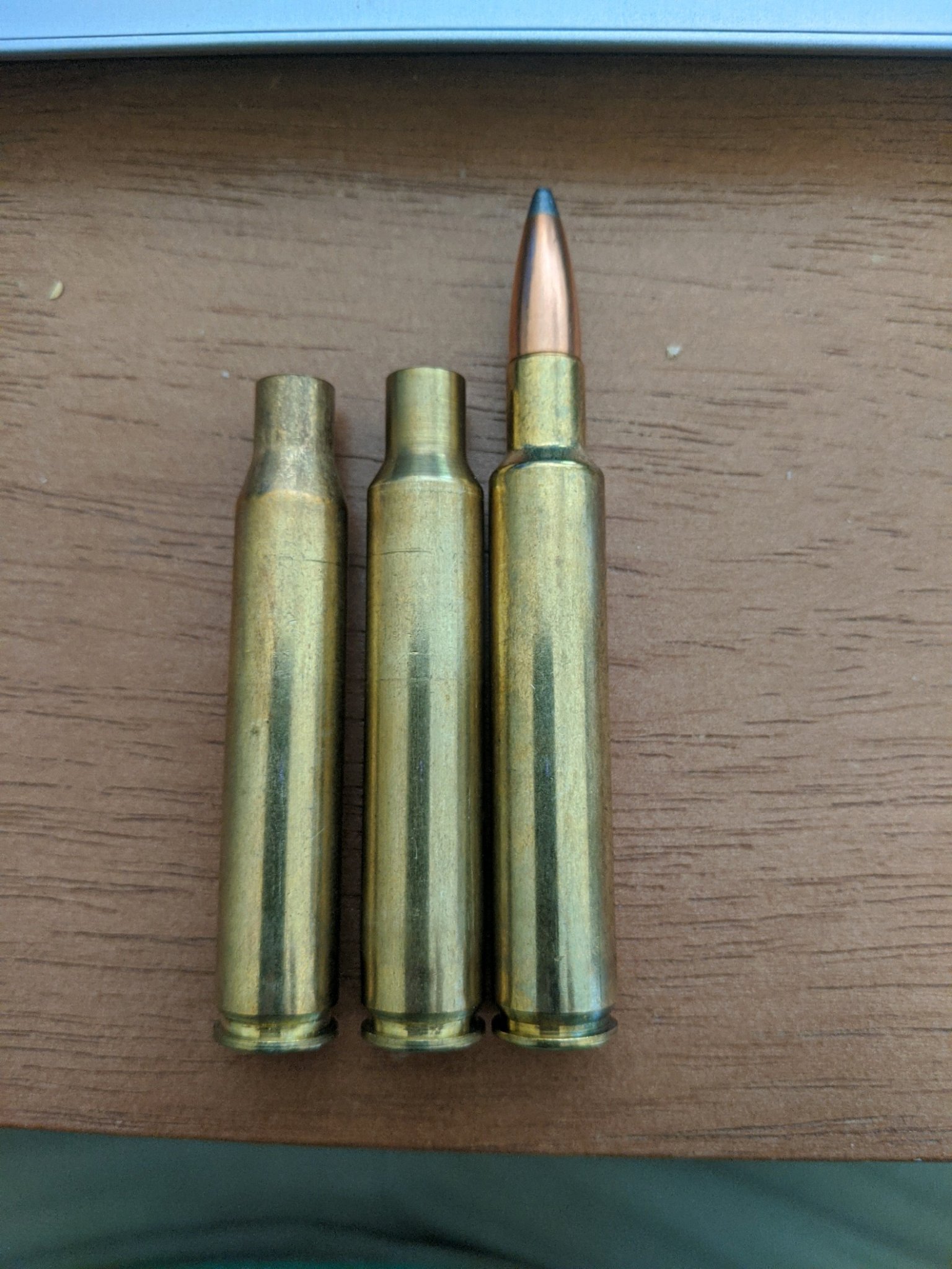

Here's a picture of the 3 rounds (L to R). 280 Rem; 280 RCBS; 280 AI
280 RCBS has a 30 degree shoulder. Fire form 280 Rem ammo. The question is whether you have to jamb the bullet into the lands to fire form or will factory 280 ammo work.
