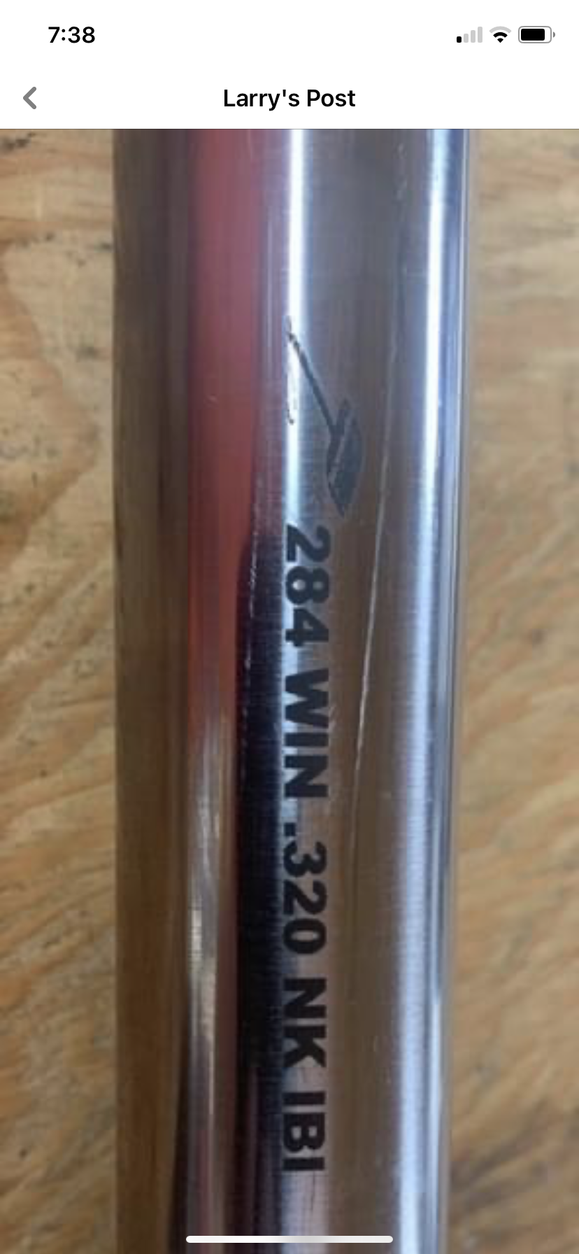

Need help with custom builder’s name
I just picked up a classic custom rifle in a vintage caliber. Pre-68 Mauser action in a .219 Donaldson Wasp. Beautiful rifle. The only markings on the rifle are on the left side of the bbl .
.219 DON WASP 250 NK
I’m thinking 250th rifle built by “NK”? Anyone have any info? THX.
I’m thinking 250th gun built by “NK”? Anyone have any info? THX.
I'm thinking the chamber has a .250" neck diameter.
Here is an example of what I’m understanding your barrel is marked similar too. If so then it definitely means neck dimension.
