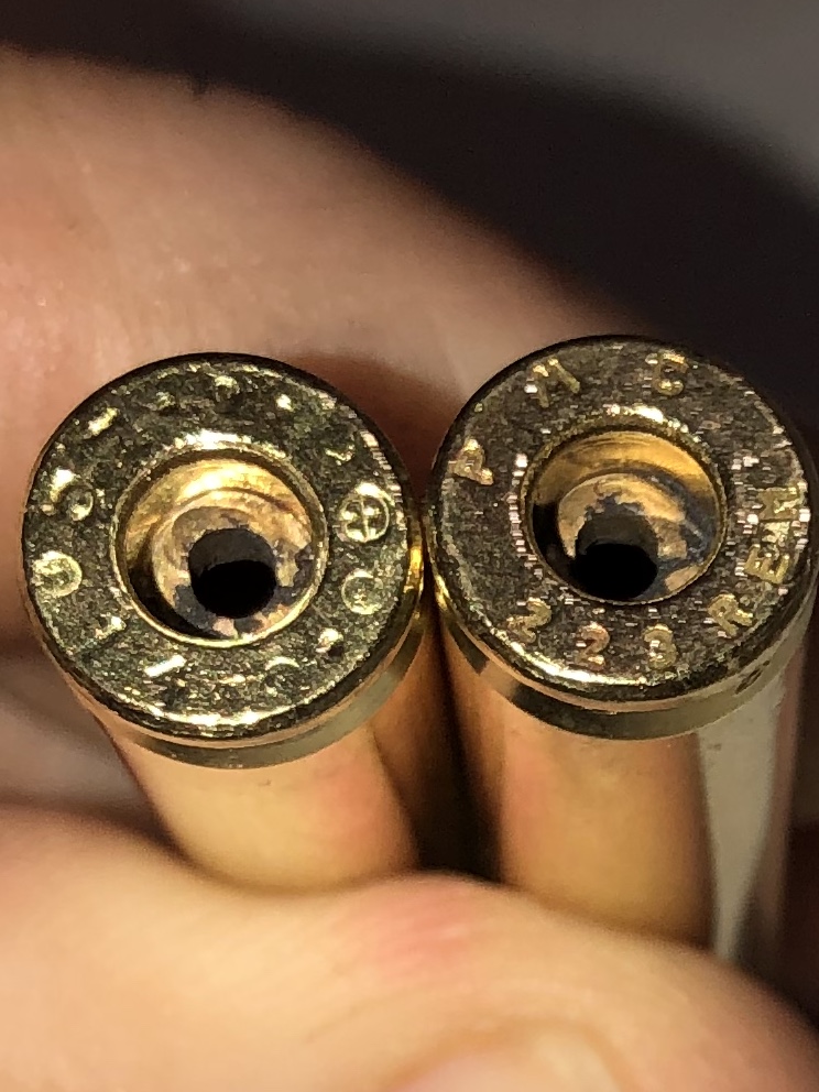

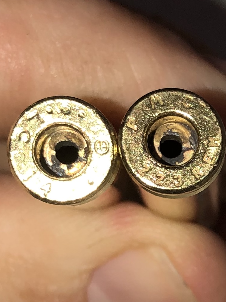

    Need some help here. I sent off some mixed brass to a company to process for me. It was mixed civilian and mil, but there was a lot of LC brass in it I will be sorting for my "precision" SPR. I got it back and noticed that all the brass had a weird dent/deformation in the flash hole area.
    Talked to the company and they said it was from the swager backer, that support from the inside of the case to swage all brass. Company is running Dillon 1050's mostly. I'm assuming he just ran them all through the swager.
    I run my LC brass for my SPR pretty hot, just below NATO max loads with TAC and 77's.
    Is this normal with this sort of processing. Have no experience in that realm and want to make sure my brass is good to go for this. Company said they loaded rounds that came off that machine the same day with no issues.

    This was about 2500 mixed cases. Everything from WCC, LC, FC, Fiocchi, Win, etc. I feel like it couldn't have been that coincidental.

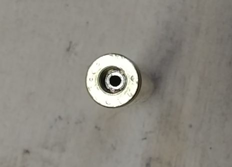

    IF it means nothing in the end, then hey i'm glad my brass is at lease safe. The biggest issue now is the web pushed brass into my primer pockets so after trying to seat a few Rem. 7 1/2 primers, they're not below flush, a couple being above flush. Which means now I need to uniform all 2500 instead of the 500 or so hand picked LC cases I was going to use for my SPR.

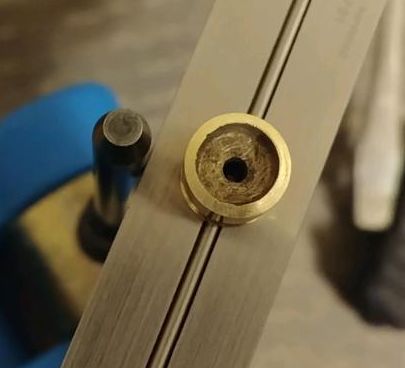

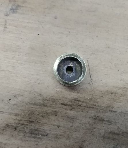

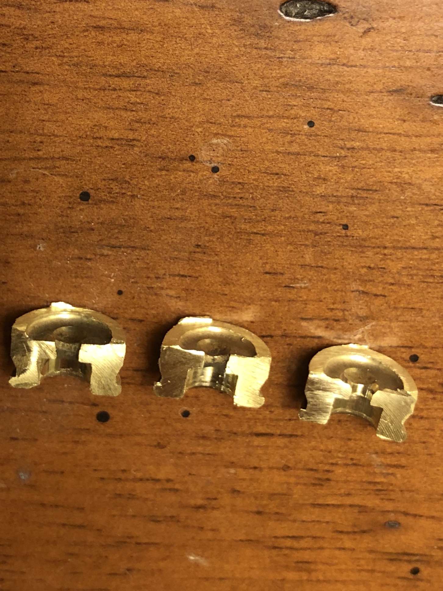

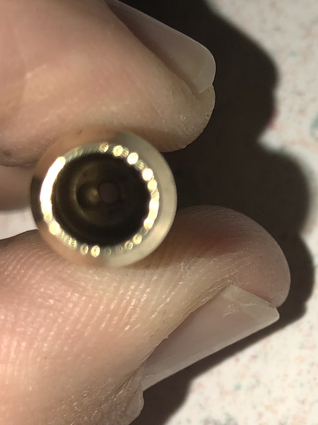

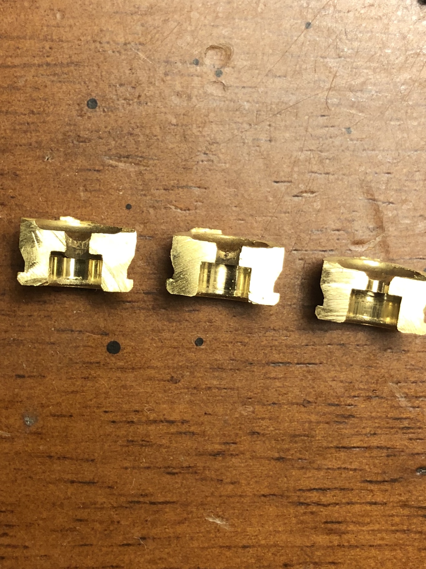

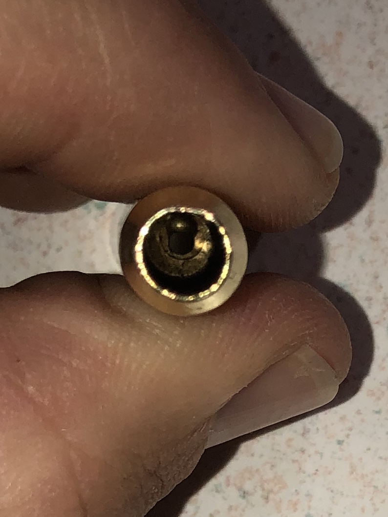

    Here's a few more photos after i cut apart the case. Two of the cases I uniformed the primer pockets so I could get a measurement on web thickness. Normal web measured between 0.065-0.070. The dented portion is measuring 0.045-0.050.

    Looks like a decapper issue. I'm not familiar with swaging on a 1050 but I don't get how the backup rod on the swaging station could make such a divot.
    Thats what I originally thought and mentioned, but he was thinking it was the swaging rod that goes inside the case. He showed me a picture of the swaging die, and it looks like what the dent looks like. My only guess was what others have mentioned about using the Dillon Swager 600 and you can adjust the rod on it, and if you adjust too much, and it can deform that area like mine. I was just pretty confused why it was off center and so harsh of a dent.

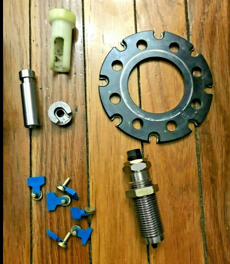

    I was thinking the same thing as @Cowcatcher possibly, after looking at it for a bit. Here is a 1050 conversion showing the die with a backer in it. Either way something has to be out of alignment or adjustment to put that big a dent in it I would think.

    I did. I'm currently talking to him right now. He sent me a photo of a piece of his 1050 that broke today, from the same machine. Looked like a cam arm of some sort (not familiar with 1050's). Sounds like his Swager Backing Rod was bent and didn't catch it. Unfortunately my brass was between the bending and the breaking.
    x_789 : that looks a little more correct. His swaging die was pretty beat up, so I'm assuming It was close to end of life anyways. I suppose shit breaks more often when you're doing 200k cases a month lol.
