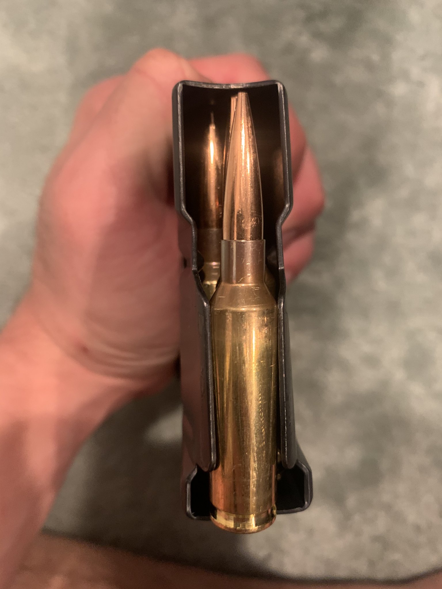

Had a similar problem with the metal MDT mags and 6.5 Creedmoor. The back of the rounds wouldn’t rise up 100% of the time and allow the bolt to ride over. It seems like the mag spring may be too weak. Talked to MDT, and it appears my lips may be too narrow. Opened it up to the recommended size and going to see how it goes. Here’s a pic of what mine were doing
