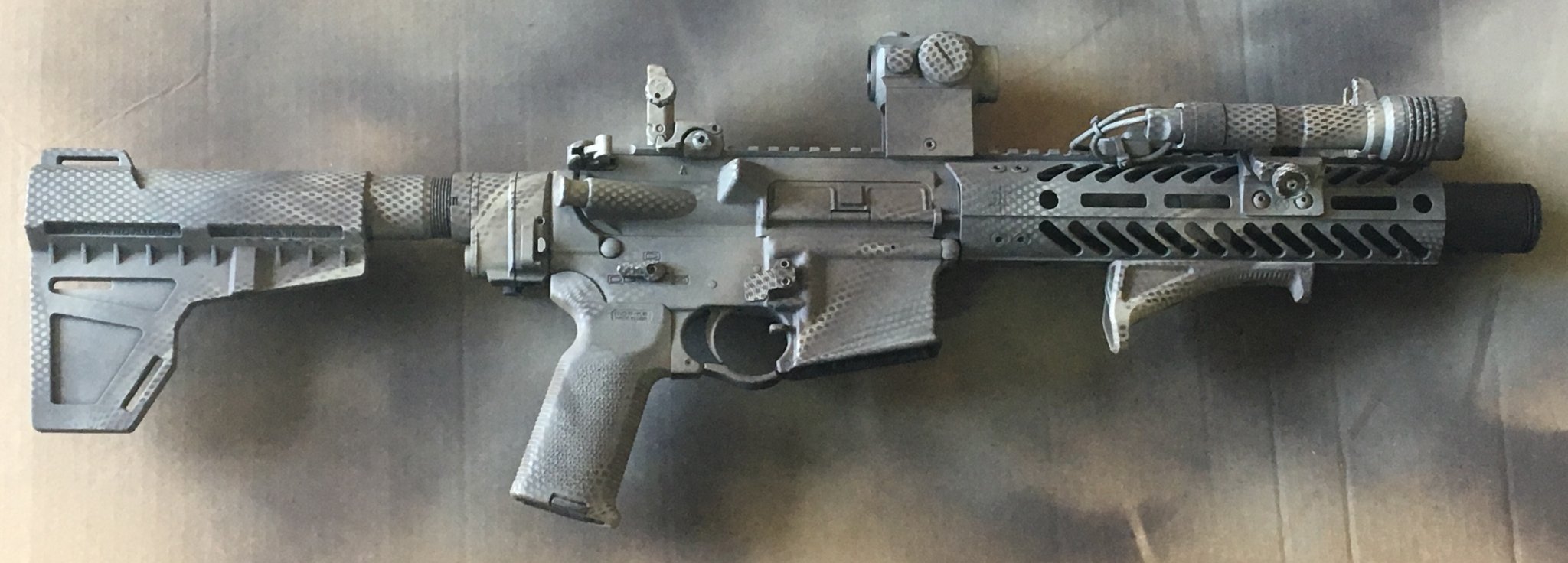

9” barrel, 10” hand guard.
7073491
Same after paint.

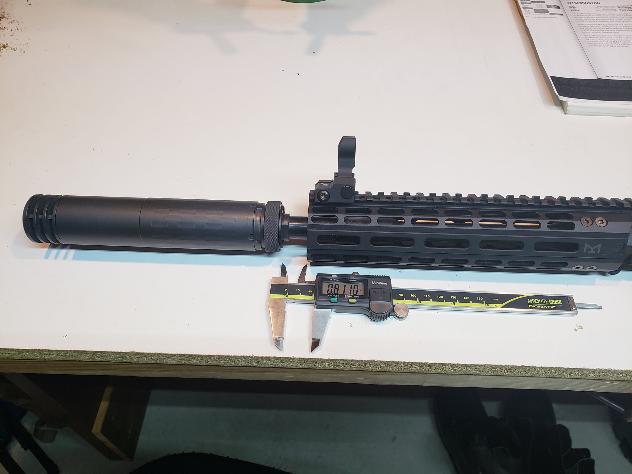

Im 95% sure a 11" rail with a 11.5" barrel will not allow you to mount a supressor on the end.
I would email the guys at SLR but I think you basically need .7-.8" to clear.

Best to measure the barrel from end to end first or call 'em to find out what "11.5" means to them. Every half inch matters if you want the tube or rail as long as possible and sending crap back sucks.
11.5 is as short as I go with 5.56, some go 10.5, and that Lilja is an 11" 6.5G (that's a BADASS little SBR!). .300BLK you can take as short as 8 or 8.5. I have a Noveske 8.2 with a TBAC 30CB9 (the 9" prior to the Ultra) and it's handy and performs well with supers or subs, can or not. A .300BLK is just ideal for this but I gotta admit the Grendel is probably my favorite.
