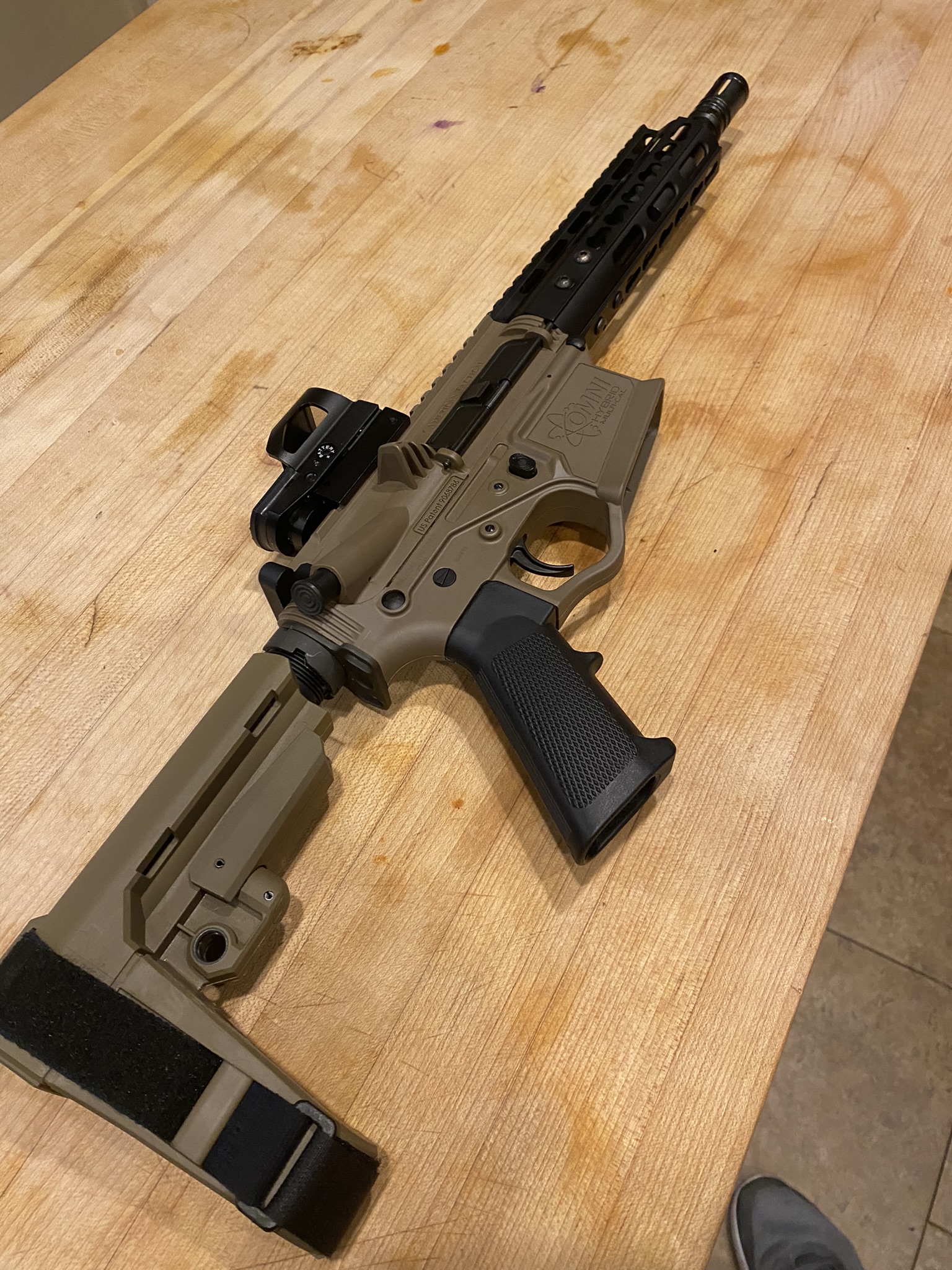

Really no need for fancy gas blocks and texh the 300 is a simple short range round designed for barrel 16” and under and most popular in 7-10 range and unlike the candy ass 556
I was engineered for thiis Exact purpose a hard-hitting short range suppressed stopper and then all the suppressed rounds I have experienced it’s the only one with your truly don’t need ear protection, 7.5” 300 $399 gift and aawsome for the home
