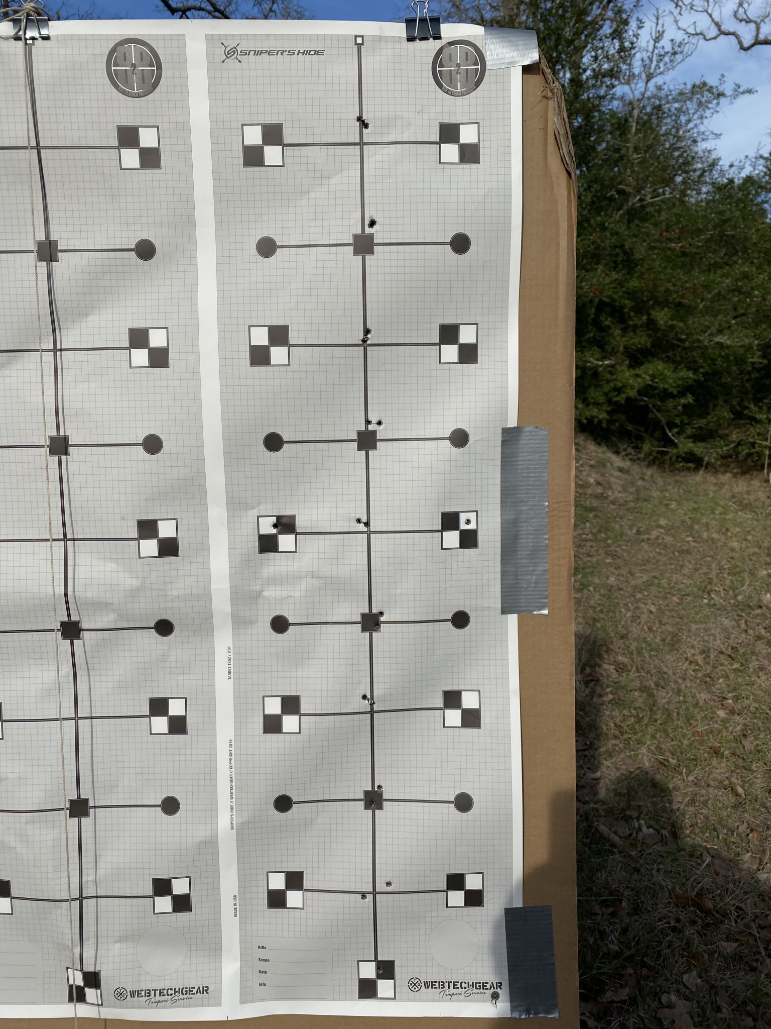

    The test in question:
    100yards
    Tikka CTR in Bravo
    6.5 Creedmoor
    SCOPE: Athlon ETR
    Started at 1mil high, went to 9mil up. Down to 5 mil then 1 mil right/left. Was not happy with what I saw. Then did the next 10, started at 9mil up in case hot barrel was stringing up (did not think this the case but now I know it is not) and came all the way down to 0.

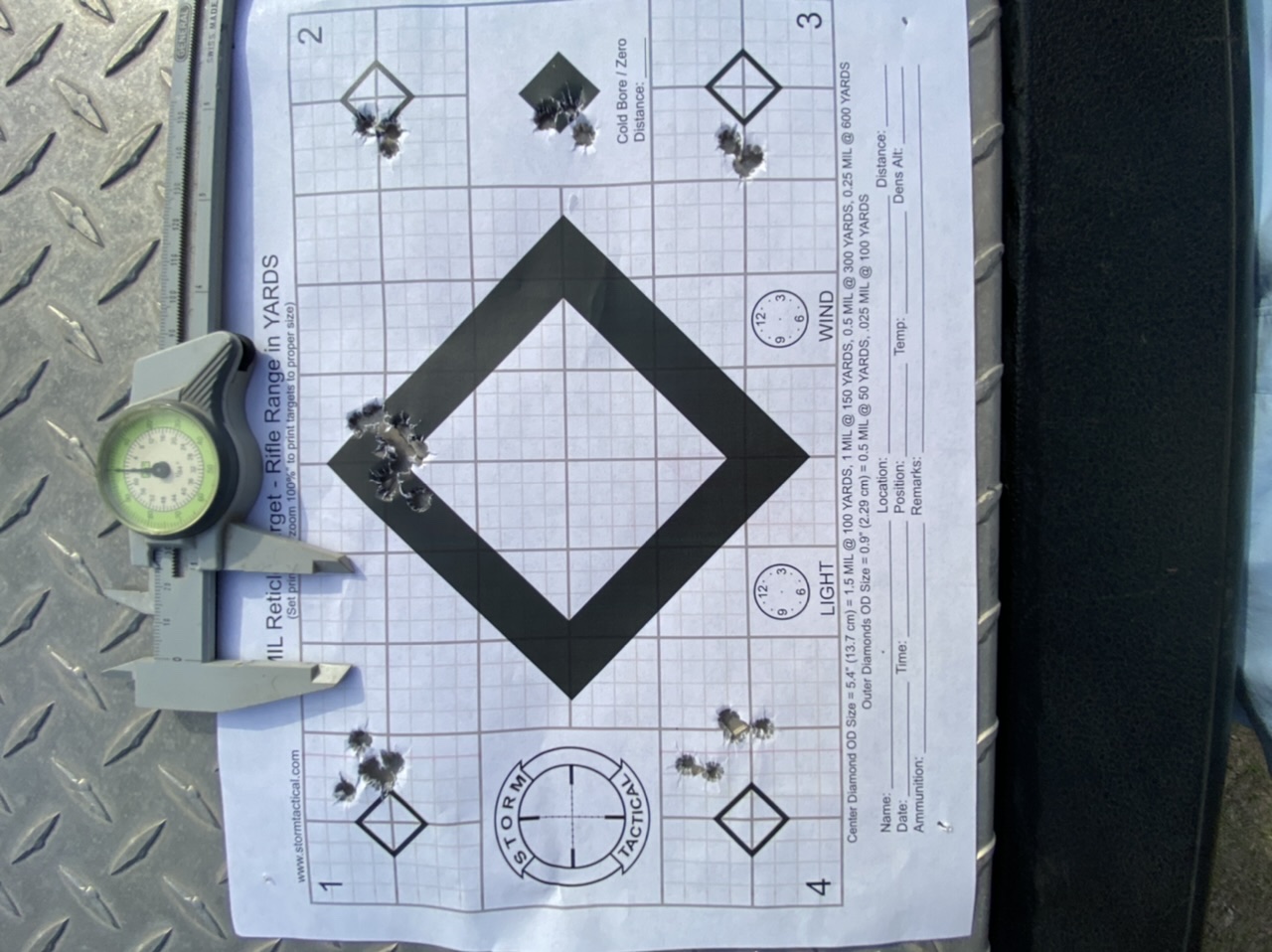

    Typically I am probably grouping at 100 just over .75” with very controlled groups. Groups from yesterday day (same day as y’all target)
    data from the day
    Do I have a tracking error? It sure seems that way to me. Reticle lines up perfectly with the target. Left right seems to be spot on when dialing up. It just seems like it has too much travel the higher I dial.
    I know there is a way to figure this out and adjust it in calculators but I am going to need some help.

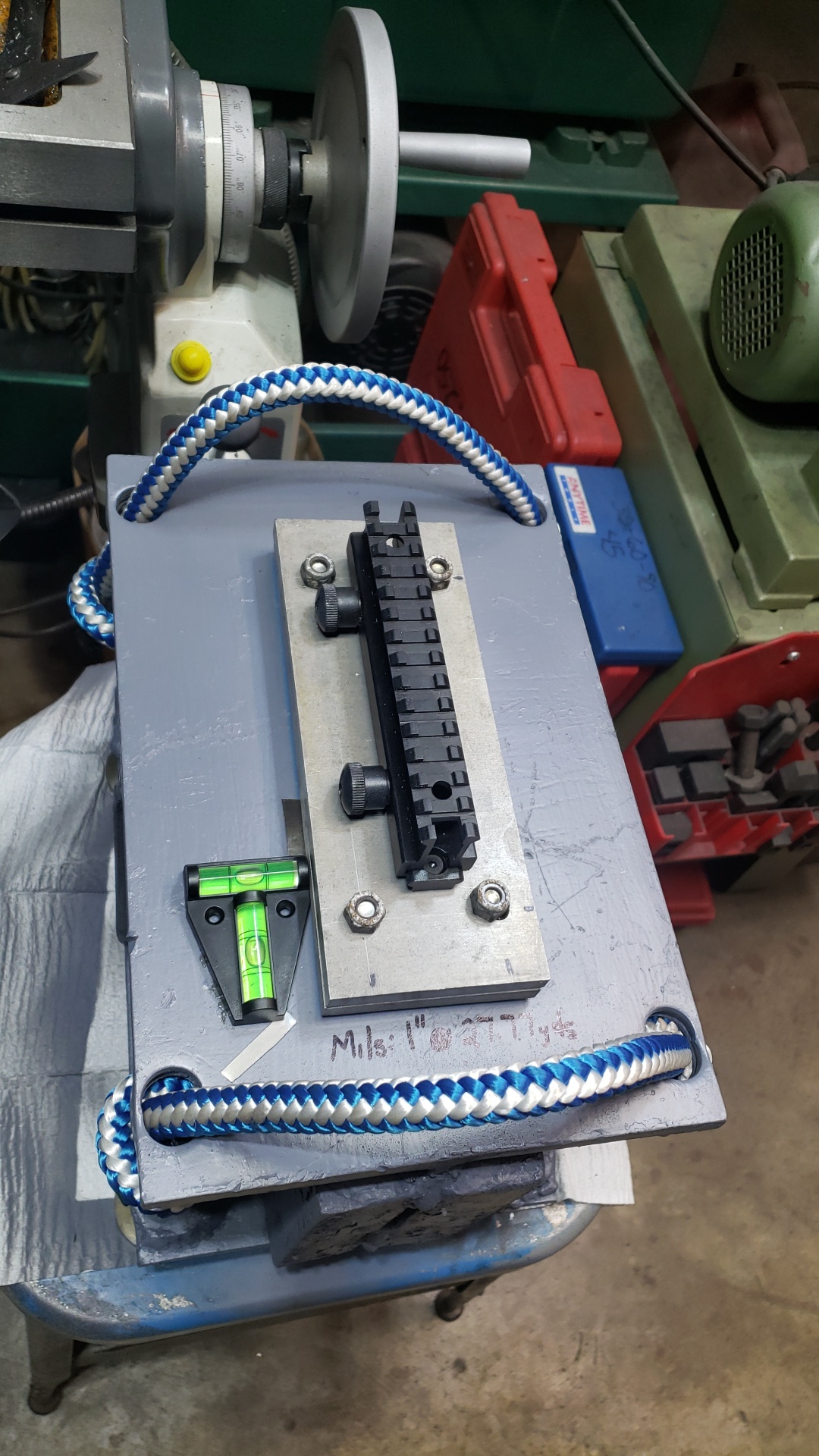

    planning to build a scope mount so I can test with out the shooter error. I think the trend hi was me and not the scope. If it is the scope it would be the first one that I have heard did not track properly.
    the other thing I will add is your target with the groups, while the groups are consistent in size their elevation and lateral position seem to change. I am not sure if this is different ammo.
    You may have contribution of fundamentals of how you are building your position and its affect on your zero position. the rig above removing the shooter error would eliminate this for sure.

    Measure distance exactly and perform the test visually with the optic locked down or weighted down, level and plumb.
    You’ll know immediately if you have an error and can go from there.
