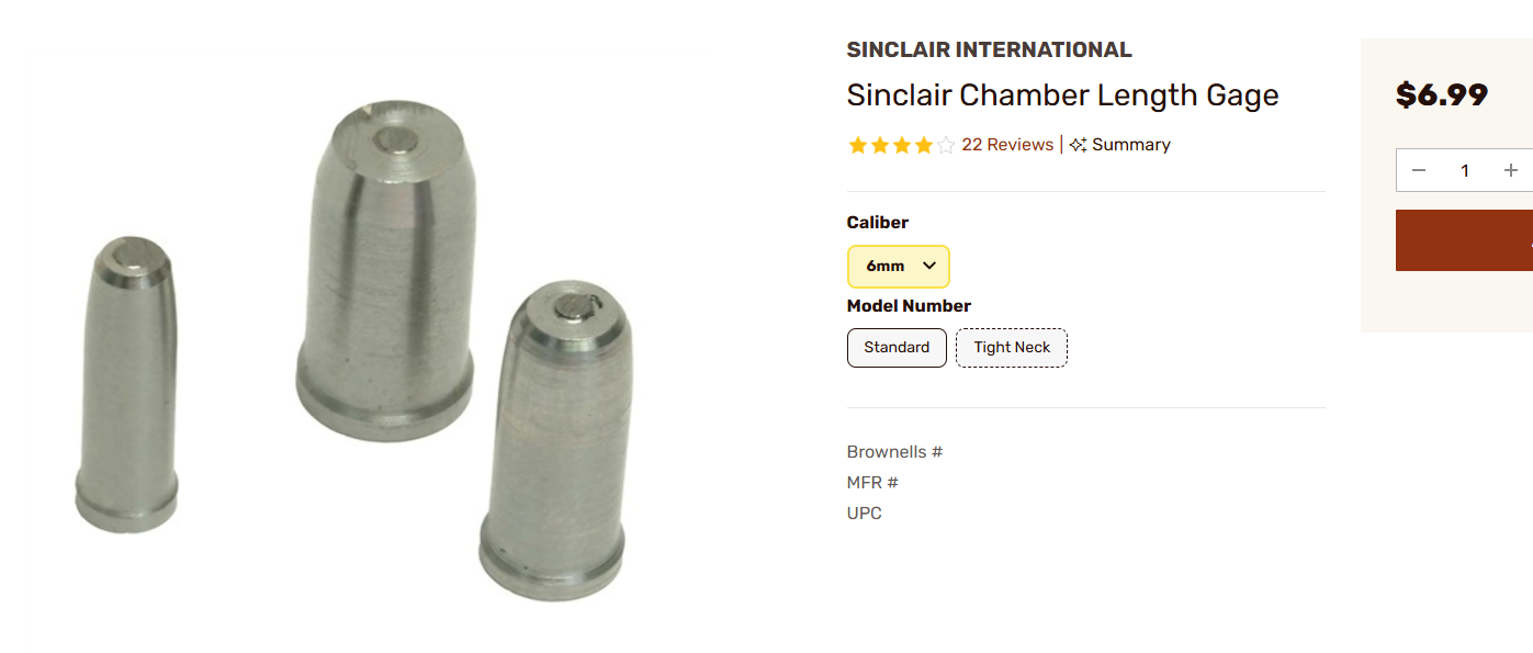

    If you don't know the reamer print, there are two easy ways to know the max case length without too much fuss.
    There is a case length tool that requires a piece of brass to be cut down, then the tool and that case are shoved into the chamber such that the chamber will move that tooling to the max length. You then set your max length and trim length from there.
    Another way, it to measure some of your cases and place them into the chamber while taking a look with your borescope. You can then see the approximate clearance to the case mouth and back into your trim length margin.
    The typical margin for a SAAMI chamber for 243 is 0.010", so for the 243 WIN the chamber length is 2.055 and the max case length is 2.045" with a tolerance of 2.045" - 2.025".
    You AI chamber reamer should be the same, but if your builder doesn't verify the print for you, then one of those tools or a look with your borescope will answer the issue.
